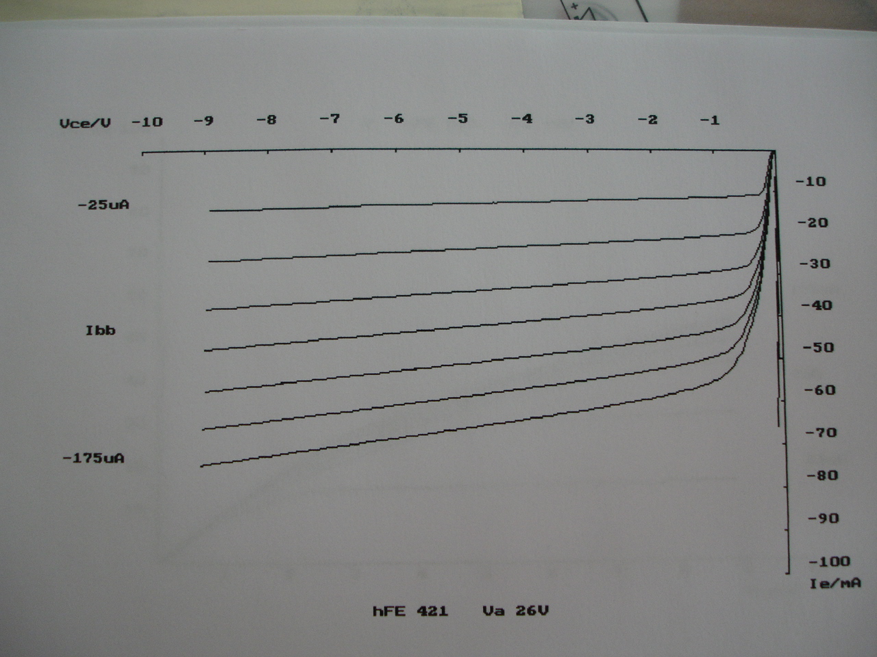

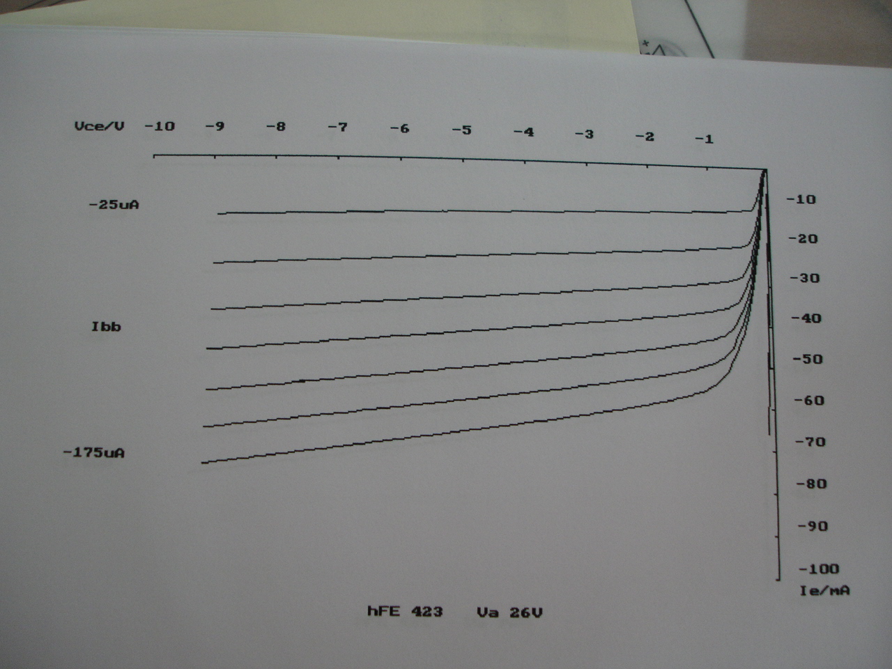

Dear Adrew thanks for interesting.
I manage to match transistors with a courve tracer published by elektor.
Hope i do this soon.

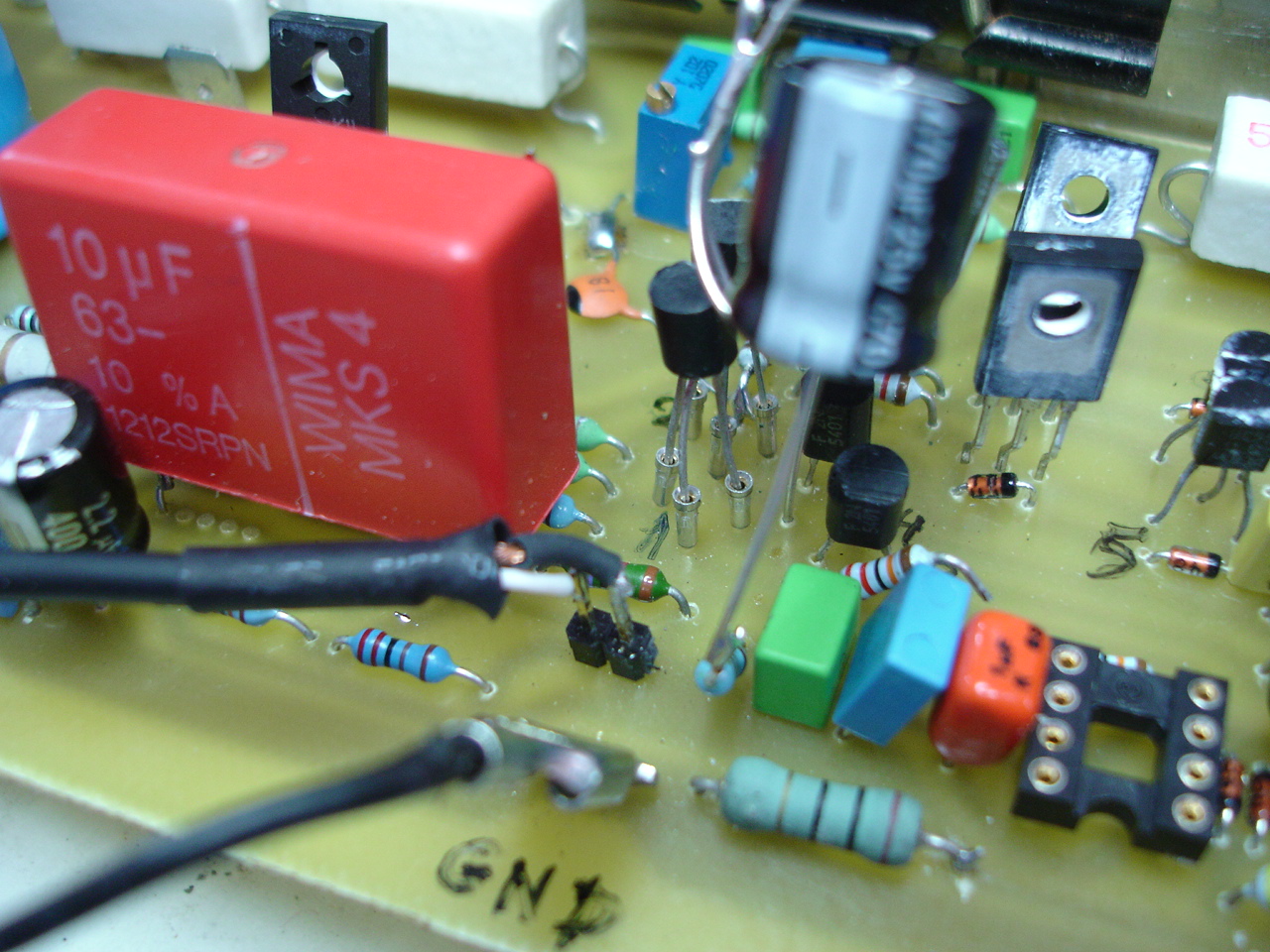

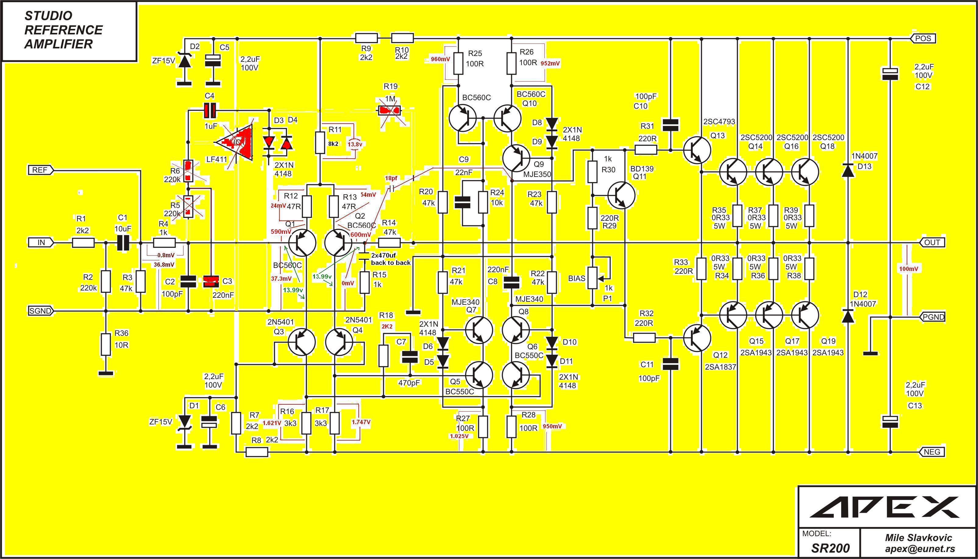

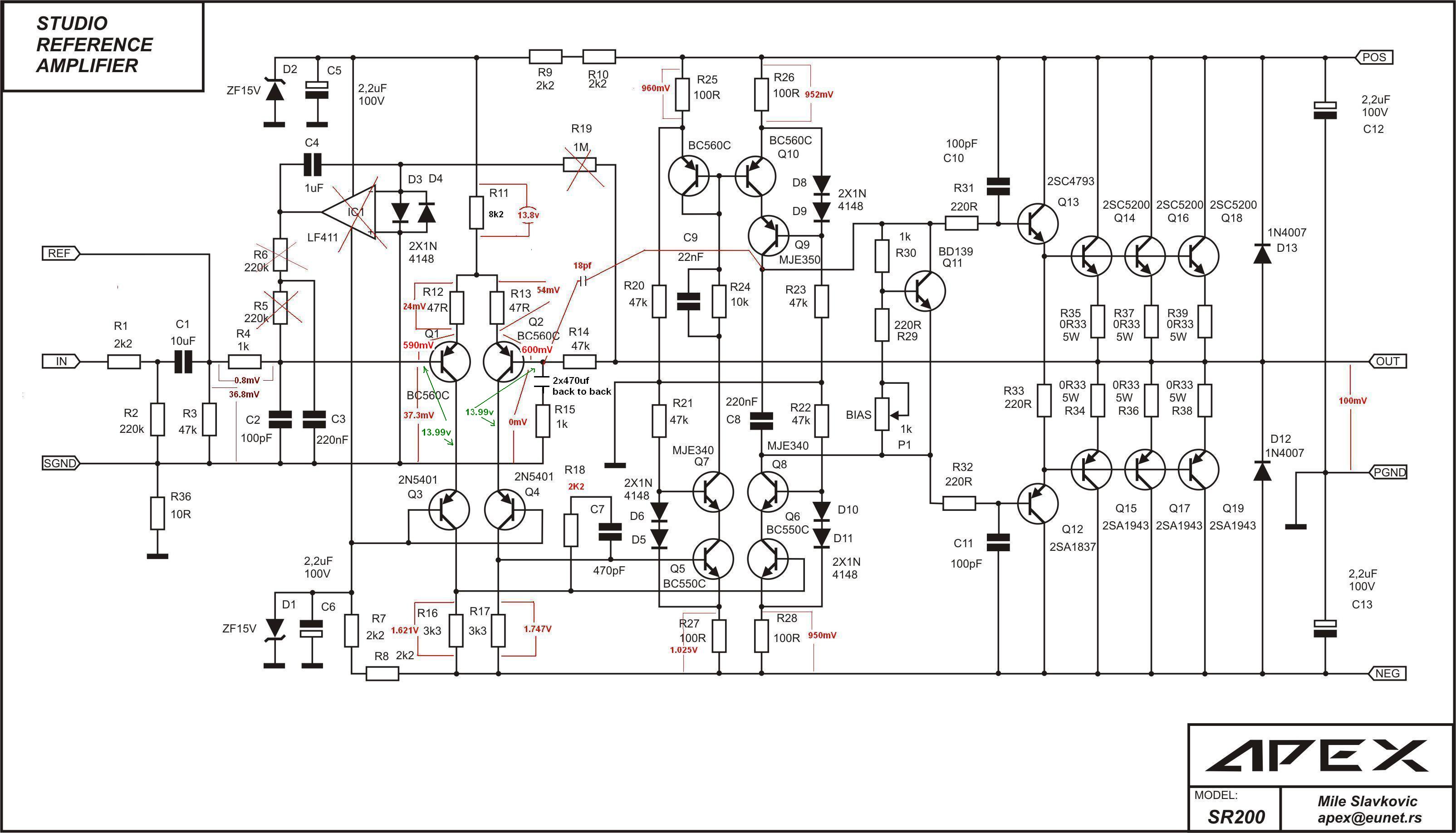

900uA and 25mA per resistor with 8k2 or 500uA and 10mA with 15k value of R11.
This morning i disconnected the servo from sr200 putting out lf411 R5 and R19.
In series with R15 connected two 470uf back to back.
Offset in this case is 100mV.
Q1 Q2 is matched pair as you can see on photos.
V on the R12 =24mV
V on the R13=54mV.
Any idea?
