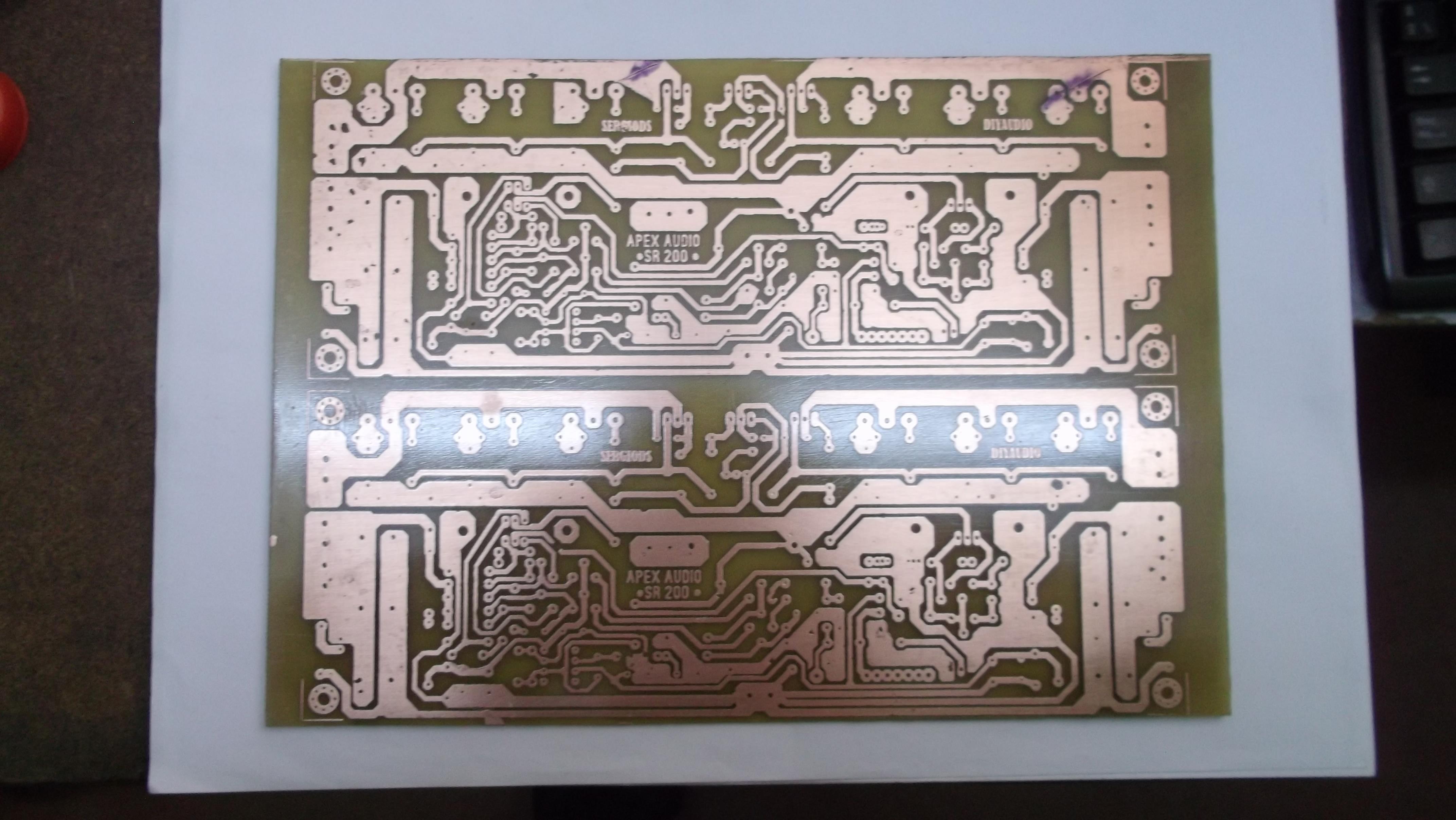

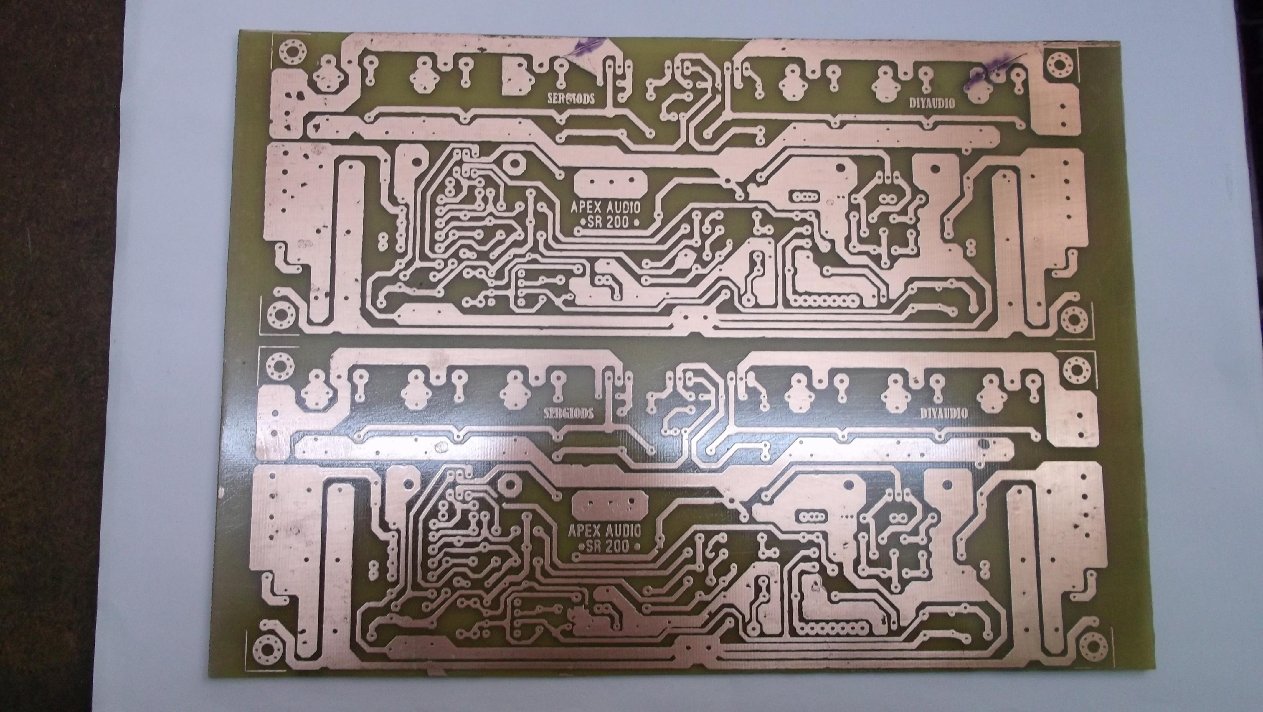

I upload the image there that Realise pcb.: D
...... to layout this rev.3.1 I spend days and hours from my free time , all the time I need Q.C and this is your contribution to find mistakes , errors and let me know and corect my PCB . I'm glad to help DiyAudio comunity with my skil ......
All the best ,Alex.

Very good...the first step:

Nice first step
