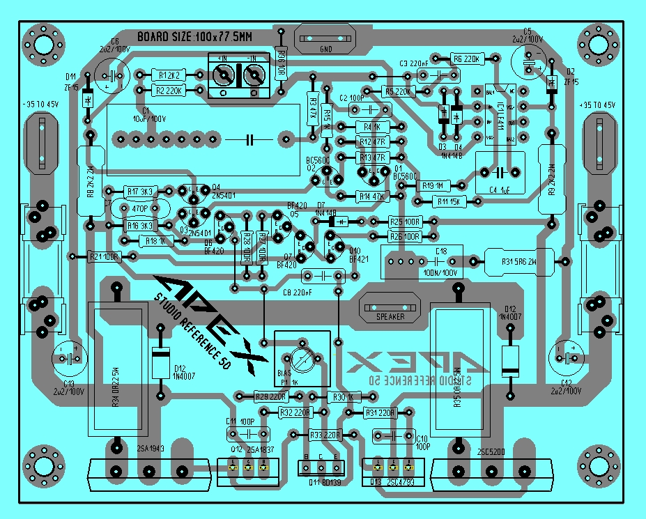

small mods to accomodate 10uF cap... very nice sounding little beast :D
  • SR50 Track.pdf
  • SR50 Parts.pdf

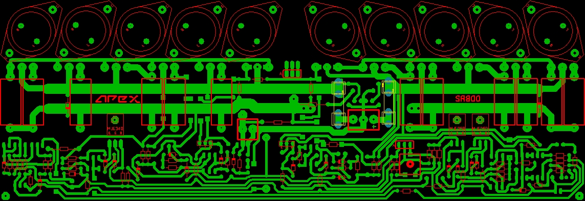

  • SR800.pdf

SR800 output stage circuit is triple emiter folower with MJE340/350 as predriver and drivers can be MJE15032/15033 (driver emiter resistor is 4R7/5W not 47R/5W).
For SR800 schematic use reverse engenering :)
