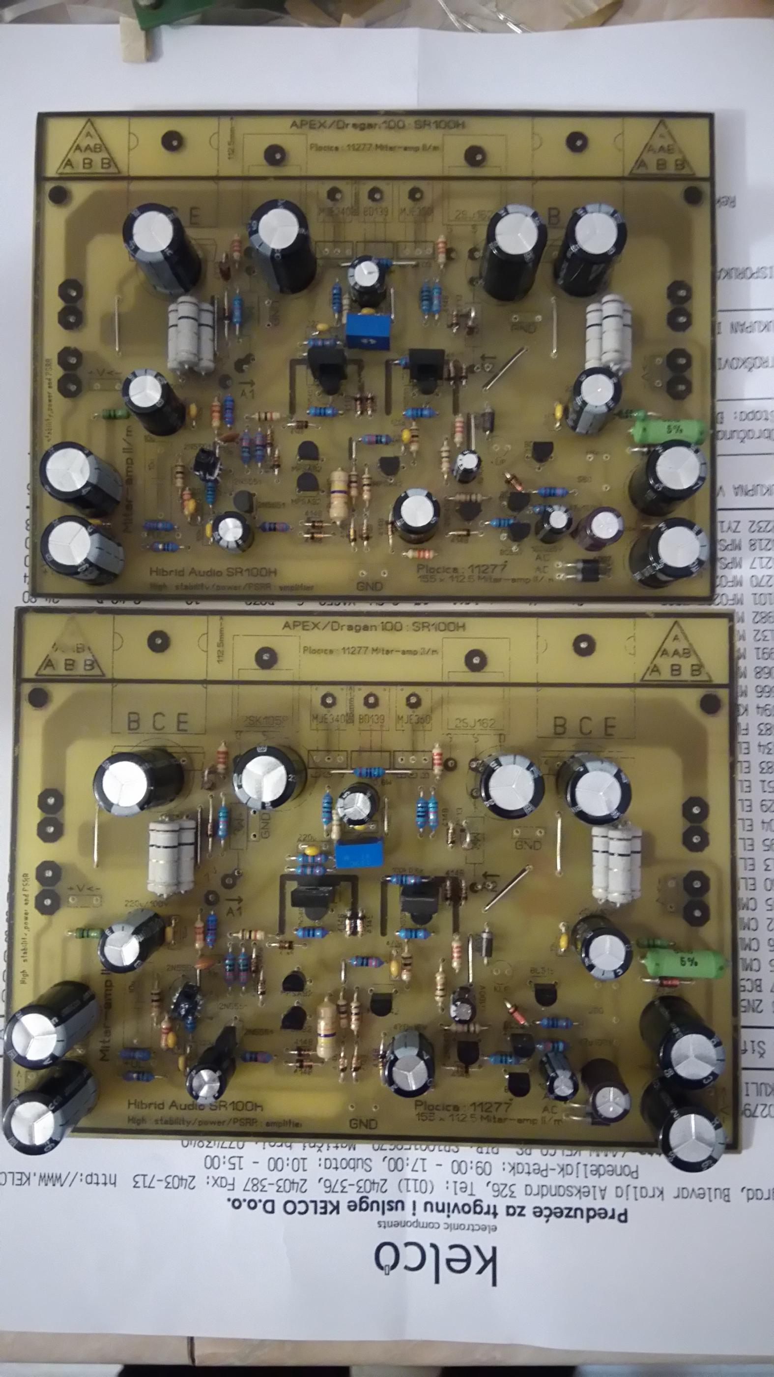

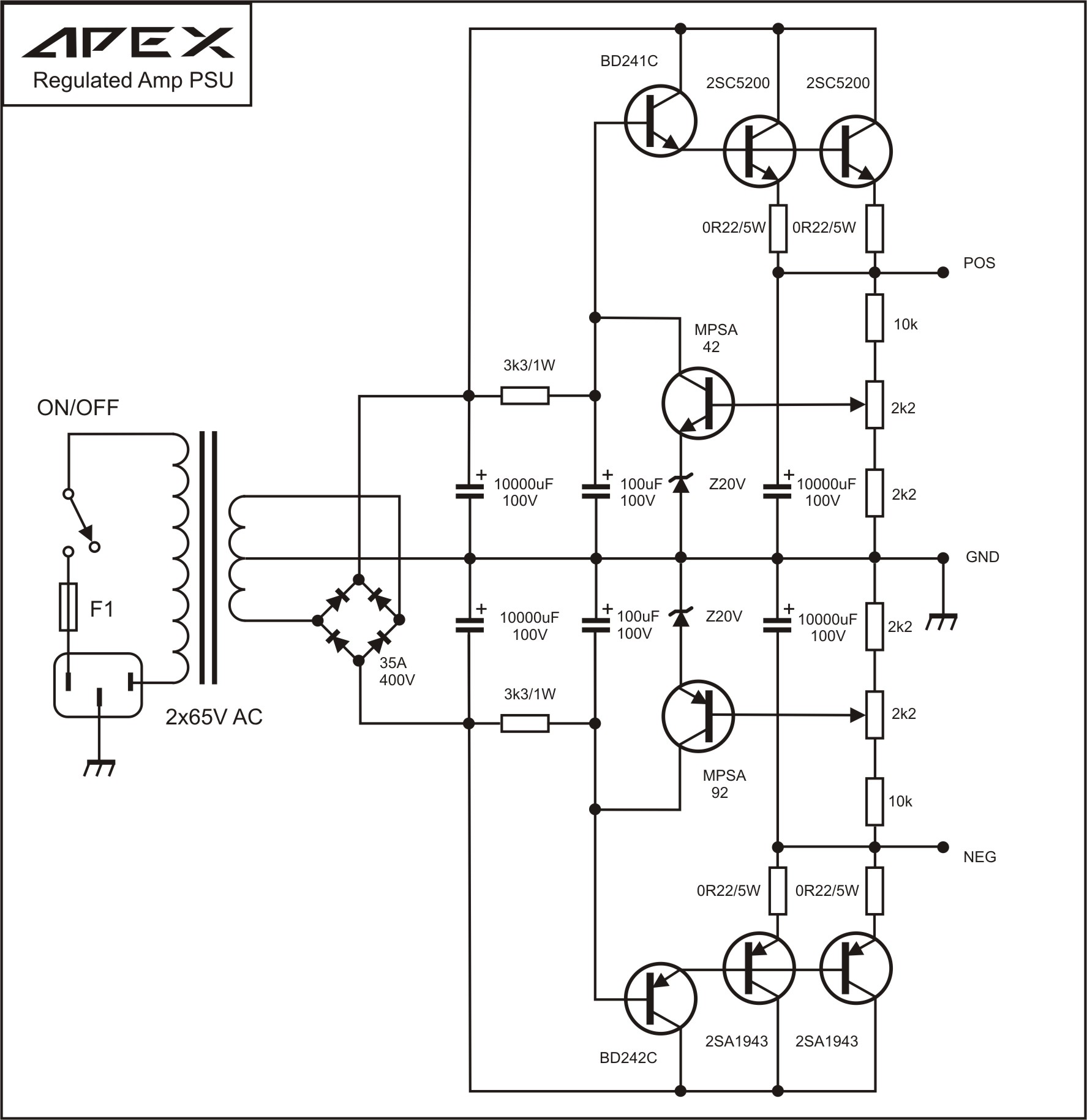

I'm building this PSU.
Can I use 0,33R emiter resistors instead of 0,22 and which replacements can be used for the BD240/242 combo?

First ,input two transistors must be paired . Minimum filter capacitors 20,000uF/63v needed per positiv and negativ rail .Voltage 55-0-55 for secondary transformer it's too big ,you need only 36-0-36 V ac or maximum 38-0-38Vac and 5 to 6 A. Use 25A rectifier bridges. :) .
Regards,Alex

Thanks U.
Sorry, I forgot to say that I 'm using ver 3.2 SR200 circuit pcb :p.
And I want to reach a maximum capacity of 200W / 8ohm per channel. :headbash:

Dear alex mm and everyone,
I 'm using version v3.2 SR200.
How much power of Zener 15V? (0.5wat ?)
How much volt transformer is maximum for pcb if i use power supply non regulator?
And volt minimum of Capicitor:
- 100pF
- 470pF
- 22nF
if i use +-75vdc?
Thanks!!! Sorry, my english is very bad :(.
