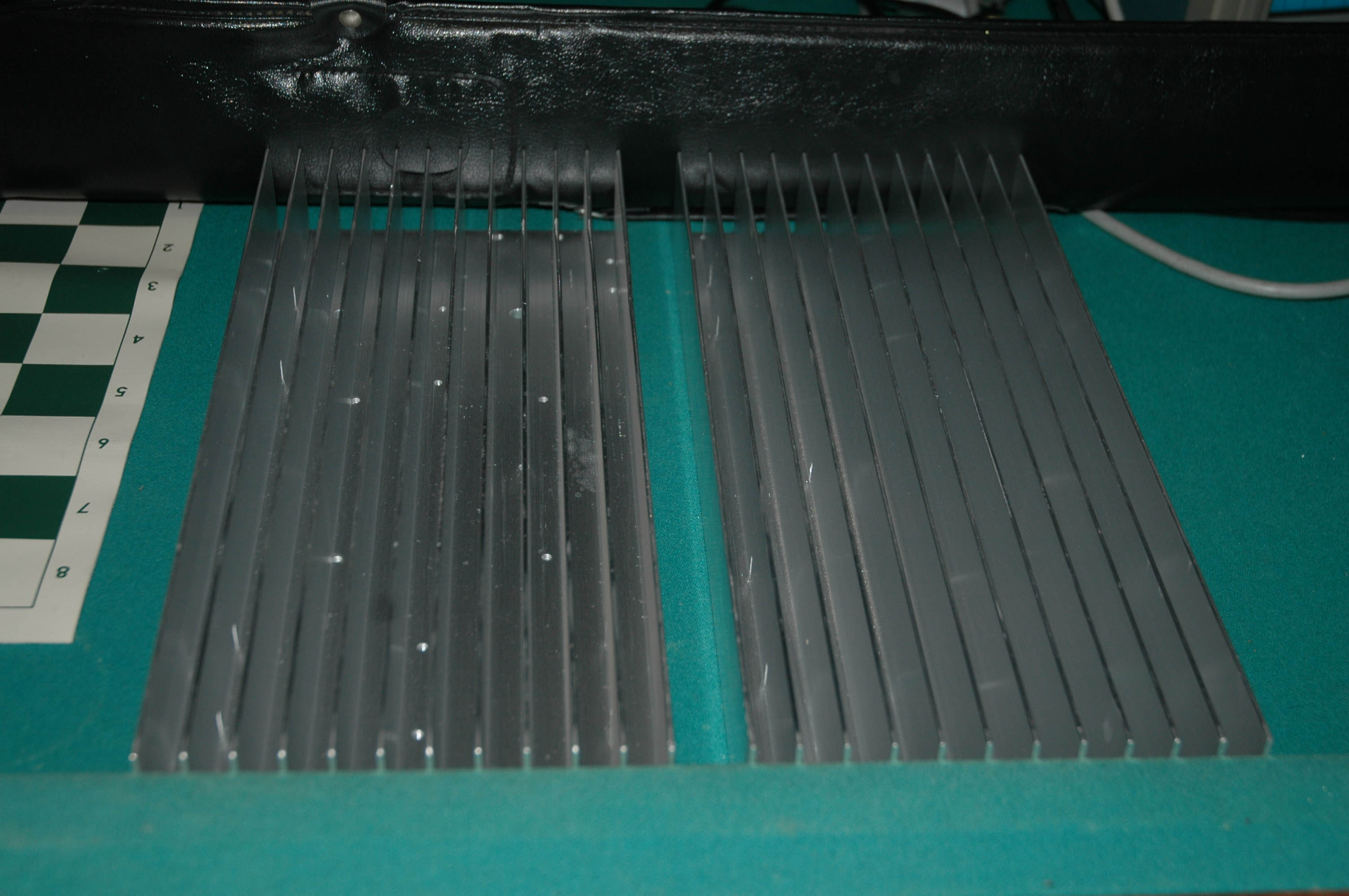

I have a table saw with carbide tip saw blade and as long as I feed it very, very and very slowly it cut beautifully. Anything else I used overheated the aluminum and it just puddled onto the teeth of the tool. I envy you guys for finding your fan type heat sinks. Damn!!!! And already TO-3 drilled. I have these hugh heat sinks where the fins run parallel lengthwise. 14 inches long, 6 inches wide and 2 inches deep. I was even thinking to cut across the fins to create spikes, put two together faces each other and place fan, push-pull at each each. I got these very cheap at a metal scrap yard. Kaplaars, I was wondering when you very going to run your tunnels verticle. As Superman says, "Up, up and away!"

I am thinking of cutting them through at about 18CM and place them upright. Does anybody has some experiencing with cutting aluminum profiles like these?

Kaplaars. I was very successful with cutting my aluminum sheets and bars up to 1 quarter inch .250. Like I said before, I used my table saw feeding it to the carbide tipped 10 inch saw blade. Even when I used my drill bench, the aluminum melted, but with the table saw, it sent very small chips out just like wood chips with no melting. You can cut one side, turn it over and cut the other side. If you have a table saw.

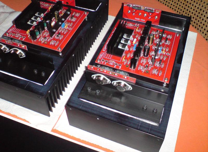

Hi Friends!
I've been thinking about the overhaul of my KSA when spring break arrives. Main upgrade will be adding other tunnel coolers, together with bigger (14cm) fans. Now, my cooling tunnels have nice pre-drilled holes for 32 TO-3 devices. I will use one tunnel and cut it in halve. This would mean I could double the amount of output devices if I want to. Just for curiosity, would this be beneficial?
A benefit which comes with doubling the amount of output devices will be that every TO-3 device has to dissipate halve of the heat it is dissipating right now. If I am correct the total heat generated will be the same, because overall bias is still the same, thus also heat generated. But chances of getting out of SOA will be smaller, because the individual devices have to do less work.
A disadvantage could be that when doubling the amount TO-3 devices, chances of instability will rise because of internal ifferences between the devices (deviation in bias per device). Probably using 1 ohm emitter resistors will help to tackle this problem. Another problem could be oscillation.
What is wisdom? Am I forgetting something ? I like the sound right now, and I have always learned 'don't fix if it aint broken', but maybe improvement could be made :).
Also I am curious about optimal orientation of the coolers themself. What would be the best orientation? Fans on top and pushing air through the tunnels down or reversed thus pulling the air through the tunnels instead. An other orientation could be placing the fans beneath and pushing air upright through the tunnel, or go for pulling the air through instead? And offcourse I can use the push / pull principle like I am using right now, so one fan on top, and one fan beneath.
Sorry for the overflood of questions, but I am very curious :).

I know I am just a novice, but is it possible to run a POT to adjust resistance in series with the 1 Ohm emitter resistor to adjust internal differences between devices? Sorry about answering a question with a question.
I've said this in the other thread, so I'll be brief:
The easiest way to ensure good matching between the output transistors current is to use the largest reasonable value resistors that are matched. I used resistors that were nominally 5%, but better than that in practice, and I measured the current for all 6 pairs of output transistors which were not matched, save by being from the same lot.
Getting resistors that match to 1% is cheap and easy, and if you really want to do better than 1% you can get there pretty easily by buying more and measuring them with a decent meter. However, shooting for better than 5% matching is going to be more or less pointless unless you also make sure all the pcb tracks and solder joints in line are also similarly matched. It is also rendered pointless unless you can keep the thermal tracking across the entire heatsink equally perfect. Why? a 1c differential in the temperature of the transistors will induce a ~3% difference in the Vbe, ie the hotter transistor will try and steal more current at about 3% per degree C, the larger the emitter resistor, the larger it's induced voltage to counteract the drop in Vbe.
An important thing to note: The more output transistors you put in parallel the larger the emitter resistors need to be: Adjust the value of the resistor so the overall paralleled emitter resistance matches the original design. "But why?" I hear you ask, well the value of the output paralleled emitter resistors determines the bias voltage to achieve a given emitter current but it also sets the bias in the driver stage, ie lower bias voltage to get the output stage into class A reduces the current in the driver stage...If either half of the driver stage runs out of current, it's partner is still working to drive the output but as a pair they are no longer in class A and the amp will not sound like a Krell amp, even if the output stage never leaves class A.
For 6 pairs of output transistors we used 2ohm resistors, whose parallel resistance matches the ksa50's 2 output pairs 0.66 pretty well.
Ok, that was not brief...sorry
Stuart

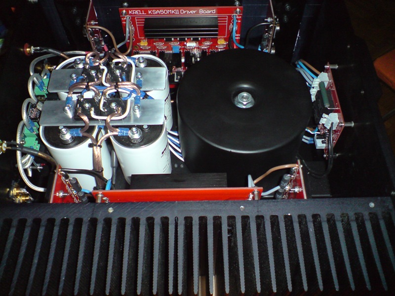

Well, I spent yesterday afternoon in listening and I must say that I'm impressed with the sound. Sound stage is huge. I think that the sound is even better than my first KSA50. Maybe, the reason is higher rail voltage. Bias is set at 325mV/0,5ohm. After two hours heatsinks are warm but not hot:)

@Stuart: Thanks for your reply! I've got nice info from an other DIY-audio member about matching resistors, so that would be certainly doable. I've got milspec 1 ohm 1% resistors already. There seems a negligible deviation in resistance between them, so that should be a good thing. That is exactly my problem in the current setup, there is a slight temperature deviation between the different trannies. Although bias seems to divide very nice (about 10 mV difference max between the devices) I think using my new tunnel coolers will tackle this problem even better. Another advantage is that my new configuration has no longer 'live heatsinks', all the TO-3's will be isolated. Disadvantage is that heat transfer to the tunnel cooler will be slightly less.
Also thanks for the explanation about the emitter resistors! How could I forget that. So if I want to upgrade, it is necessary to use resistors with higher resistance. Will consider that!
@Neychi: Good that you tackled the problem! But that would be not good news for me because we are probably using the same devices. Are you sure the problem has been caused by the Polida devices? I have not experienced any problems thus far with them. Drove the KSA with a dummy to the max a few times, but it stays rock solid. Maybe I am lucky, but for how long? Have to say, from the 10 sets I've bought, one of the devices was faulty and thrown away before soldering it to the boards. Maybe there was a device which was faulty already before testing the KSA?
Nice pictures by the way, I like your amp very much!!! :drool:
@Vdavidov:
The Amplimo transformers are dead quiet, I realy can't hear them, even when I am 5 cm from them. They are only audible now and then when I connect my laser printer to mains. I think my laserprinter adds a nice DC component on the net. This causes the Amplimo's to hum. But that would probably be the case for every toroid. Have to check my printer soon :rolleyes:

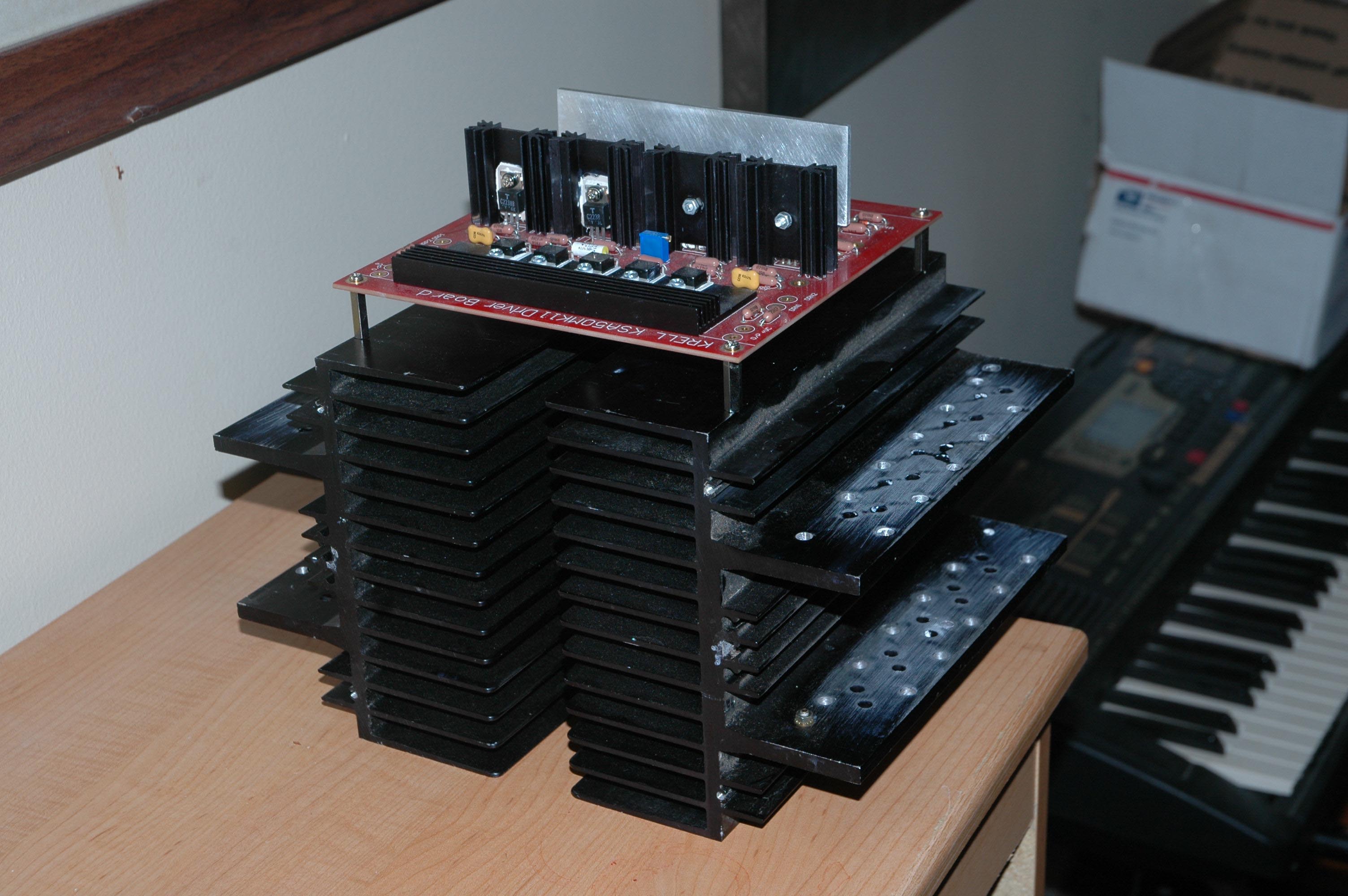

Well, with the help from Stuart Easson, I think I have the right heat sinks. They are from ADCOM, don't remember the model number. They are square and will have to deal with that later. There is room for five output trans. All I have to do now is get the right heat sinks for MJE15s. I have smaller fin blocks, but I would have to stand the MJE15s straight up rather than "laying down on the job." Hey, maybe they will have "verticle sex." Also known as "dancing."
