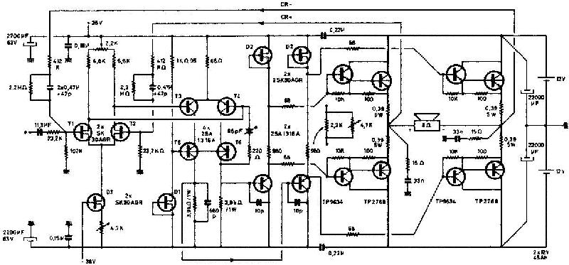

Robert, I actually meant the module which takes a single ended input and converts it into a set of two out-of-phase outputs, so that it can be fed into two amplifiers whose outputs are bridged. This module will be outside the amp (from the circuitry point of view, not physical location).
One common way to do this is by feeding the same signal into two opamps, one in inverting and one in non-inverting mode, and feed the output from the opamps into the two power amps. Anothe way is to use a single transistor set for unity gain and with equal emitter and collector resistors. I like this for simplicity and absolute ease of construction. I wanted to know if there were any cons to it.

A standard PP SS amp uses a time honored design which is tricky to set up as an inverting input, thus making bridge connection difficult. It can certainly be done, but it is difficult to ensure the same S/N ratio without seriously setting up dissimilar input impedances. The reason is that the input on an inverting amp is resistively coupled to a virtual earth, and thus the input resistor becomes the Zin of the amp. Since this resistor with the feedback resistor determines the gain, you finish with a large value feedback resistor or a low value, low Zin, input resistor.
So, a phase splitter is needed.
You can do this with an input transformer such as the Jensen or Lundahl, and this works well but is expensive.
You can also use a single ended phase splitter; a bipolar transistor with equal size emitter and collector resistors.
This approach works very well, but requires a voltage drop across the load resistors which is at least ten times the input range swing. So, if you are dealing with line level inputs, which go to about 1.5Vp, you need at least 15 volts and preferably more across the collector resistor, and rather more again across the emitter resistor. Let's pick around 23V across the emitter resistor.
You also need to ensure that the output impedance of this PS is around ten times lower than the input impedance of the following amplifier; so, for a 47K power amp, you need a Zout of 4K7 AT LEAST at the collector of your phase splitter resistor.
This mandates a collector resistor of this value or lower, since this value fixes the Zout.
So, let's pick a negative supply of -24V, and agree to use a NPN small signal device with a beta of 100.
We will run 2.24mA, a reasonable figure. The emitter resistor will thus calculate to (24 - 0.6 - Vbias) = 22.4/2.25. This gives us 10K, and mandates an identical 10K collector resistor for perfect 1:1 gain.
We want about half the postive rail voltage across the transistor collector/emitter, and the same across the collector resistor.
So if the 10K collector resistor drops 23V, then the transistor needs to drop about the same, and since the emitter is within 0.6V of ground (we use a + and - power supply), the 10K resistor should be connector to a positive supply of around 45 volts, and for sonic accuracy, it had better be regulated and clean! The negative supply does not require strict regulation because it's like-phase output comes of the emitter and is thus dominated by base noise.
There is the difficult; an asymmetrical power supply of +45 and -24 volts. This is the primary reason people use opamps. The other reason is signal coupling; both outputs of the phase splitter require capacitive coupling; but this is NOT a problem in this scenario because both power amps have blocking caps on the input anyway!
This design would work very well and deliver only second harmonic and a small amount of third harmonic distortion. Being single ended, there is no crossover disjunction, and it would be very quiet as well. There is no sonic penalty; only sonic benefits?!

Thank you for taking time out to write to me. Have a cold one, on me. Speaking of cold, It's about 11 degrees in Calcutta right now, but it's only a few months more to summer. I shudder at what you must be going through, take care the hard drives don't melt in that heat. And I mean it about the beer.
That was a great reply. Everything I need.
Yes, 45 volts is not feasible as the amp is operating off a 35 volt rail, and I'm in no mood to add a voltage doubler. Opamp seems the way to go, if at all. I will breadboard first and ask more Qs later.
But I'm printing this out for my reference. I plan on a fully discrete DIY bridge amp using only discretes, where I can plan on such a schema, I can probably pick a design with a higher rail so I can have decent headroom for regulation and run a discrete splitter.
I have one nagging question, though. If the preamp should be able to feed low input impedances (it was designed to feed upto 600 ohm outputs, but I may be wrong), in which case would you recommend to try connecting the preamp output to the + input on one amp and the - input on the other? Both have exactly the same layout as of now apart from the fact that one amp is slaved to the other.
Thank you again.
Sangram
discrete bridge amp
have a look
rljones and aksa
hi there,
as you own the rowland 10 stereo poweramp, you should be able to locate the phase splitter device.
i don't think they use a standard opamp - but the DRV-134 line driver ....?????? (or a similar device)
btw i'm in the process of building a couple of monoblocks with the lm3886, 4 + 4 balanced.....and still thinkin' about the "input-modul"....
