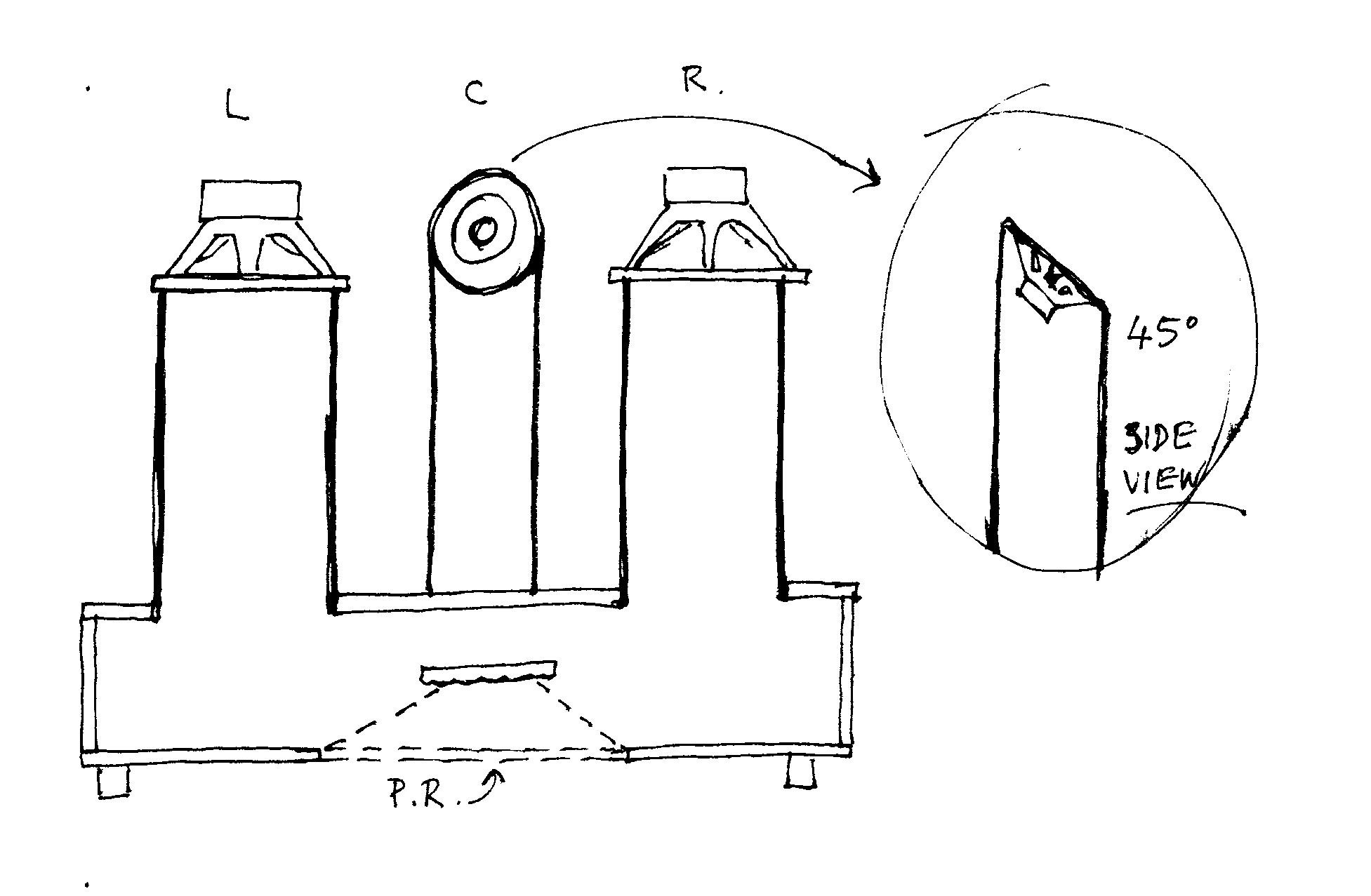

More comparative listening sessions have revealed something more:
My 'inverted driver' pair in the conventional stereo triangle configuration sounds very 'spacious' and images well and is tolerant of listener position, with very good localization possible even when sitting near one speaker-- probably the omni nature of the driver radiation is the reason.
Planning some more listening to the stereo triangle with a couple of added tweeters facing up and spherical reflectors on top, and then compare with the SSS.
Getting slightly confused, to admit the truth... :-(

@ LineArray,
Thanks for the comments which have given me more 'food for thought' and experimentation.
For the SSS connection, the L-R separation was about 21 cm, with the L-R pvc pipes feeding the same shallow box. No, I havent yet put in the passive radiator as I thought that could wait. Actually I had been playing with the inverted drivers ever since I read about the Ohm speakers long back. But I came back to them around the time when I was fabricating my OBs. I can't prove it, but I have always had a feeling that the inverted drivers had a "different sound" than when they were conventionally baffle mounted. A major improvement was because of the lessening of the (large conventional) baffle vibrations as a result of the speaker being mounted onto a tall, narrow 'tube', whether of pvc piping or wood. Surely the masking by the magnet and frame structure and the lack of highs etc were there, but the omni sort of radiation was doing something good to the stereo imaging, I had felt.
It was easy to have a comparison between the SSS ( a la Elias) and the stereo triangle with identical drivers and mounts. For the stereo triangle, the L-R separation was more like 6 feet (my 'studio' being all of 12 feet in width, with an open slatted wall at one end, and 'broken' (not continuous) side walls on one side). With the SSS, an image skew was noticeable, though the addition of the 'steering filter' did make a difference. As soon as I was able to fire up the stereo triangle, I was 'shocked' to discover that though I was nearer to one speaker, still the spaciousness and clarity of the image was audible clearly. Replacing the jury-rigged inverted drivers with my Infinity bookshelves just changed the FR, with better highs and solid lows, but the imaging was clear only at a critical spot, and it did SOUND very much different...a bit worse, according to me! Switching back to the inverted pair gave me overall satisfaction with a variety of music (though the FR left a lot to be desired) with more 'natural sounding' voices and instruments.
The SSS, in my case, needed some lowering of the centre speaker level before the whole thing 'clicked' into place. The 'steering filter' also needs some tweaking, I guess, though I have not much idea how to go about it.
So the next logical step is to effect a low-pass well within the capability of the inverted drivers, stick a couple of 'sky-facing' tweeters onto the magnets and mount a couple of spherical ( a friend has promised a couple of stainless-steel hollow balls) reflectors on top so that there is some omni hf radiation. I have a feeling they are going to sound rather satisfactory as regards imaging and also the banishment of the sweet spot. A shorter 'pipe' and shallow box with a PR each should take care of tuning out the low-end resonances etc. It is a funny thought, but it is possible to do the whole 'plumbing' with pvc piping, a 5-6 feet long piece joining the two L-R uprights and mount one or two floor-facing passive radiators in suitable pipe couplers. Linkwitz has done it, so ... ??? (not the plumbing, but great sound with simple plumbing!)
In all honesty I must say that I have combined many approaches rather accidentally, and not consciously!!
My M-S is getting bogged down in the midst of all this ... :-(
Big thanks to all again!
-- UKP
As far as I understand, your SSS is actually three omnis placed very close to each others ? And because of (horisontal) omni radiation pattern up to the highest freqs too, there is no 'baffle shadow' to help the high freq image steering. The idea in my SSS is at high freqs the dominant radiation is steered towards the panned side according to the stereo signal. If using just omnis, you'll lose that property.
Other than that the inverted driver omni method looks interesting, and it may well be used in an conventional stereo triangle as any other 'omni'.
Something like this (the tweeter may vary):
And if making the bottock of the driver visible, maybe could use some of the 'pretty' drivers:

one idea: add front horn for Center driver:
- you can probably than physically time align it with L-R drivers
- having center more directive - seems to offer better imaging, while L-R will create a space by reflected sound.
Also, did some one try to direct L-R not at 90 degree to the center driver axis, but at 45 degree, to get more HF reflections from side walls and less early reflections from back wall?
@Elias: I agree with your points, but at the same time would like to point out that they are not absolute omnis, nor is the HF response that good; the centre speaker has greater level of HF and so in my case wanted some level adjustment (cut) before things were satisfactory. The omni 'mixup' did occur to me and I stuck a couple of thin board + 2" absorber of jute fibre (IMO far better than synthetic fibre wads) in the middle on both sides of the centre speaker and that improved things a lot.
One good thing I noticed with the SSS was that even with the 'skew', the image remained stable when the listener shifted position, unless of course, one moved too close to the speakers. Aurally the sound is more 'spacious and pleasing' with the inverted drivers, and the conventional stereo triangle is quite forgiving as regards listener position with the inverted drivers.
@Charcoal: My centre driver is at 45 degrees and I guess it is 'mellower' than one 'firing to your face'. In another post earlier I remember seeing the L-R speakers at about 45 degrees instead of at 90 degrees. Must try with the box with the connection suggested by Elias. As of now, my inverted drivers are taking care of more than 180 degrees on both sides, I guess, though with limited HF. Must rig up those tweeter+sphere combos soon ...
Greets to all!
. . . did some one try to direct L-R not at 90 degree to the center driver axis, but at 45 degree, to get more HF reflections from side walls and less early reflections from back wall?
Yes, but the ones I've seen were not using the SSS matrix. I'd wager that it's a sizeable step backwards. Instead of enjoying increased sidewall reflections, you'll just detect more direct L-R signal from the center (the Precedence Effect). For SSS to work as intended, the listener should only register a direct signal from the middle speaker.
Depending on driver directivity, etc, the soundstage would compress toward a "spacious mono" presentation - Nice ambiance, but narrower spread and poor panning of images.
Re: Those backwall reflections. The important thing is that the Center speaker isn't as affected by the wall behind it, unless the design calls for it (up-firing, omni, or dipole center).
If one experiences L-R trouble from the backwall, place the unit against the wall and early reflections are essentially eliminated, or address the issue just as we need to with regular 2-ch triangle: absorption on wall at the first reflection points, or increase directivity, or move the speaker farther from said wall &/or add diffusion.
An all-on-wall setup would be ideal in many respects. If one wants a more targeted sidewall reflection, simply add large flat reflective panels across the front corners angled to taste; even use the "mirror trick" to direct the L-R first reflections right to your listening position (not a good idea for larger rooms, as the delay grows too obvious without some decorrelation).
