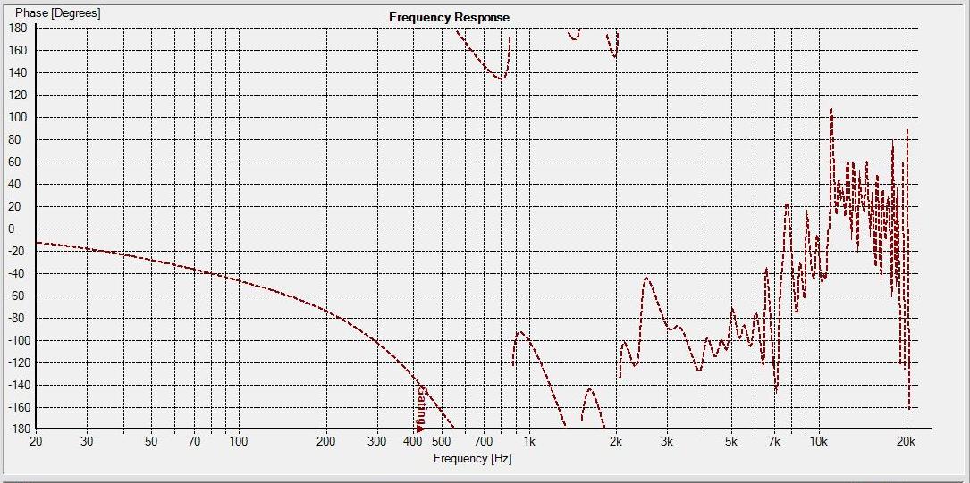

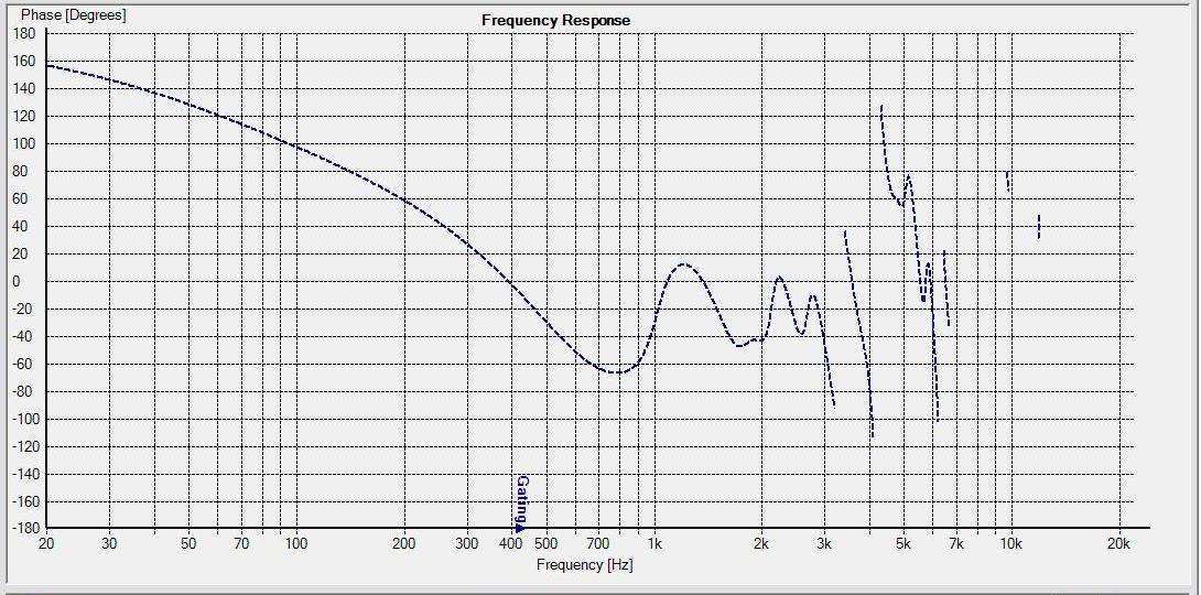

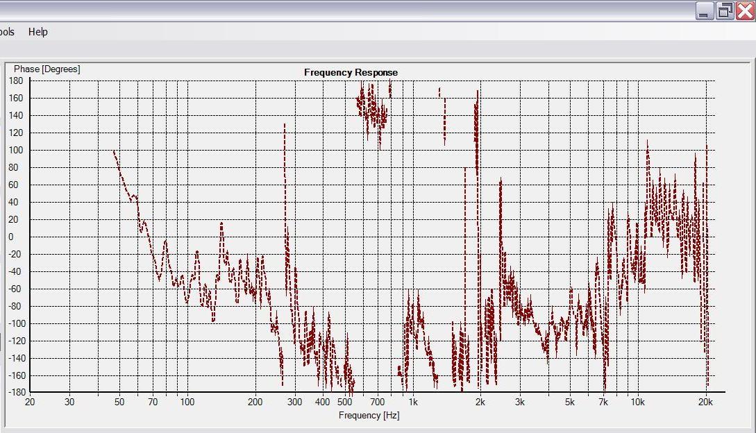

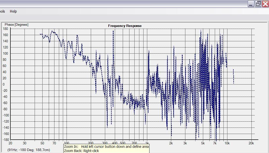

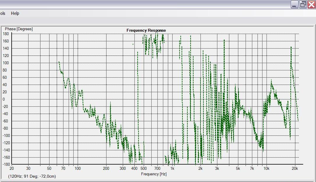

These raw phase plots (ungated) are from measurements i took about 2 years ago.
3 very different speakers in the same room, mic distance about 1m+ , but positions
of speakers are NOT the same, though comparable (no close side walls,
>1m distance from front wall ...)
"bwl" is an early "ancestor" of current "Model 2" bending wave loudspeaker
"d8" is "dipol08" line array
"rib" is a bookshelf speaker on a stand, having an isodynamic ("ribbon like") tweeter with XO somewhat below 1Khz
The upper cuttof of that early BWL was about 8Khz, so the phase plot is truncated
at the upper end when compared to the other speakers.
The bwl shows an increasing phase decorrelation >1Khz. The other speakers do not show this
behaviour consequently when looking at >2Khz.
Of course here we have all mixed up: Phase decorrelation from the speaker itself plus room effects,
also arising from different directivity of the speakers.
Nevertheless the isodynamic tweeter of the bookshelf speaker is very wide radiating in the horizontal
plane, because its membrane is only about 10mm wide X 120mm in height, no waveguide or protruding
edges on the baffle ... In comparison Dipol 08 is the most directional design of the three.

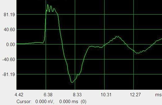

Is it able to reproduce an arbitrary high frequency waveform, or just an energy envelope with some time-freq resolution ?
- Elias

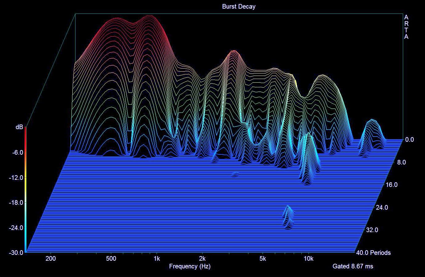

Pics below are not current "state of the art" and naturally a step response
e.g. looks a bit different depending on angle, but it produces waveforms
quite well.
In the current model i already approached that ringing around 5Khz and it
also has "fullrange response" to the upper end now.
It will take some weeks until there are new measurements, as i am
building a new listening room right now before christmas.

As i said the phase plots above are "wet" plots, ungated.
They should only serve to show "inroom" behaviour of
(very) different speakers due to phase.
The step is nearfield about 50cm mic distance, the CSD
was with speaker standing on a carpeted bottom, mic distance ca. 1m.

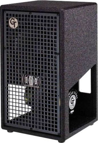

I'll post this just for fun !
Single speaker stereo is not only suitable for home, but it is used in PA as well.
Groove Tubes SFX:
attachment.php
As functioning as a MS speaker, I could imagine the monopole gets the L+R and the dipole gets L-R, forming a radiation pattern of two sideways cardioids for stereo signals L and R. Looking at the dimensions it should work in the intended manner at least up to midrange.
More info:
http://www.groovetubes.com/assets/1650_SFX%20Op%20Manual%20-%208.5x11%20page.pdf
Another bigger one: Groove Tubes K5 SFX Stereo Decoder Speaker
attachment.php
Direct firing 15" coaxial monopole and two 12" in face-to-face dipole for spatial symmetry.
Interesting :D
- Elias

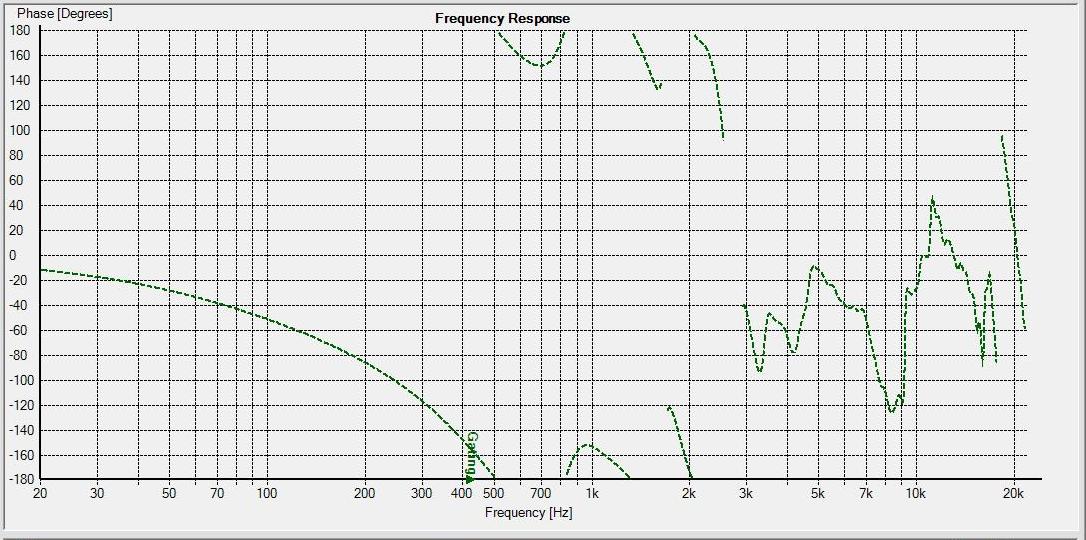

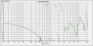

That effective "inroom phase randomness" is due to a room AND the spatial
phase pattern the speaker exhibits. From the phase plot you cannot
recognize how the pattern changes with angle ... in fact it changes with
very very small angles towards higher frequencies but keeps up the "gross
statistical shape".
The narrow ribbon tweeter e.g. has wide dispersion but does not produce the same
"inroom decorrelation", neither would a dome tweeter be able to do that.
Below some gated versions. As before the bwl's phase changes in a more narrow
banded manner and also more and more excessively towards higher frequencies at
a certain point in space.
That is the input for the room to "do the rest" (of diffusion, like it does always) and
establish a resulting pattern which is very appropriate IMO due to our
"speaker localization vs. phantom imageing" problem. That problem largely has to do
with interchannel (left/right interspeaker) interference.
If you smooth the ungated phase plots, you will see that the average phase is quite
stable compared to the other speakers and also the bw loudspeaker has very flat
group delay.

decorrelated sources in the first place. The difference is in the specific technical difficulties to be tackled.
In the reflection case: Ho to get reflected sound "dominant" over the portion reaching the listener directly or how to time align direct
and reflected components.
In case of BWL: At what frequency the decorrelation on spatial level should start and how fine the lobing should get
depending on frequency.
The real question is: Is BWL able to decorrelate phase in spatial domain without room reflections in such amount that when listened at 2 m distance a 1 cm lateral shift will provide required level of decorrelation ?
- Elias
So i find it hard to give exact measures for a "spatial decorrelation profile", because all this is a gradual thing.
My first goal in designing bwl was to modify (mitigate) audible (and detrimental non diffuse) speaker-room interaction.
And yes, the increased diffusivity in first room reflections, may even be the predominantly audible
effect more than "direct spatial decorrelation" given by the lobed radiation pattern of the transducer.
This is why i would like to measure the quality of center images, even for listening positions outside the
median plane.
