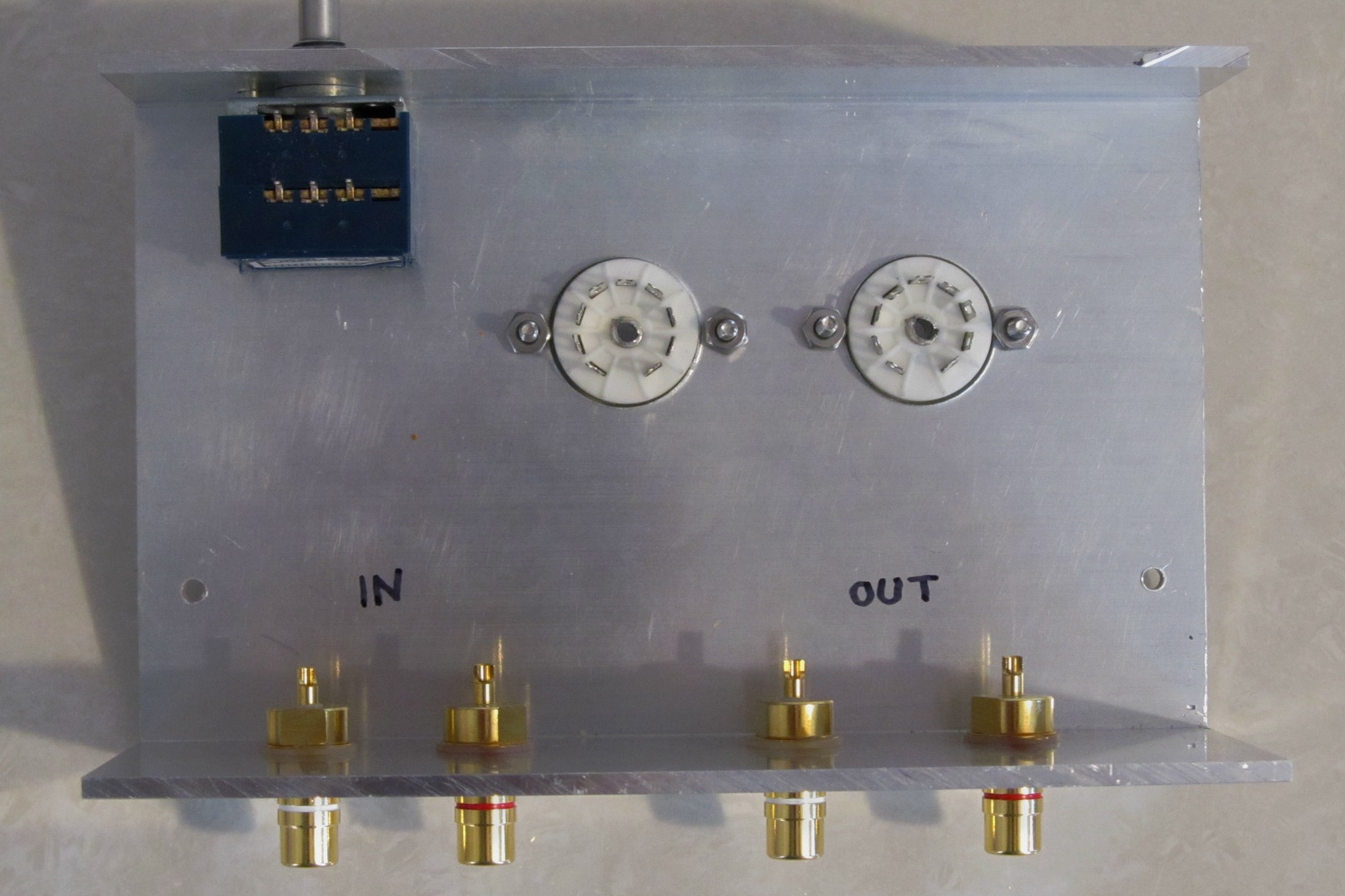

The issue of how to run Star Grounding for the audio ground comes up.
If you look at the photo, I was thinking of using the shields from the input RCA's,
as the star ground node.
Both input shields would be connected together to form the audio ground node.
So the power supply ground, tube amp ground, output RCA ground (shields)
would all be connected together at that point.
Hopefully this is correct.

To add, I made the case by cutting a spare piece of 4 x 4 x 0.100" Architectural aluminum.
The inputs were kept away from the outputs.
Drilling the 0.850" holes for the tube sockets was a @#&% !

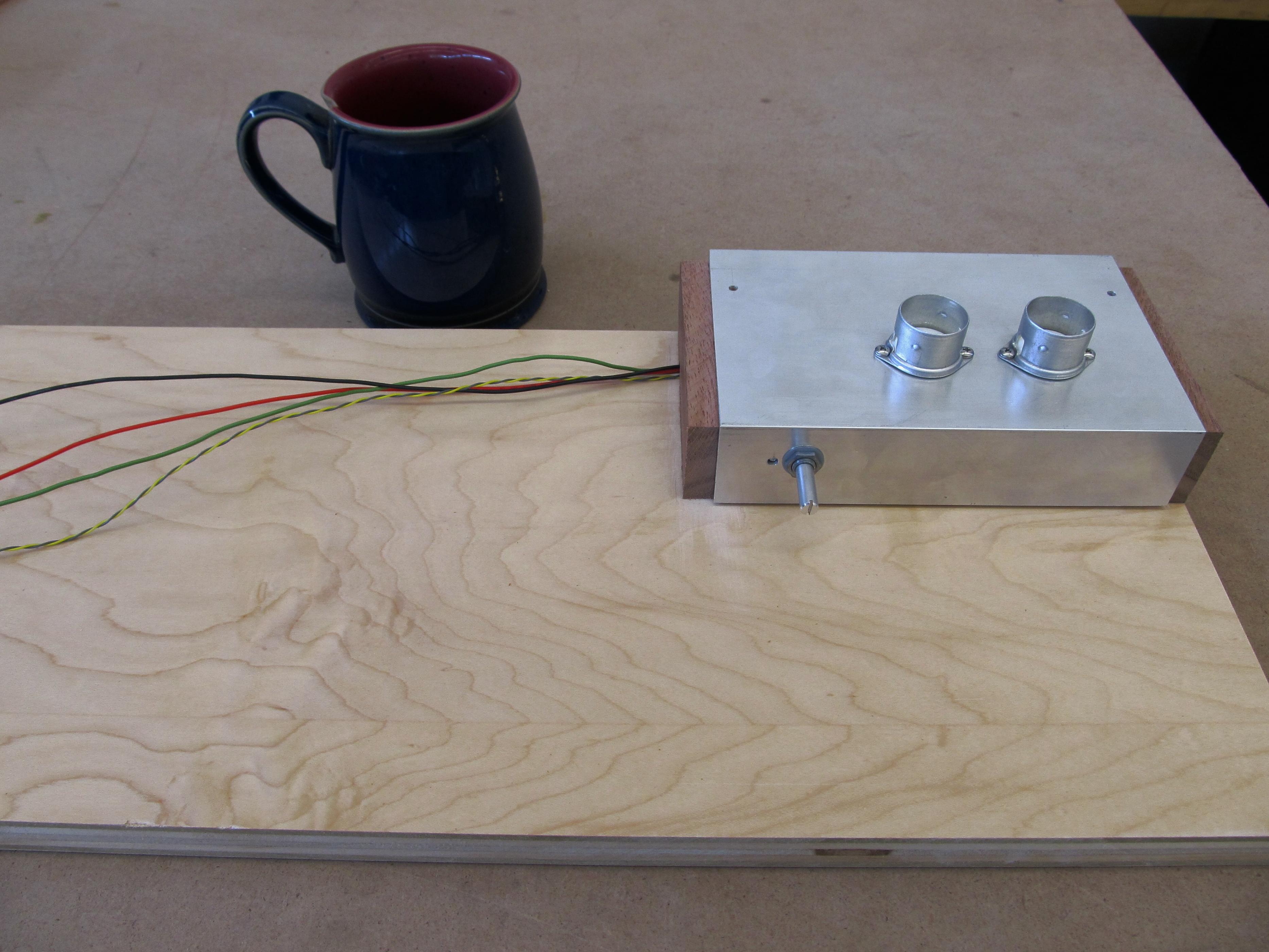

The circuitry for the amp will be inside a shielded box
and the power supply will be on the outside of the box sitting on the plywood.
I think it would be best to have the audio star ground node inside the shielded box.

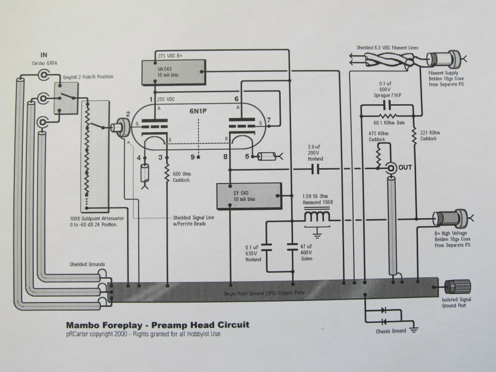

how about at the -Ve of the bypass capacitor that is connected between B+ and the -Ve ?
Looking at the schematic of the Mambo Amp - it implies a similar set up - power comes from outside the circuitry area.
But of course, the Mambo uses a Copper plate for the audio ground node.
Note too, the DC path between the one heater wire and audio ground.
In this case, the 68K and 221K form a voltage divider to lift the heater voltage.

Rather than buying a case, I had this small piece of 4 x 4 x 0.100" architectural aluminum kicking around.
I thought it would be good because it would keep current loops quite small.
Especially - there wouldn't be a long wire from the input RCA's in the back
to the volume control at the front, and then another long wire from the volume control to the grid resistor.

If all the circuitry is the in the same box, typically there is a shield plate between the power supply area and circuit areas.
Wires passing through or near the edges of a metal plate without a grommet to protect them, is not good either.

I did this to keep wire lengths short in the circuit area.
Even though this is just in the audio frequency range, its probably not a good idea
to have long wire lengths transmitting to each other.
Also, in a small box like this P to P wiring can be done.
Also, note how I kept the inputs well away from the outputs.
The last I wanted was some oscillation ("singing") occurring.
You'll see RF guys building circuits in small boxes made of FR-4.
But of course this is done to shield the circuit from RF signals and EMI.
The wiring is P to P and the power supply is on the outside.

I'd forgot that you had planned to earth the chassis. So you'll want to isolate the star from the chassis and use a ground loop breaker. Or use a length of solid copper wire, 14ga or 12ga perhaps, as a ground bus. the end of the power supply filtering network should connect to ground at one end of that bus.
For a ground breaker, create a circuit of two 1n4007 in series from signal ground to earth, paralleled with another pair from earth to signal ground, paralleled with a small capacitor and a resistor in series.

But there is, right under your nose Check the Articles section here to find a wonderfully comprehensive article on Grounding by David Davenport. I printed it off years ago and use it as a reference.
Also find in the archives a thread about Thorsten Loesch's DIY phono design as built by Kofi Anan. Thorsten gives step by step instructions suitable for a beginner.
Another option would be an isolated chassis-mount turret, like this:
Insulated Green Diallyl Star Ground Turret Terminal 4 40 Thread Chassis Mount | eBay
But really. The key to good grounding is going to be the power supply, not the input jack.

That is not the way to twist a pair of wires. But it is quick and wrong !AC heaters really are OK if you twist the wires (I use a power drill and a pair of pliers for that).........
Use your hands to twist the wires and allow the individual cores to rotate in the opposite direction to your twisting direction.
It is this contra-rotating turn of the cores that allows the twisted pair to form correctly.
I usually use a door knob to anchor the fixed end, but a bench mounted vice would do a better job.
