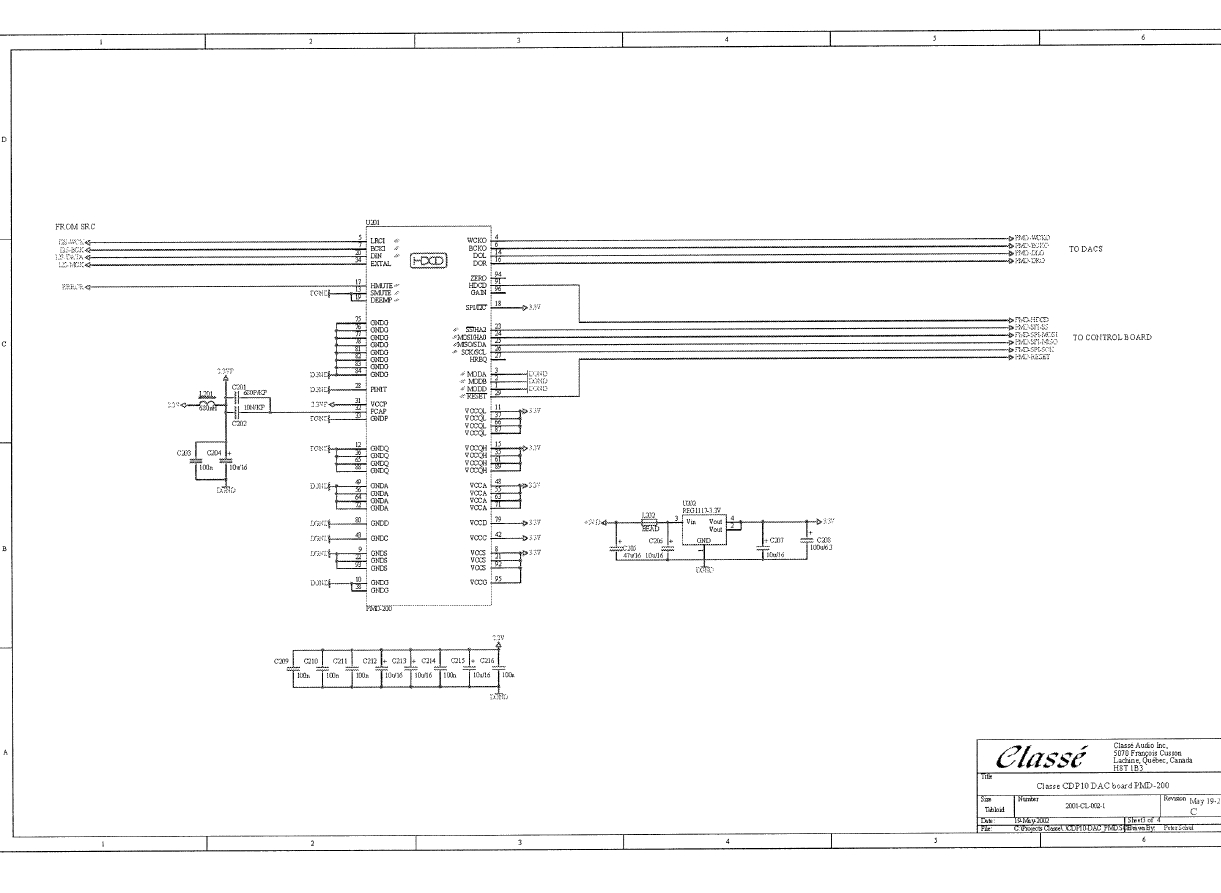

Switching off HDCD processing
You guys are well versed in the HDCD chip, I have a question I have a Classe CDP10 which has the HDCD PDM200 chip in it I also have the the circuit diagram for it, would it be possiible maybe with a switch on the back to be able to switch off the HDCD processing on the fly and have standard Red Book even while playing a HDCD CD? the reason for this is to show a/b comparisons between Red Book and HDCD at our Audio meetings using the same disc. It uses the CS8420 and two PCM1738's
Cheers George

Hi George
I don't think it would be real easy to do. I don't know that much about the Classe CDP.
It could be done with a programmable logic chip. If you really wanted to, you could intercept the LRCK, Data and bit clock before it gets to the HDCD chip. Manipulate the LSB, bit 16, of every sample by inverting it or generating random dither. That would destroy the HDCD code.
Another real problem with that is it would affect the volume because the output of the digital filter is affected by the presence or not of HDCD code. It would make it hard to do a true A-B test. Volume immediately affects the perception in an A-B test, and it's important to match volumes when doing an A-B test.

That is some very good speculation. In my decoder project I have designed in the switch to turn off the scale feature, which violates the license that HDCD made the manufacturers sign.
I have come to the conclusion that it is not necessary at all to have the scale on. That observation could possibly be construed as supporting that cynical rumour, Sy
