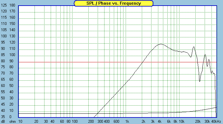

e.g. take this very budget ($2.50) tweeter :
Above is the raw response, and below with a series 2.7uF capacitor
Classic third order acoustic roll off, around 3.5KHz.
The driver has clearly been designed to be used this way.
Electrically the x/o point is around 7KHz, series won't work here easily.
Series can work with a seriously overdamped x/o (i.e. double
the inductor value and half the capacitor value of Butterworth
@ 3.5KHz) only if the symmetry suits the mid unit as well, if it
doesn't - then parallel could still work well.
Point being whatever x/o you implement it won't be first order acoustic.

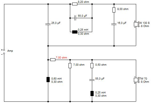

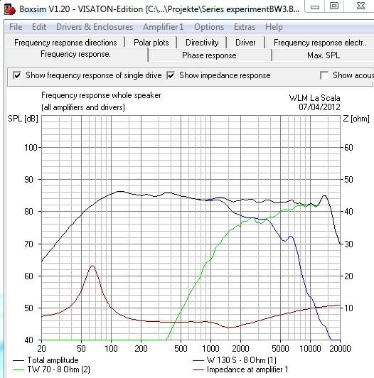

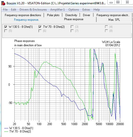

I did find I could include a useful 1400Hz bass trap with the 5" paper 0.6mH W130S in combination with the interesting Visaton TW70 paper cone tweeter without messing anything up. Results here are not far different from what I could do with a 2nd. order parallel filter, but time alignment worked far better with the series network. I'd reckon this would be a good sounding setup, and the Fs filter transforms the TW70 from a BADLY BEHAVED HORROR into something that works well with series.

Have you given us a glimpse of the future? Your sims have a date of July 4, 2012!
Right speaker? WLM LaScalas?
