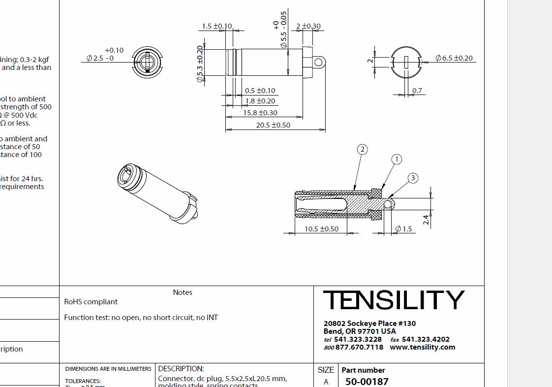

Thanks,
The difference with the SQB plug is it has a spring/clip on the inside like shown in the image below, I searched for similar plugs but couldn't find any. One of the one's you have listed appears to have the clip but the data sheet doesn't confirm it. I have no idea how you are suppose to attach the ground to the plug shown in the image
