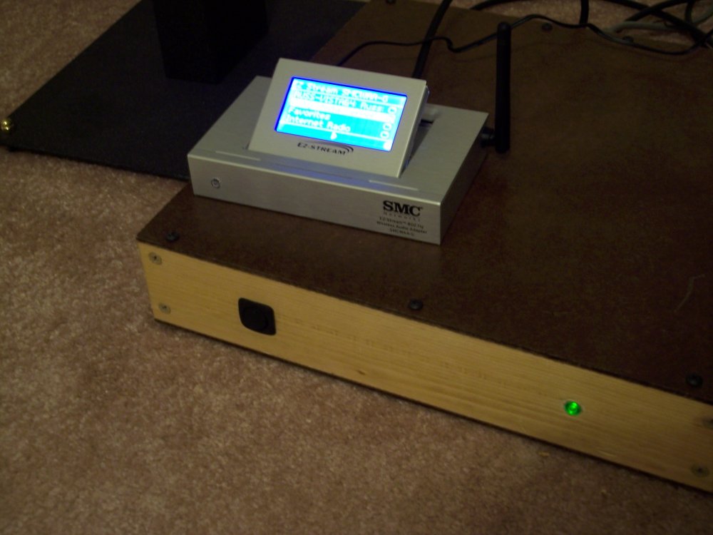

wackyterbacky said:Hi Ken:
Very neat work.
I just finished my kludged conversion, but went a different direction. I did not get a chance to order the TOTX parts, so I scrounged a PC mount RCA jack from an old sound card and put a coax output. Works great, and even passes the bitperfect "udial.wav" test.
I tested this out with a jumper wire direct connection from the DM830 chip to a DAC and it locked in and played music.
I'll post the ugly pix tomorrow, but I jumpered the R106 with a few strands of copper wire twisted together and tinned, since I did not have any solid wire small enough.
I flipped the RCA connector upside down so it's two solder tabs face up. I drilled two 1/16 holes into the RCA connector body and used two tiny screws to attach it to the PC board, using the TOTX mounting holes. I had to bring wires from under the board.
My biggest F'up was drilling the hole correctly, so it took a bit of filing to get it right.
I also noticed that the Analog RCA connectors cause problems fitting the case back together. There is a yellow plastic screw mount boss on top that is not used, but it interferes with the LCD "tray" during reassembly. I just cut it flush with some snips.
By the way, I am playing flac and ape files on this thing. I use tversity media server (freeware) and installed the ffdshow codecs (freeware) per the instructions on one of the forums. Someone gave very detailed instructions on installation.

OK, I finally received my unit and did the digital out mod. It works!! I had a heck of a time soldering in the 100R resistor because all I have is 0805 size. I had to solder it in on its side.
I really like this little box; definitely worth the money. It would be great if it could connect to a network storage device without having a PC on.
Thanks to everyone who contributed info for the mod.

Another one up and working
This one is simple coax SPDIF output direct from from the controller. Nothing fancy. I may add a simple buffer later, but for now I don't feel any need. It sounds great. I just created a solder bridge across the missing resistor.
it is feeding an Opus DAC with a transformer on the SPDIF input. It took about 10 minutes.
I then setup tversity to stream all of my FLAC encoded files which reside on a Linux box. I just created a SAMBA share and turn on my notebook(XP) when I want to stream to the SBC.

Glad to see more digital conversions. I added a coax output and it has worked with 2 DAC, a Denon AV receiver and Audio Alchemy DTI PRO32. I use the DTI Pro32 inbetween the SMC and the receiver.
I am using TVersity as the server and ffdshow to transcode flac and ape files.
The Denon indicates 44.1kHz during playback, so no resampling to 48kHz.
However, I can't determine if it is bitperfect. If I stream a DTS wav file ( downloaded from somewhere ) to my Denon AV receiver, I get noise. It will play the udial.wav just fine, but I understand this may not be a bit perfect test.
ffdshow has a codec for DTS, but there are multiple options. Also, I had read somewhere that you have to enable Uncompressed support in ffdshow. I tried a few options and gave up.
I have done all these tests with the SMC at max output. But, the volume control on the remote works on the digital output. That suggests it won't be bit perfect, since some digital filtering is taking place.
