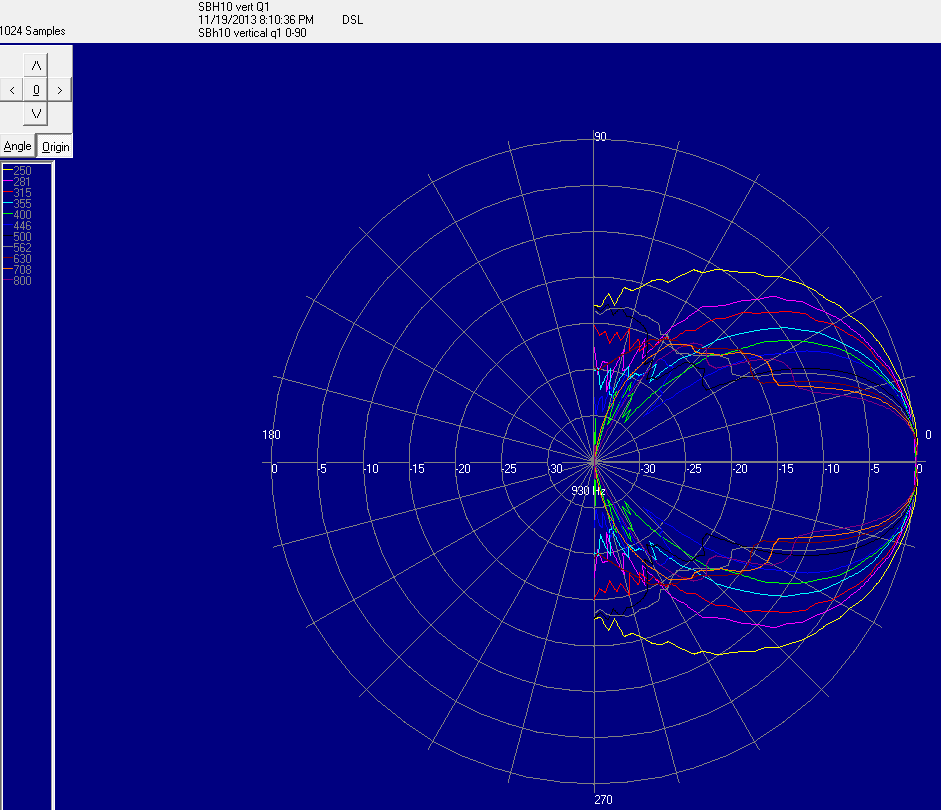

Anyway, that is the “intelivox” area that speaker is to be used in although this one you aim physically.. Pat has not had time to do his spherical measurements yet but Dr Doug took polars for me last time he was at the shop. Here is the Vertical polar stack going from 800Hz down to 250Hz as it gradually looses pattern control .
