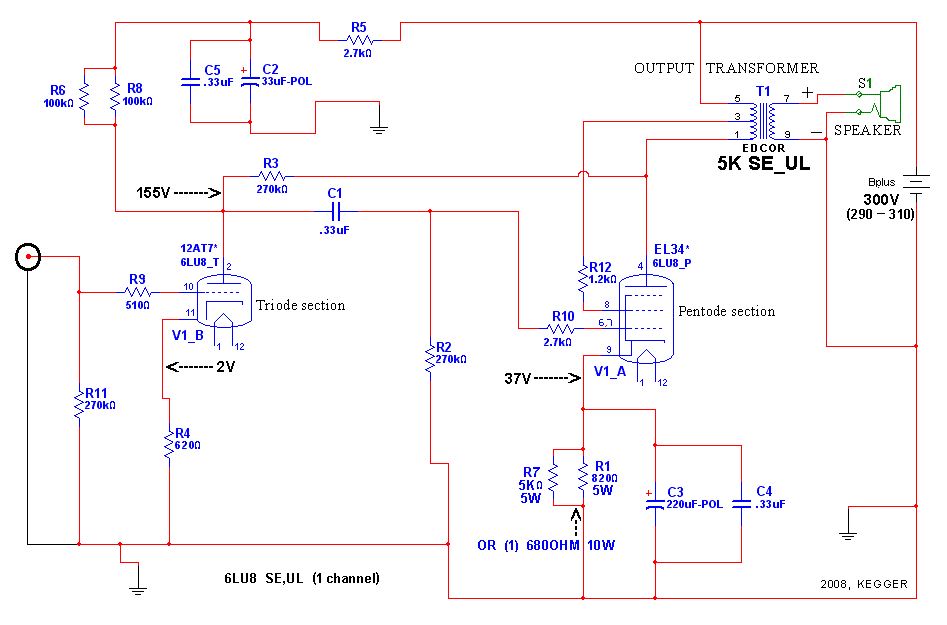

spud schem
I don't believe George would mind..
But this is the schematic for the version I did up for the AK group.
I believe the only basic difference is George used a slightly lower
plate load for the driver and used an LED to bias it as well.
We've built several this amp with results above our expectations,
I've experimented with the LED's but the simple cathode R is nice.
6LU8 or 6LR8 is the same tube but different socket, the 6MF8 is a
drop in to the circuit as well (6LU8 sub).
Any decently filtered roughly 300v supply will do fine here.

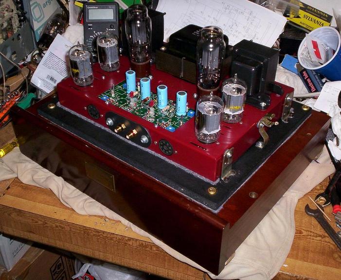

Just for giggles..
Here is a fairly all out version I did up.
I have to say this is one of my favourite amps!
I used an old ST-70 chassis, a left over VTA board and some hammond
organ amp chokes in the supply. (Choke input supply on original ST PT)
This is not push pull, it's paralell Single Ended UL, I used the VTA board
for convenience since it fits the Dynaco chassis (just built my circuit on it)
I stood up the chokes (what looks like outputs in the back) and made some
brackets to mount them, the Edcor outputs are down below, it is LED biased
on the front end with sockets to "roll" LED's.
There is a switch on the board to either use the second triodes in the paralell
6LR8 as a cathode follower to feed those outputs or go straight from the first
triodes plates, it is a combo cathode/fixed bias on the outputs with a smaller R
on the cathode and individual adjustable bias pots on all 4 finals to do the rest.
There's seperate 5v heater transformer down below of 8A, so any rectifiers can
be used of the 5AR4/5U4 pinout, (GZ37 in there now).
This amp has been running for close to a year and it is a nice performer, IMHO..

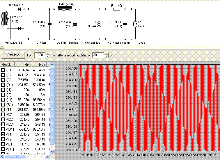

Yah you can use a 200v tranny,
I usually do tube rectifiers but do SS as well, with SS rectification and
a cap input your voltage will actually go up, in this case near 250v can
be achieved with a decent size input cap an fairly low resistance choke.
That will give you a decently filtered supply, also if your going the 6LR8
route the roughly 250v supply may make the 6GF7A drop in there to.
Also don't forget to experiment with LED biasing the driver tube, replace
the 620ohm cathode resistor with an LED that has say 1.66-2v of drop.
Now if I were running a 250v supply I'd drop the R5 2.7k resistor to 1K
and make the 100K R6, R8 resistors a single 33K - 47K resistor instead.
Attached is 200v tranny supply I would probably look to run, the choke
would be at least 4H with a DC resistance no greater than 75 ohms so
as not to drop a bunch of unavailable voltage.
(Adjusted current in the supply to account for the less voltage)
P.S. Didn't realize before posting the circuit schematic I'd allready done
so way back on the first page..
Just a note: If the 37 V on the cathode of V1_A is correct, approx 1.7 W (P = E^2/R) will be dissipated in the 820 ohm resistor. That's probably fine for a 5 W type at room temperature, but that resistor will get quite hot. I see you recommend using a 10 W type if you substitute a 680 ohm resistor for the 5k||820R combo (I'm guessing those were the values available in your junk box). With 5k||820R, you don't get an even split of the power between the two resistors - the 820R will dissipate the vast majority of it. In the long run, you'd be better off with one 680R resistor.
