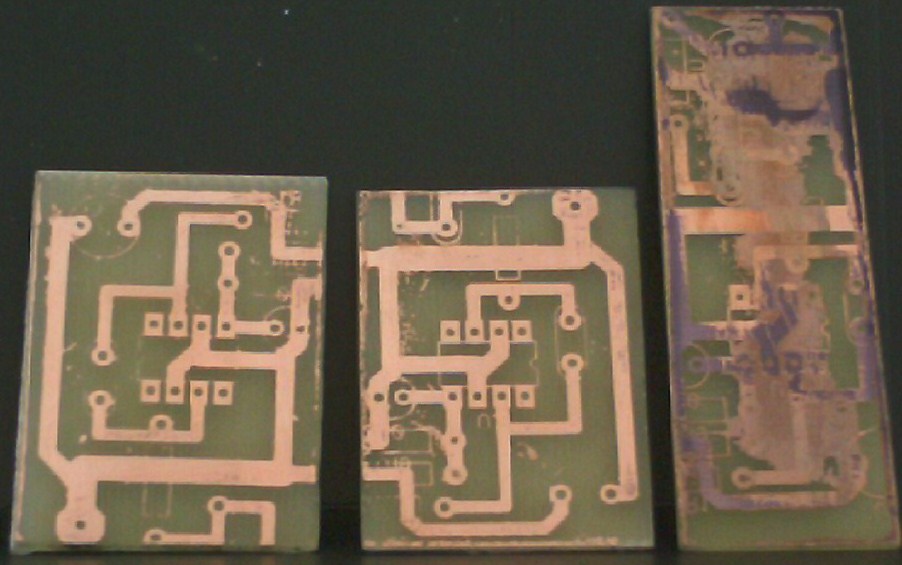

Tried the spray (Kontakt Photo 20) today. Not easy, tried on a few scrap pieces of PCB. As was said, getting it even is the big problem. Have to try Conrads suggestion of a spinner
The test boards were barely usable, lots of remaining copper both largeish areas and lots of small flecks. Tried upping the UV time to around 4 minutes (Twin tube box) --- bit better. Left two soaking in ferric chloride for two hours this afternoon for fun. 90 % O.K. after that -- strange. The resist bonds amazingly well to clean board and seems tough. The boards were quite purple in parts -- too much jalop on
Will keep trying.

If you can post closeups of the errors we may be able to point out errors like over/under exposure...
I have recently made some good boards with rather thick coats of the stuff... I just increased the exposure quite a bit... about 8 minutes sun exposure, which is double what I normally use...

Afraid I binned them. They were only very small ( about 2 by 3 cm ) for testing. The next ones I will take pictures of.
Will take much more care with the spraying --it's first time I had seen the stuff, and it's so thin ( thinner than water really ), it just wasn't even at all--most of that down to me--am sure I overdid it, it was nearly going into little "pools" in some parts.

remember you can give the boards a final light coat as it comes out of the oven to catch the little missed pinprics... the thickness of the stuff can catch you out... thicker coats will need longer exposures and visa versa, try to only change one variable at a time untill you get it right... even if the traces looks like it is a little thin, the etchant should not get through it in the time it takes to etch...
