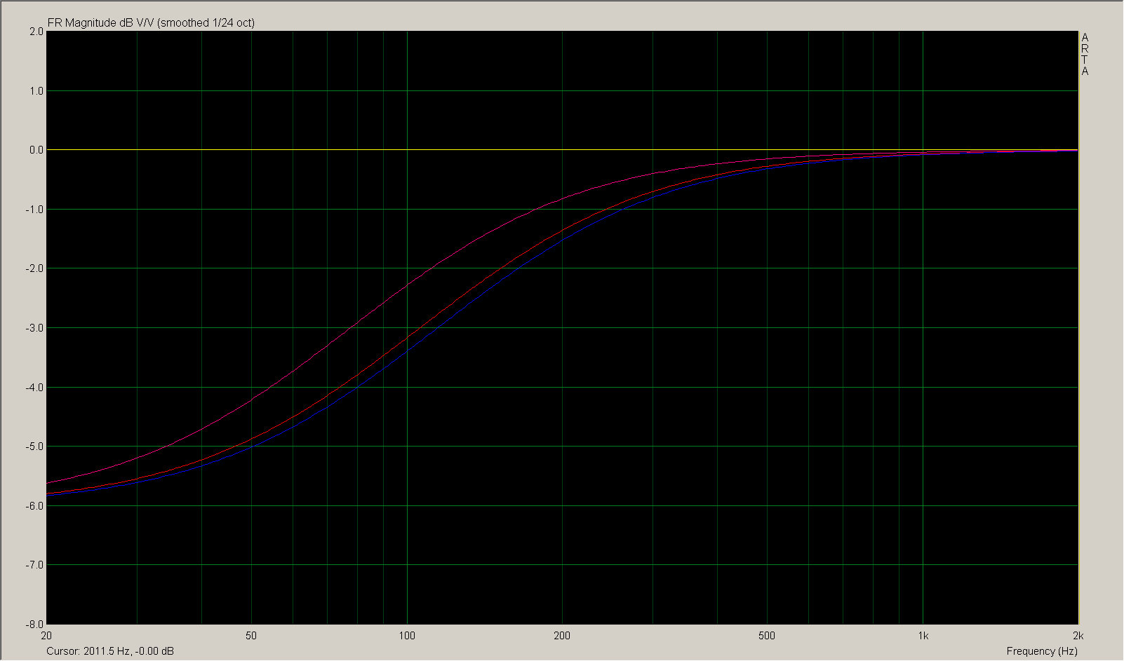

One formula usually given for calculating the half way (3dB) corner point of a 6dB baffle step shift on a rectangular baffle is 115/width in metres. (Technically, the narrowest dimension, which is usually the width)
I noticed that ARTA's results were significantly different from this so I investigated further, calculating 3 different curves using the "LF Box diffraction" overlay feature, using a flat frequency measurement as the starting point to show only the correction curve.
In the attached graph below there are 3 colours:
Purple is a baffle 52cm wide by 90cm high. 115/0.52 gives ~221Hz, however in ARTA the -3dB point is shown as 78Hz.
Red is a baffle 39cm wide by 63cm high. 115/0.39 gives ~295Hz, yet ARTA shows a -3dB point of 105Hz.
Blue is a baffle 29cm wide by 90cm high. 115/0.29 gives ~397Hz, yet ARTA shows a -3dB point of 115Hz.
This is a huge difference from the generally accepted baffle step approximations, so it seems to me there must be some mistake in the calculations ARTA is doing - either a numerical mistake, or an erroneous assumption by the author behind the equations used.

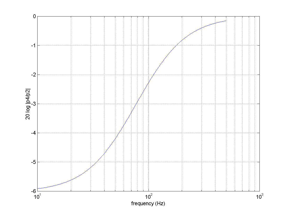

I've just started to look at this recently.
The ARTA application note states (p.5): "For a rectangular box, that has front baffle width w and height h, ARTA currently uses - as an approximation - an equivalent squared box of width d = w*(h/w)^(1/3)."
This is one thing, and you can not compare the outcome of 2 fundamentally different models: yours that takes as sole parameter the width of the baffle, and ARTA's that's also taking the height into account.
Hence with the 1st example you're providing (w = 52 cm, h = 90 cm), ARTA is computing the model of a squared box of width d=62.5 cm.
This model is fully described on the same page. There's the expression of the ratio p4PI/p2PI where f0 has to be substituted by 34.16/d for a squared box.
Below is the computation of this expression for frequencies ranging 10Hz/500Hz, and you can see that indeed the -3dB point is around 78 Hz.
The purpose of this long post is to show that there's no numerical mistake in ARTA. Now, whether their model is erroneous or not is an other question, and I'm not qualified to answer that one.

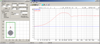

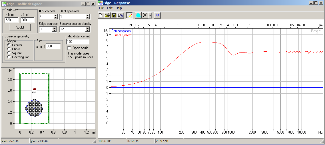

In my case I'll show the process using the Baffle Diffraction Simulator (BDS) available at the FRD Consortium. Excel required, however.A small follow up to the original point of this thread - splicing near-field and far field measurements...
I wanted to show the process used when I was designing a 2-way with drivers donated by John Krutke (zaph). He had originally given me some SB tweeters to test and later the midwoofers, so I took the time to write a somewhat detailed set of pages on my process, including all files to download and experiment. There's a page that has a number of measurements with two methods of producing a low end, splicing close-mic and using software that extends the response using T/S parameters (CALSOD). The latter has a rudimentary diffraction module, though I never used it. I probably should have.
In my efforts to find a fairly reliable method, I compared the same process using quasi-anechoic large baffle measurements that do not have diffraction to extend the response, extended that with a close-mic large baffle measurement that also has no diffraction, added diffraction to that result and compared it to in-box measurements that do have diffraction coupled with the two methods mentioned.
Zaph hosted the pages. You can see the results by going here and then to the page called "Woofer Close-mic to 4-pi".
There is also a separate page on the BDS results. Jeff Bagby's Diffraction and Boundary Simulator is another option. It will do baffle diffraction on simple geometric baffles. SoundEasy and the new Ultimate Equalizer both have diffraction simulation as well.
At my page, ignore the differences in low end at the tuning frequency. This was a passive radiator design. Some of the measurements have only the woofer response, so the PR system dip is shown. I didn't take the time to combine the woofer and PR responses in this section. The comparison with the CALSOD output is the predicted system response, so it does include both, though rudimentary.
