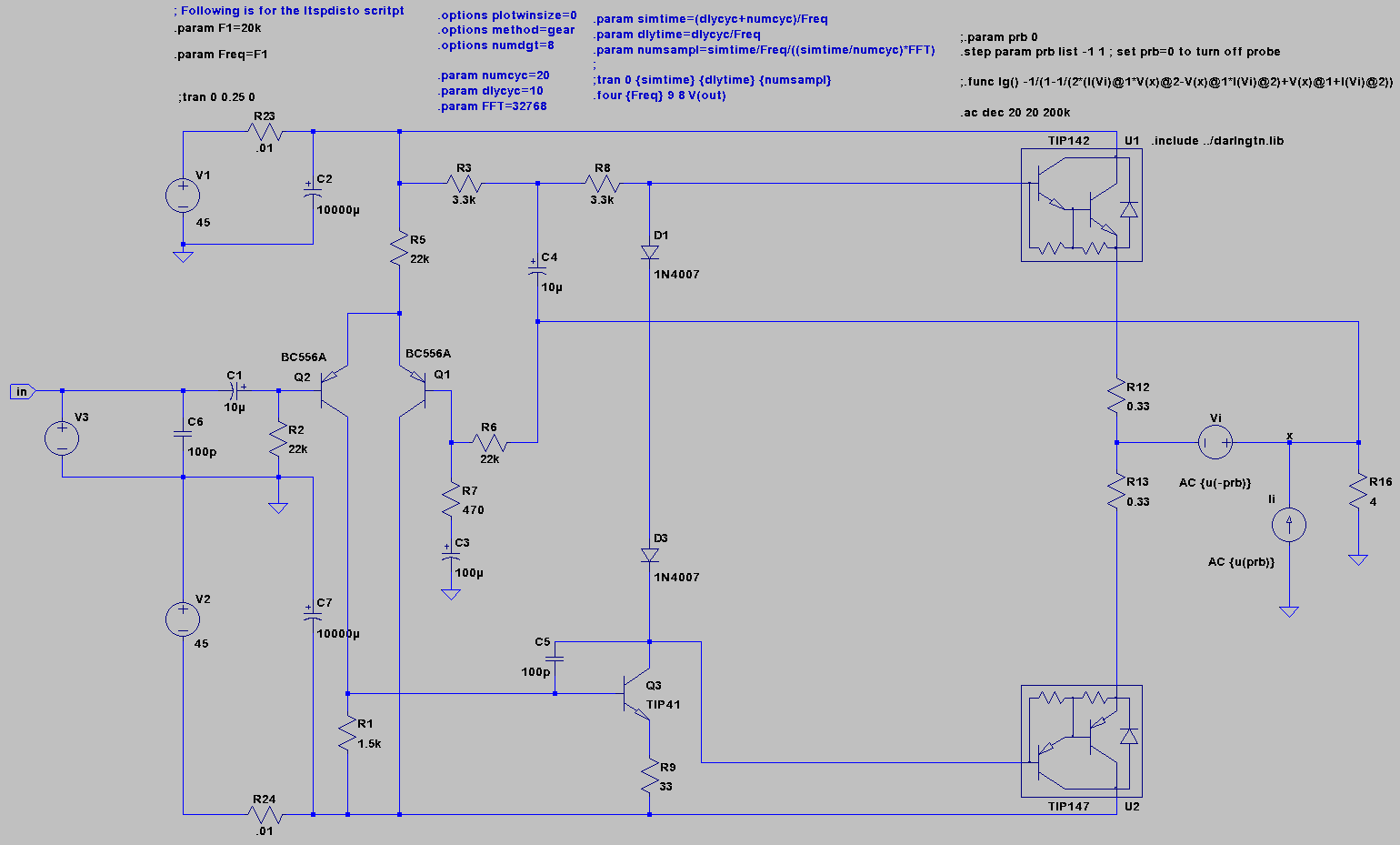

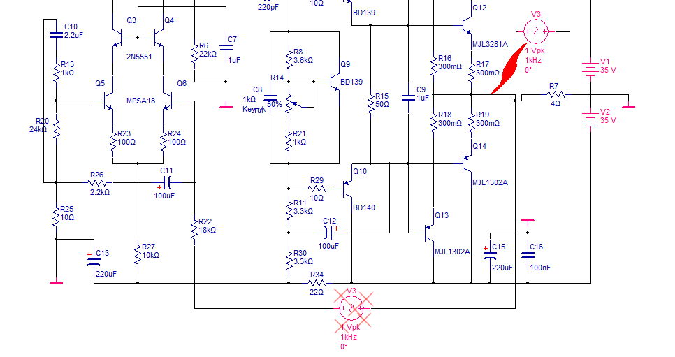

Per your suggestion, I've been playing around with measuring open loop gain. I don't know for sure, but I think you might have your voltage probe in the wrong place for the type of push-pull amp we've been simulating. I couldn't get it to work right until I moved it like this:
I'm reading the LoopGain2.asc simulation in the examples. Is this also how you read it?
BTW, while figuring out the OLG measurement, I looked at the amp circuit you posted and realized it's exactly the same as the one I was working on except the LTP & driver transistors are the opposite polarity. They're basically identical amps.
Buckeye, that is the correct method AFAIK. Maybe OS is measuring it wrong, I got that schematic from him. Although maybe he started doing it that way because he saw me doing it. In any case, I would go by the loopgain files. I was confused at first by those files, I remember doing it the wrong way for a long time.
Many amplifiers are basically the same. The devil is in the details, the choosing of operating points, the compensation, transistors chosen, grounding, etc. But actually I gave you that file because it was included default with LTSpice, guaranteed to work at first startup.
- keantoken

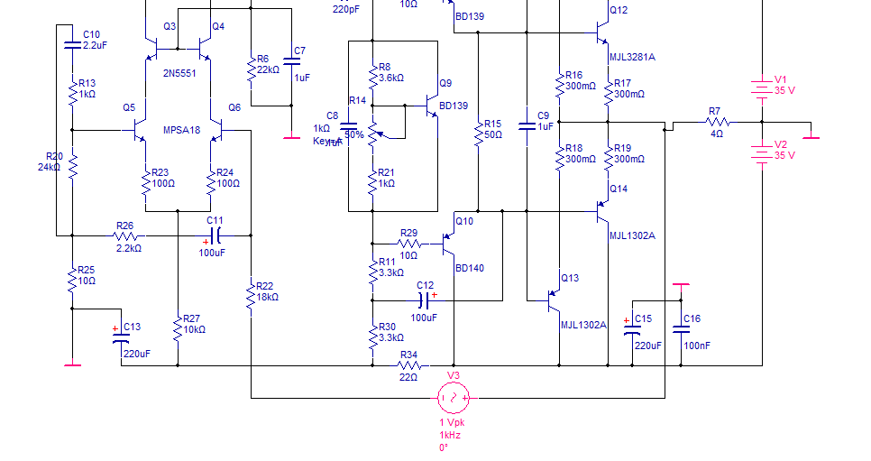

Confused here... what is the correct method, the one I posted or the one you posted? The difference is the feedback path. I think the feedback connection is supposed to be after the probe and from the point of the load. The way push-pull solid state amps are often drawn, it's real convenient to draw the feedback from where the emitter resistors are. But those resistors are what drives the load, so they have to be before the probe. I mean, if you look at the LoopGain2 example, and expand the op-amp, you'll likely see a push-pull pair driving the output. The probe is inserted between the output, which is where the emitter resistors are, and the load. Then, the feedback is taken from the load to the inverted op-amp input. That's the same as the long-tail pair inverting input.
So my point is... you can't put the probe between the LTP (-) base and the emitter resistors. It's got to go on the other side of those resistors. Right?
Disabled Account
Joined 2007
Correct is what is shown in the Mongrel file. It needs to be in the feedback loop as shown. The input needs to be grounded as well.
The plot parameters (I don't use LT, so the terms might be off) are something like this: -v(10)/V(33) where V(10) is the net after the probe (on the output side) and V(33) is the net before the probe.

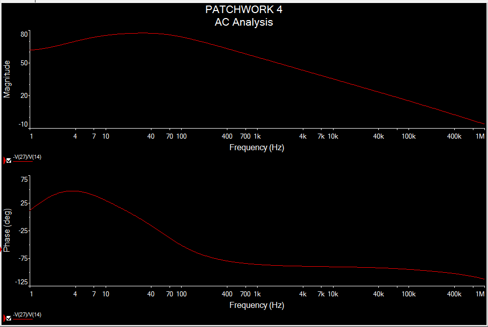

Looks like this:
Disabled Account
Joined 2007

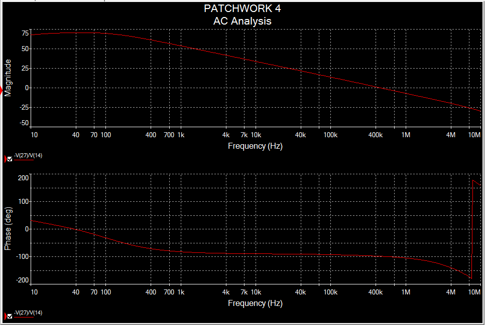

I thought if the phase goes past 180 before unity gain (0dB), the system is unstable.
I can't comment on the LT sim - I don't know how to use it. I 'grew up' on Multisim and I'm used to it's interface. I'm not an expert, by ANY stretch of the imagination, but here's how I understand it:
In the results, the thing to look for is where the gain hits zero db and when this happens, the phase should be close to -100 degrees.
The one I posted earlier was hastily done, for illustration only from a 'work-in-progress' amp. The plot above is close to the real amp.

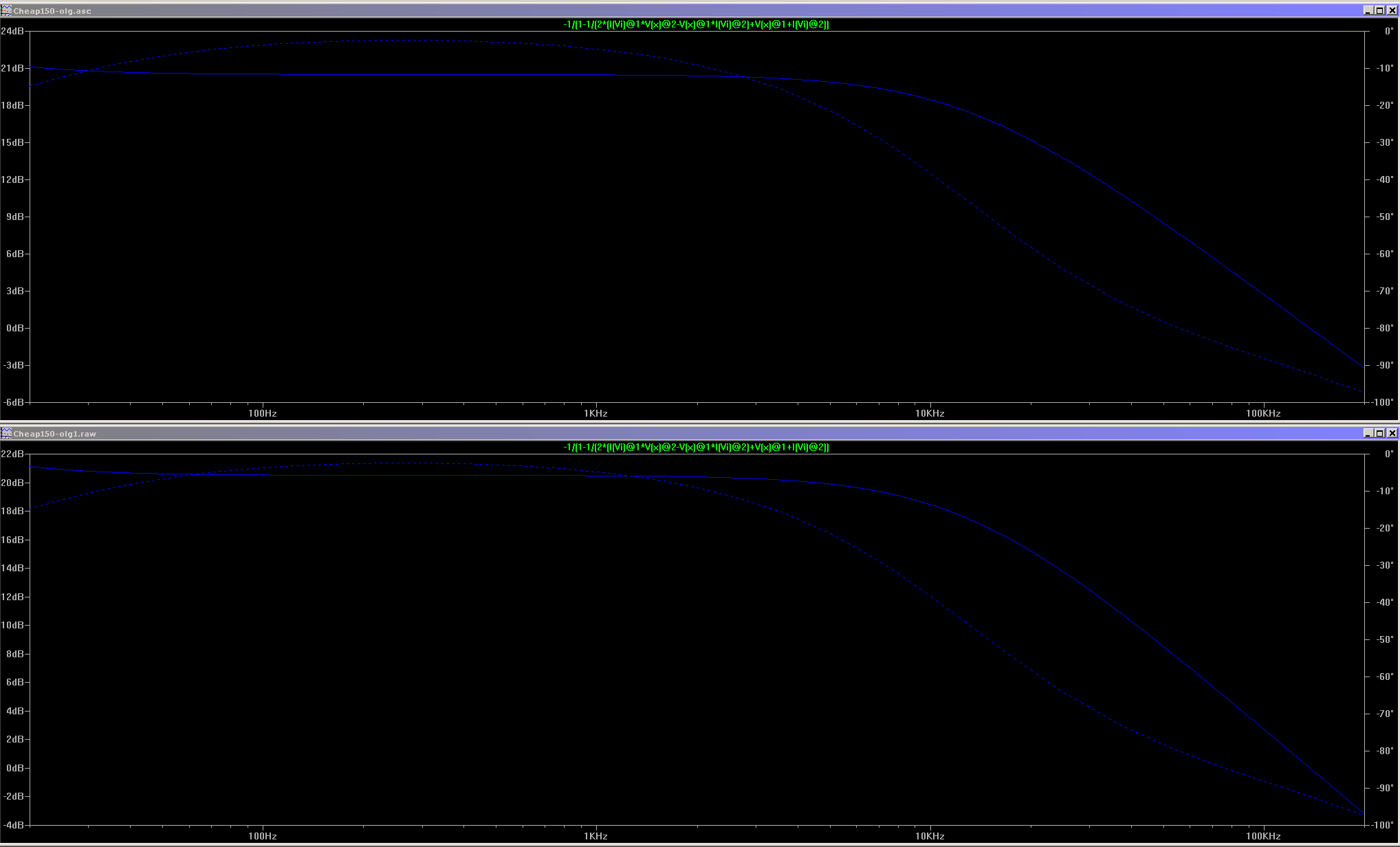

The open loop gain analysis should be the same regardless of which tool you use. What is the proper injection point for the probe? I tried it your way, and the results are similar but not identical.
The top trace is your way, the bottom trace is with the probe between the emitter resistors and the load with feedback going from the load.

My guess is that MJL's method is an approximation. In one of my simulations, MJL's method shows a big resonance at around 100MHz, while with the loopgain2 method it doesn't. Don't wanna put the schematic out here though...

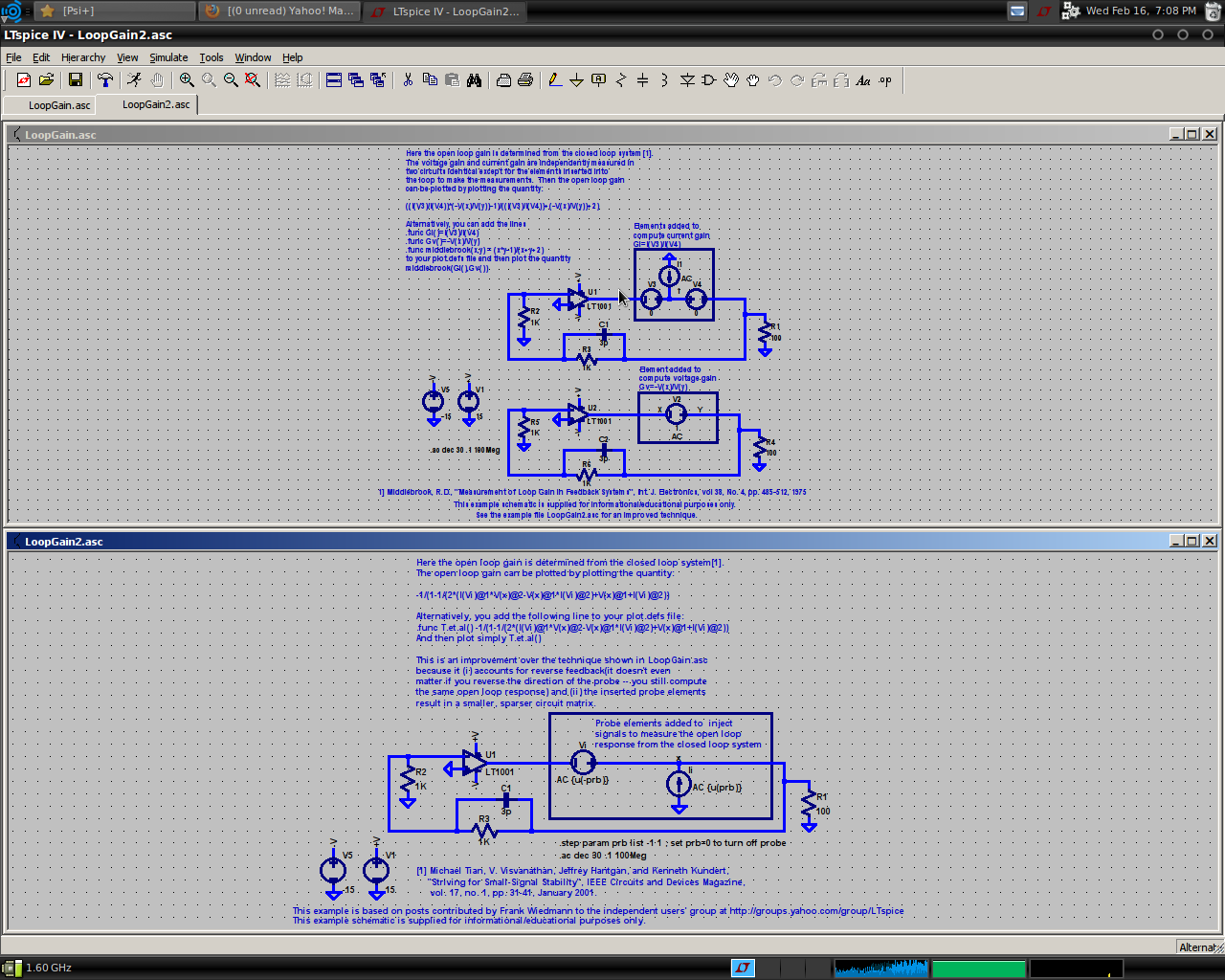

The first loopgain.asc file uses Middlebrook method, from 1975. The second one says it's "more accurate" and references a paper from 2001.
'More accurate' by how much?
You've no doubt heard the expression 'fruit of the poison tree' - this applies to simulation. Unless your device models are accurate, and the way the simulator implements them is realistic, you can throw any supposed accuracy gain out of the window.
If there is one thing I have learned it's not to blindly trust what the sim is giving as results. Chances are they are just a rudimentary representation of reality.
I've been discussing this with Helmut and Frank Wiedmann in the ltspice yahooo group. They have been very helpful.
I learned that the voltage-only probe as originally shown by keantoken is an apporximation which yields results nearly identical to the Middlebrook results. I see very inconsequential differences at frequencies above a MHz, and none at lower frequencies.

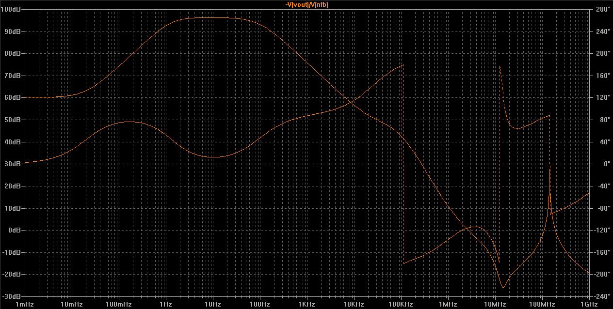

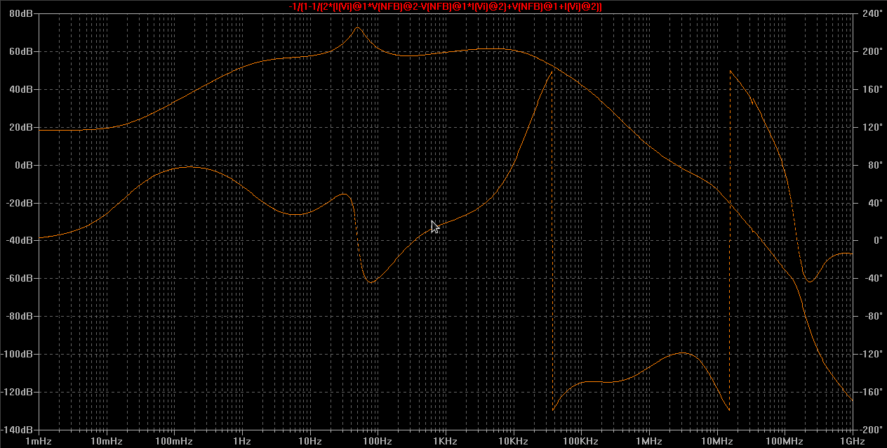

I used both methods and I've attached OLG plots derived from one of my more interesting designs with each. It may depend on your circuit. Perhaps simulation is not accurate at 100MHz, but if I designed a slower circuit it may be down 40 or 20MHz. The first plot is with Middlebrook and the second is with the newer method. Also of note is that the second method is less optimistic on phase margin.
Square wave plots reveal not a hint of 100MHz resonance, so I conclude the second method is correct. I wouldn't play with accuracy, but I would say it's simply appropriate and that the first method simply isn't, and if the two methods give different results then one must be more accurate than the other, for the input given.

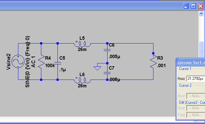

I'm try to simulate a line filter. You'll see my schematic below. I don't know if I'm even close to having a correct schematic relative to how spice sees this circuit. When I just use the inductors and no caps, it wants a ground somewhere, so, I put the ground between the two caps. I can't get much current to pass through R3 regardless of how small a value I place here. Ideally I want to see the behavior with a 3 to 6 amp load. All help appreciated.
Ken
