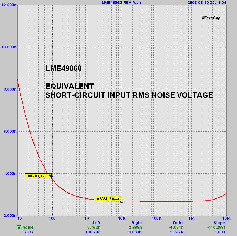

I tested the model for noise, and it is very accurate.
Attached is a plot.
Sigurd
Attached is a plot.
