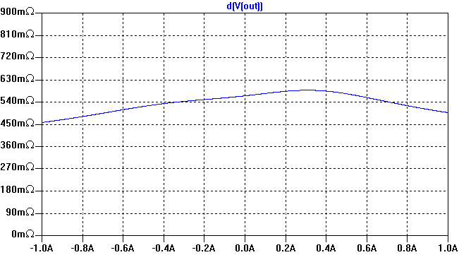

Hi Charles,
There's an interesting thing about the "kinks" in the FET SPICE plots.
The Oliver paper deals with output stage nonlinearity in terms of the variation of the output impedance with current, while Self looks at the variation of voltage gain in a similar way - taking the derivative of Vout with respect to Vin. What I like about Oliver's approach is that it removes the load from consideration. Back in post 555 on page 23 of this thread I did some plots where I swept a DC current source at the output of a complementary EF and SF and plotted the derivative of the output voltage with respect to the swept current. This was to show the incremental low-frequency output impedance vs. current. If you look at the one for the FET, you'll see the "kinks". It's clear that the slope of the simulated output impedance is discontinuous in two places. Since the output impedance itself is defined as a slope, then it's a "slope of the slope" or second derivative phenomenon.
Let's look at the second derivative of the Id-Vgs equations that SPICE uses in the simple FET model (in this case, level 1). The equations are:
Id = 0 for Vgs < Vto
Id = K(Vgs - Vto)2 for Vgs >= Vto
So for Vgs < Vto, the second derivative is 0. But for Vgs >= Vto, the second derivative is 2K. There's a discontinuity in the second derivative of Id vs. Vgs at Vgs = Vto. A reasonable hypothesis might be that the discontinuity in the second derivative of Id vs. Vgs is causing a discontinuity in the second derivative of Vout vs Iout. This is equivalent to a discontinuity in the slope of the output impedance vs. output current.
How can we test this hypothesis? Well, the BSIM3 FET SPICE model has equations for Id vs. Vgs for which all the derivatives are continuous (reference here). Also, Edmond Stuart (estuart) has created subcircuit models for the 2SJ201 and 2SK1530 that use the BSIM3 FET model internally. If we take my circuit from the post on page 23 and replace the FETs with Edmond's models, we can look at the output impedance vs. current. I have done so, adjusting the bias for 150 mA per device. I've plotted the output impedance vs. current using the same scale as the plots on page 23. I've attached the plot below. Notice there are no kinks at all, and the plot is indeed very smooth.
So my conclusion is that the kinky behavior of the FET SPICE plots (both in Self's book and on page 23 of this thread) is due to a deficiency in the level 1 SPICE models and not the devices themselves. BSIM3 seems to fix this.
