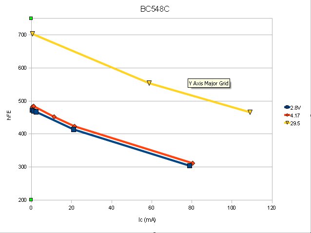

SPICE parameters are quite different from how humans look at a device. SPICE "knows" how a BJT works. These parameters adjust its computations to the specific device-type's size, doping, etc. Nagel's Table A3.4 lists the BJT parameters. (This is as-of 1975, when the BJT model was quite mature and solid, but more parameters may have snuck in since then.)
Most of these parameters are gibberish unless you already have good understanding of how a BJT works, which is not a 1-hour study.
The inconsistency at the top of this thread is perhaps due to vendor technicians measuring slope at a convenient low Vce voltage, too low for the final value observed at high Vce. SPICE "knows" a theory by Early which assumes collector lines are straight and asymptotic to VA; in the low-volt range they deviate. ME may also affect this line.
Nagel's 1973 paper is shorter and goes right to the BJT model.
https://www2.eecs.berkeley.edu/Pubs/TechRpts/1973/ERL-382.pdf
Figure 4 shows the curves questioned at the top of this thread and how VA defines the slope of hFE over Vce.
