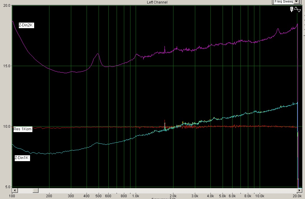

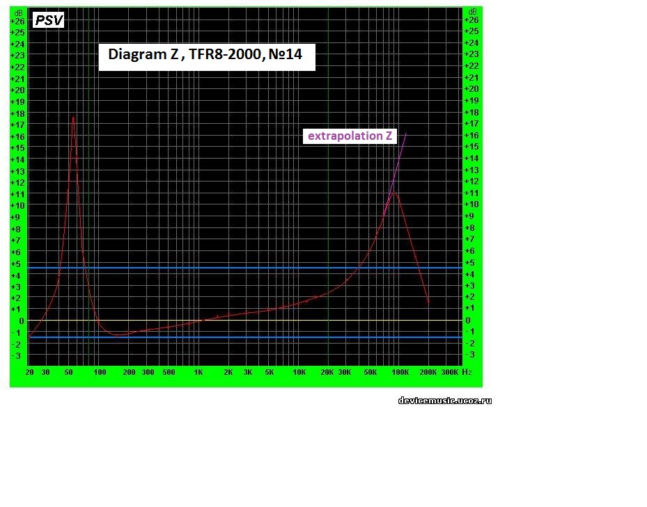

Diagram complex impedance with frequency TFR8-2000, №14
Clearly seen that the inductance of the coil (at 1 kHz) does not matter much.
150 Hz / 20 kHz - almost a straight slanted line!
Z very complicated dependence on frequency.
Expressed in dB: 0 dB = 2 kOhm.
Full-range speaker, 2 kOhm nominal.

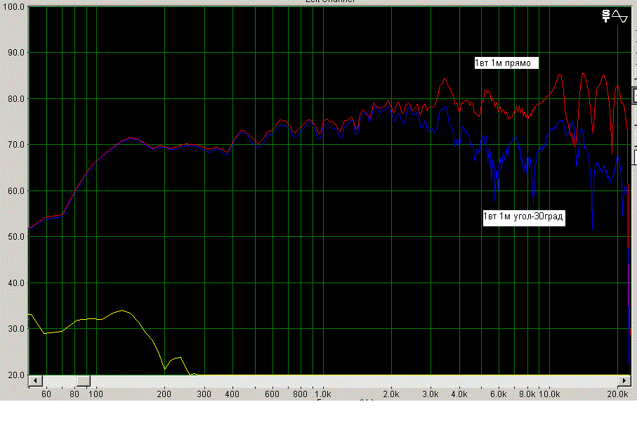

There are measurement results speakers with a nominal 1000 and 2000 ohms, in the anechoic chamber, strictly according to the classical method.
Deviation in the range above 100 Hz is not more than 0.5 dB.
Parameters Thiele-Small:
Z=1000:
Re - 771om
Fs - 53.17Hz
Vas- 48.3L
Mms- 13.21grm
Qms- 5.5
Qes- 1.726
Z=2000:
Re - 1483 om
Fs - 54.65hz
vas- 44.8
Mms- 13.44 grm
Qms- 7.713
Qes- 0.5358
In attachments, frequency response speakers with a nominal 2000 ohms, impedance, frequency response apmlitudno and THD speakers with a nominal 1000 ohms.
40-22000 Hz from a single 8"- not bad.
"In the regiment" 22,000 Hz and a 2000-ohm speakers!
Confirmed peculiar characteristic of the complex impedance. Very small increase with frequency, instead of the classic quadratic curve - almost straight sloping line.

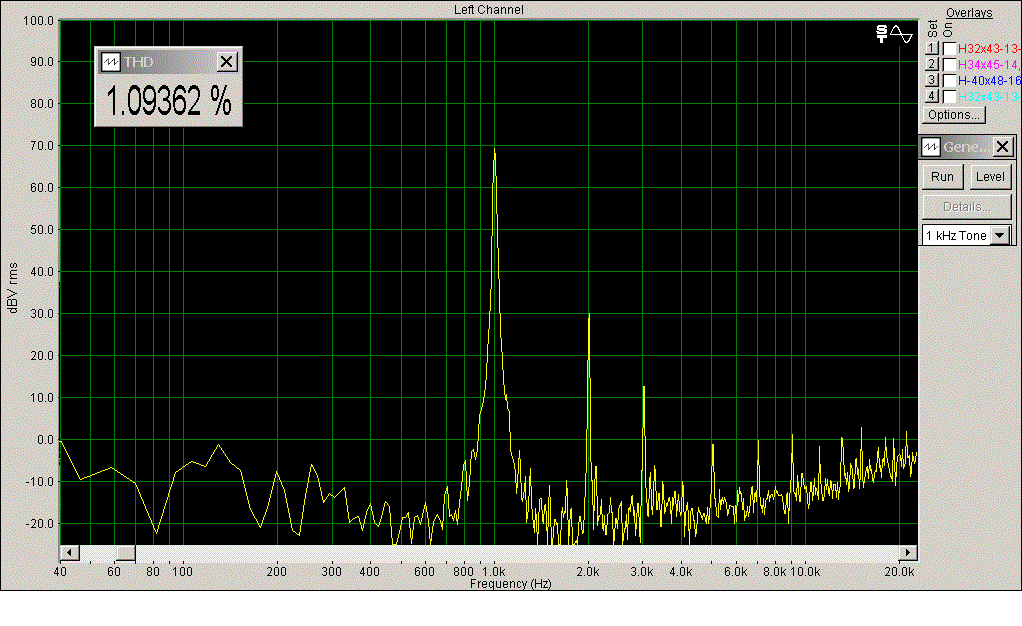

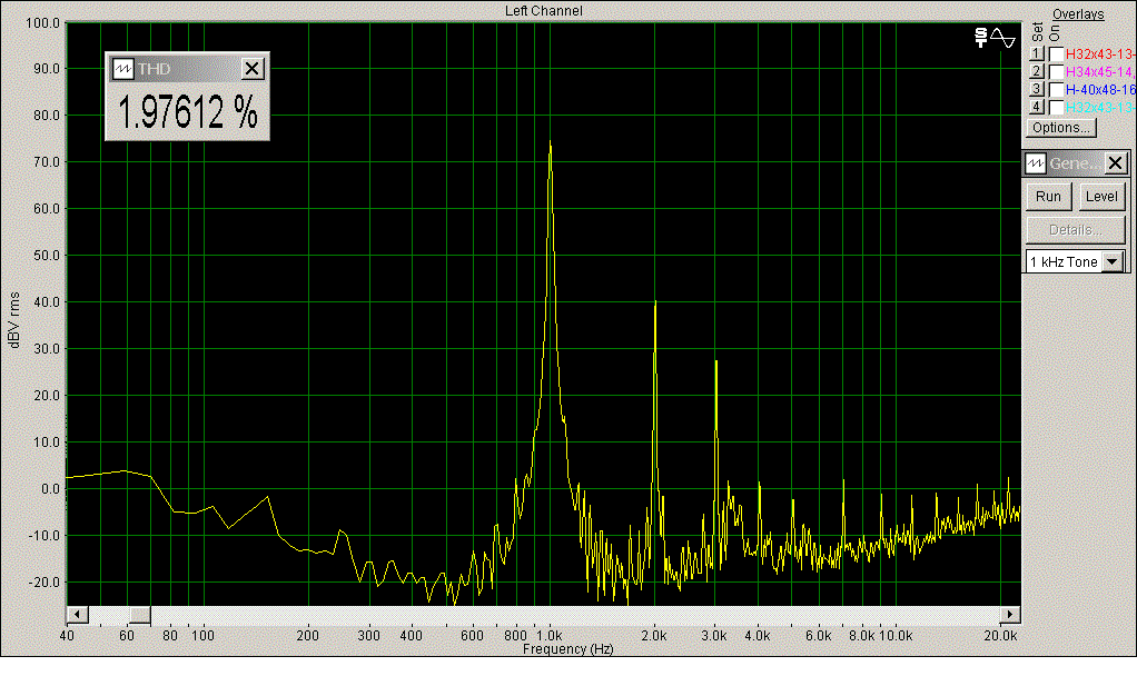

Measurements alternative: "... do not claim to infallibility metrology, and can not be used for comparison with the results of other similar tests ..."
Shows the spectrum of harmonics. Range is measured in a wider lane:

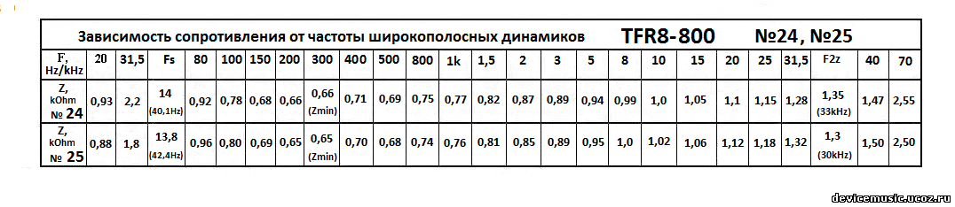

TFR8-800, №24, №25.
Thiele-Small parameters: DC resistance, Re; resonance frequency, Fs, Hz; Q-- mechanical, Qa; electric, Qe; complete, Qt; equivalent volume Vas. Frequency doubling of the minimum impedance F2z, kHz.
........Re, Оhm;....Fs, Hz;....Qa;.....Qe;.....Qt....Vas, l.
№24...596.........40,1.....11,0....0,54...0,51....64
№25...593.........42,4.....11,1....0,56...0,53....56

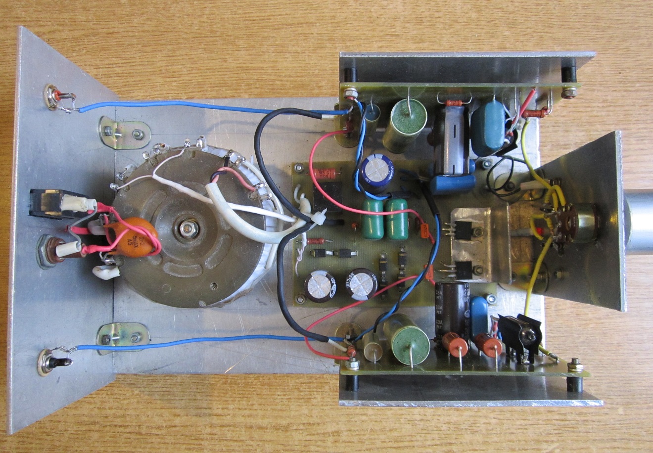

Thank you, DIYBras.

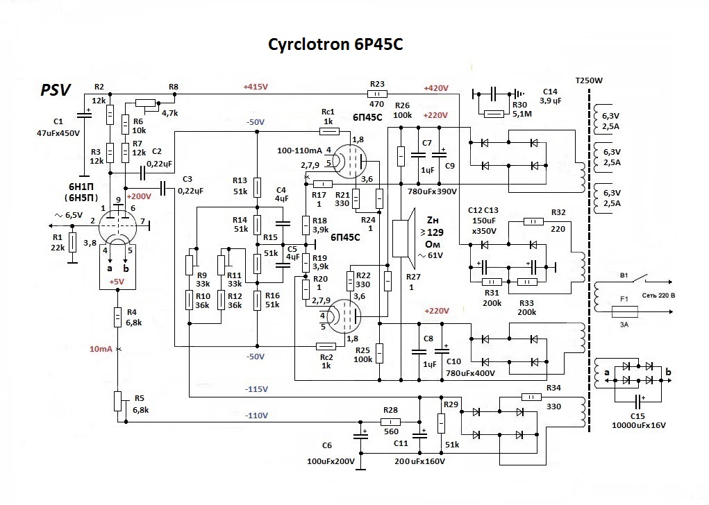

An option, is made of high-current cathode-emission-exaust OTL amps.
Preamp and two monoblock amplifiers "Cyrclotron 6P45C". One powerful tube in the shoulder. Without the case, on the chassis.
Load - 32 consecutive fullranges speakers of 4 Ohms.
A little over 100 ohms. 25 W power.
Measured the real emissions of several high-current tubes at 14.5 V.

F, KHz,......Z, Ohm
0,2...........42
0,3...........42 (Zmin)
0,5...........43
1..............46
2..............54
5..............65
8..............70
10............73
15............75
20............77
29............84 (F2z)
