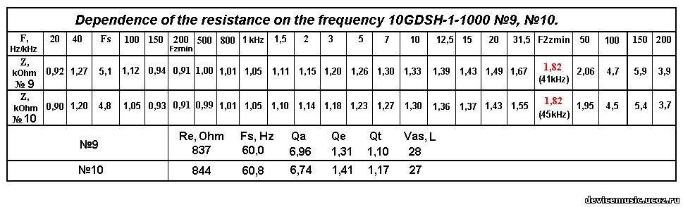

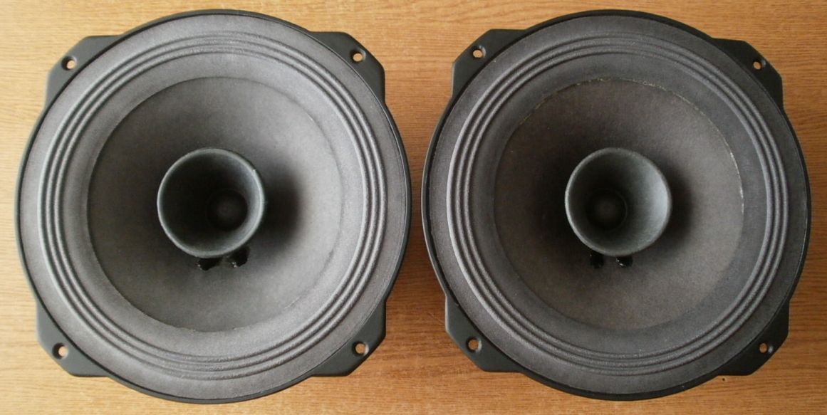

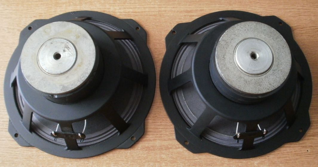

Self-designed full-range speaker with a high resistance. Especially for transformerless tube amplifiers. Rated impedance 1000 ohms. However, he has a very weak dependence on the frequency of resistance at medium and high frequencies. Provisional title 10GDSH-1-1000.
Diameter of 8 inches

Voice coils are made to order, using special equipment, according to my drawings.

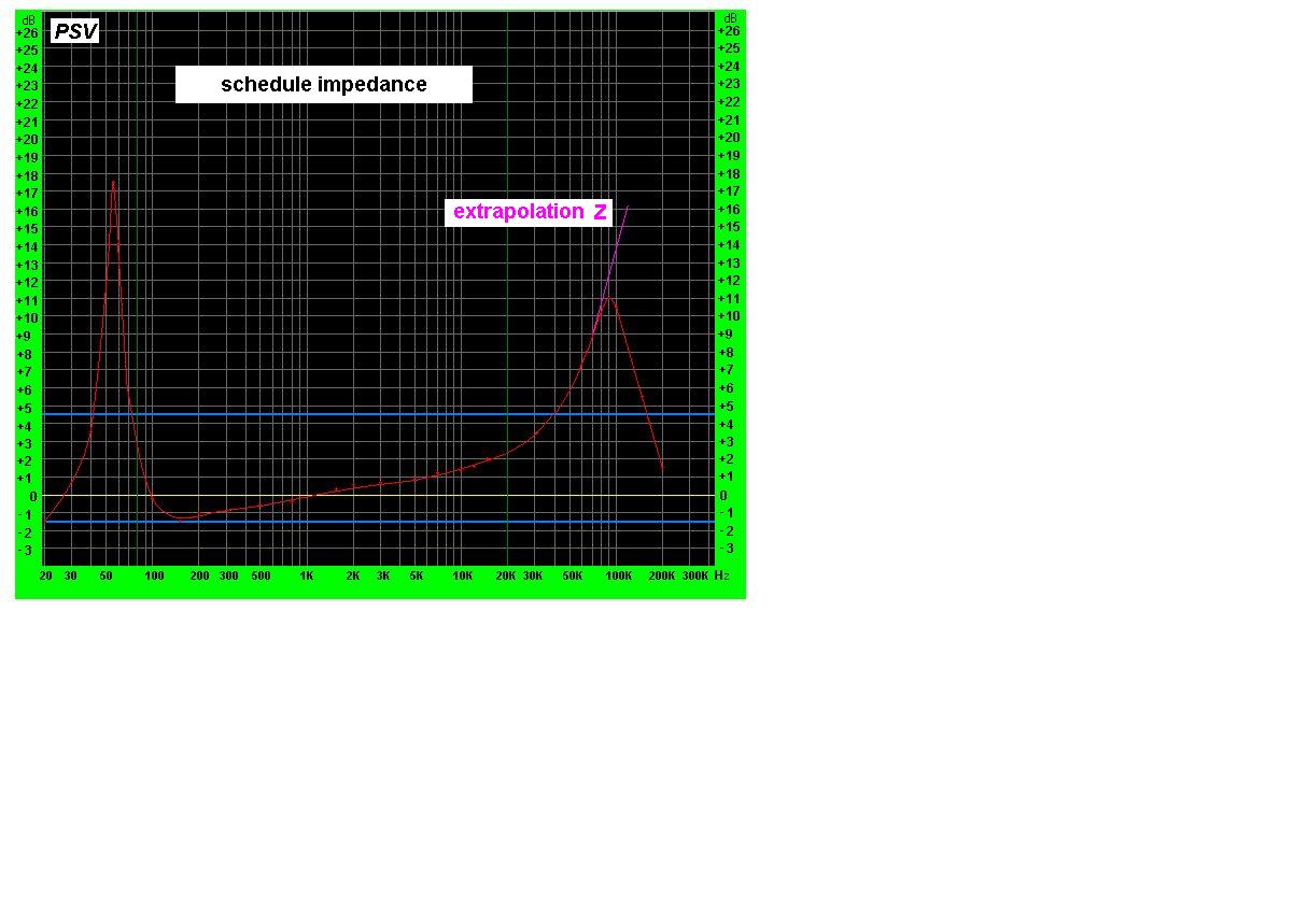

If You notice, these speakers have very low inductance. It is much lower than that of their counterparts of low resistance.
Do You have a Philips 800 ohm speakers?
You could not measure their Z, Phillips 800 ohms at a frequency up to 200 kHz?
It is very necessary for comparison.
Here's what's interesting. Sound from low-inductance full-range speakers to a "normal" 8 ohms is very different from the sound of the same full-range speaker, but with a "normal" inductance.
Inductance frequency dependent.
Therefore it was necessary to introduce the term "doubling the minimum impedance " F2z.
Typically F2z=7-15 kHz for full-range speakers.
The same was observed with high-resistance full-range speakers.
It would be ideal if F2z exceeded the sound range.
As is the case in high-frequency speakers. Better if twice F2z = 31-40 kHz.

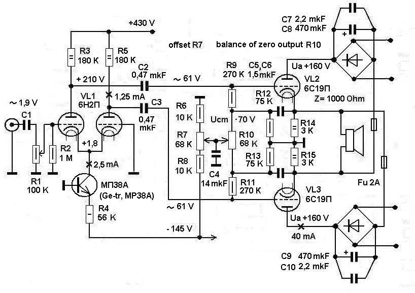

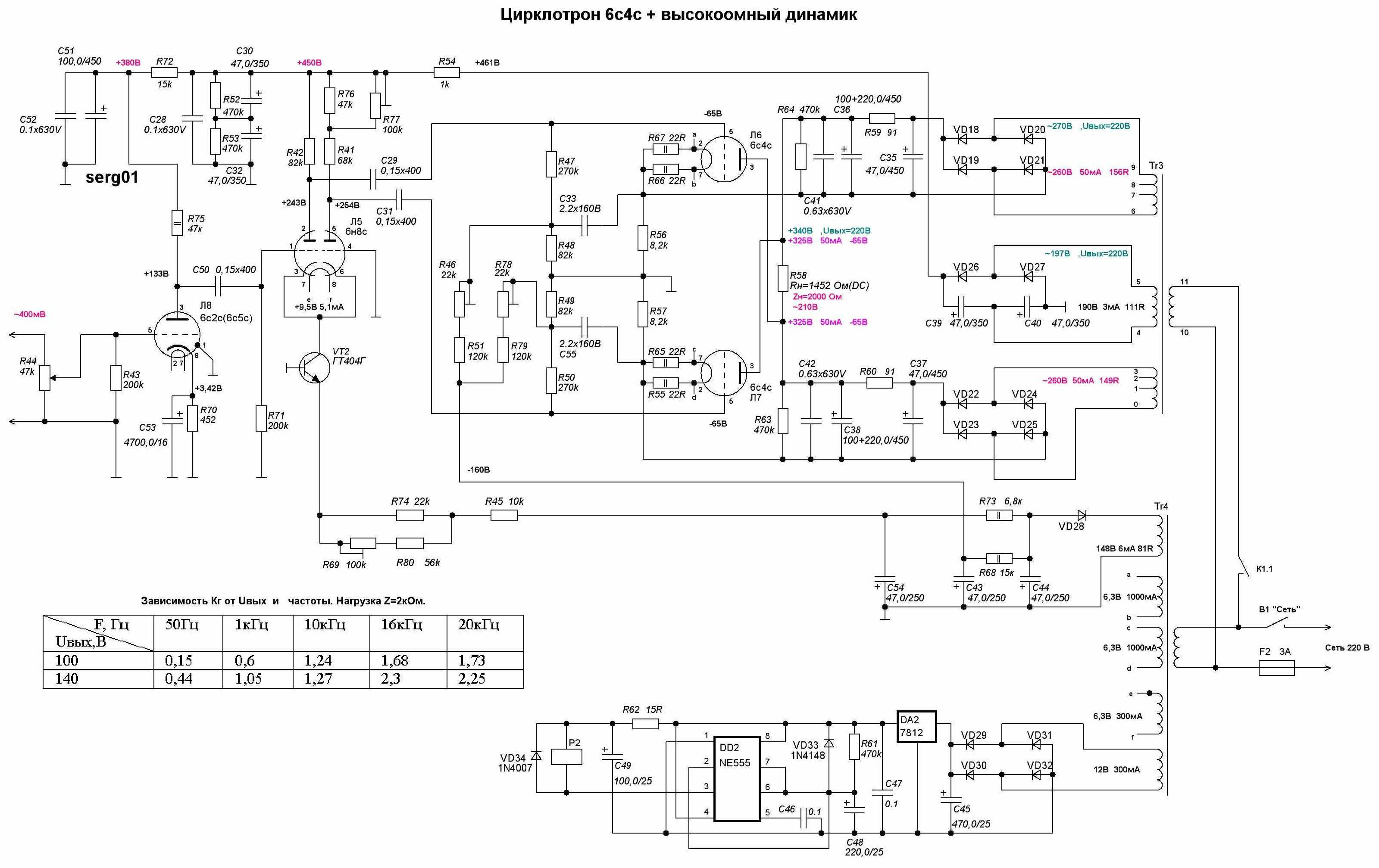

For safety reasons, and to avoid someone getting the Darwin award, I think it is quite acceptable of this amp/speaker pair to require proprietary connections.
Typical professional amplifier 800 W / 8 ohm output is more than 113 volts.
Closed Speakon connectors and appropriate professional cable will solve the issue of electrical safety.
Two free contact pairs Speakon four maybe used for the relay. In the amplifier circuit relay commutes anode supply.
Which switch anode amplifier supply in the case of connect to the off speaker.
