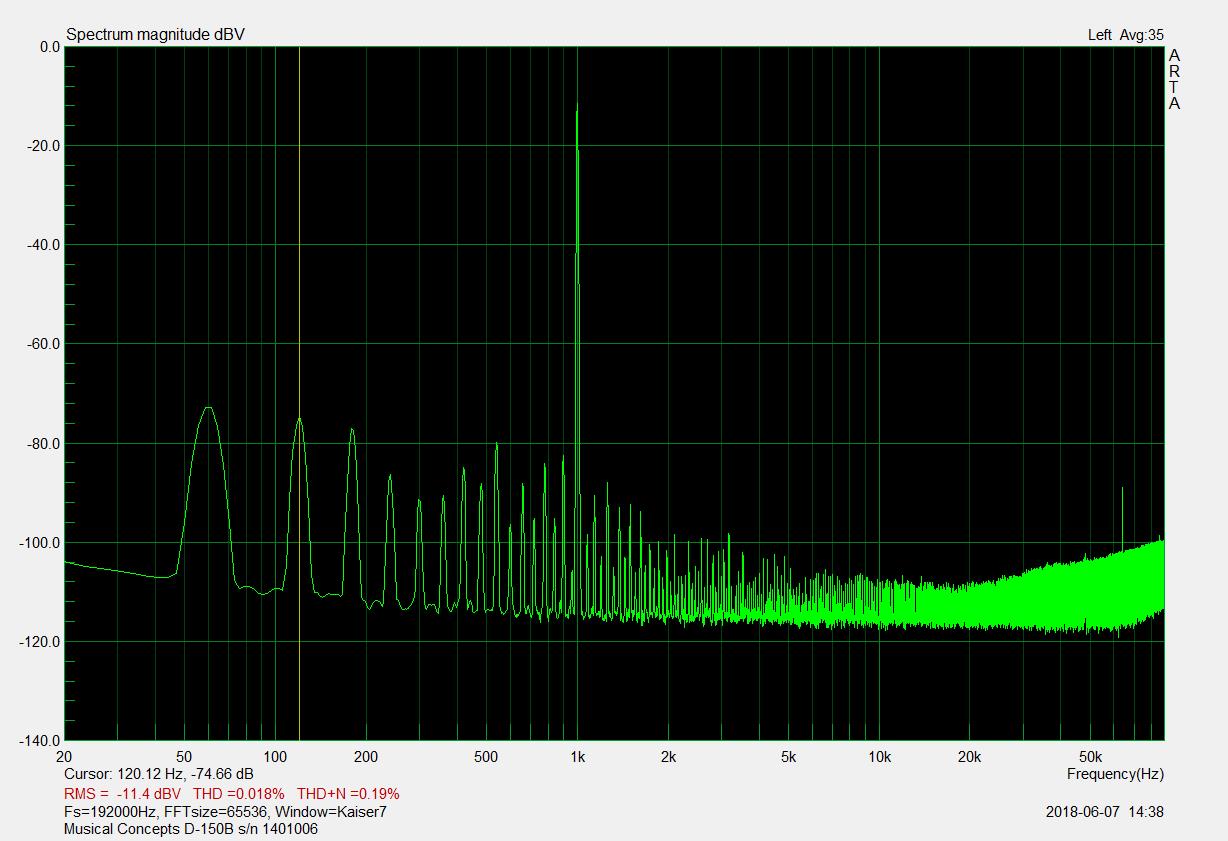

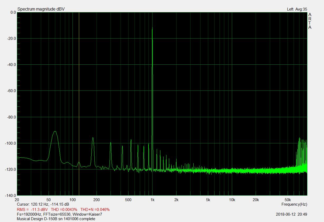

Hi Andrea,
I can accept difficulty in language and explaining oneself. No problem.
Published specifications are always worst case to cover the most unfortunate unit that comes off the line short of being defective. It isn't uncommon to find the average performance might be a factor of 10 better in some cases. But distortion numbers are only a hint of performance. What you need to see is the output spectrum showing the signal, harmonics and other tones, and the noise floor. That can tell you a great deal about the design and execution.
We normally can detect stuff about -80 dB down - approximately. That is also the noise floor of older THD meters (good ones). I used such a meter for years, but also took the monitor output into a spectrum analyzer which allowed me to "see" deeper and to see what we were actually measuring. That makes a big difference.
Over the years I was involved with improving the performance of existing designs along with repairing them and designing new products. I'll include an extreme example of one amplifier that was sold as an upgraded unit and what I was able to do with it. Once it was complete, the amplifier sounded sort of acceptable, but it was a mess before I started. See attachments. Note that tests are done at about 1 watt into 1 ohm. This is because most amplifiers perform at their worst at lower levels, and 1 watt is kinda loud. So it represents an area of worst performance that corresponds to a realistic listening level. While its numbers aren't bad, this amplifier design does not sound very good. At least it is good enough for the owner to sell it now, or he can use them as backup amplifiers.
If I had readings for the Cyrus amplifiers I would post them. I might try even though the output connectors are something I do not have plugs for (BFA connectors).
Just because something has excellent specifications at 1 watt, the performance can fall to pieces at higher volume levels. IC chips are famous for this and often sound excellent at low volumes. I can't comment on those you refer to without auditioning one, then measuring it. If one became available, I would assess it and let you know.
-Chris

It's pretty bad, isn't it? There is one peak from my LED work lights on the bench, but I know what it is and ignore it.
Basically, the amp isn't as stable as it should be and maybe switching distortion in the output stage is exciting something else. I didn't completely analyze this product. I was paid to make it listenable by solving the worst of its problems. I was successful in doing that. I did not have a schematic or I probably could have done even more to help it.
-Chris
