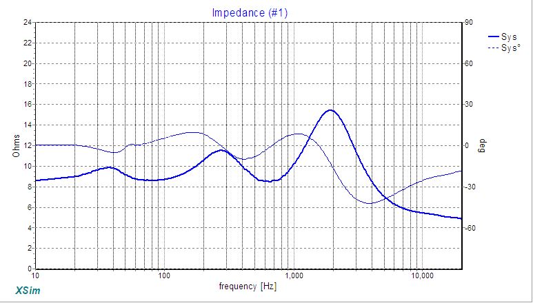

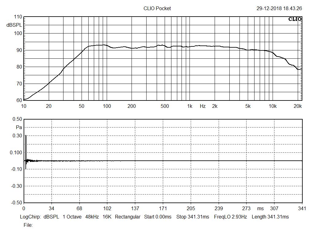

Hi Chris,
just for example one of my last experiences.
Not too much variables, same environment same source same DAC, same speakers. Different amplifiers only.
I have used relatively easy and transparents speakers, an open baffle like the OBL11 with different drivers.
I replaced the mid driver with the L-CAO AlNiCo 8" full range and the upper driver with the Harwood 2.0 ribbon tweeter.
I attach the frequency response and the impedance (it's a simulation but it's just what I have measured, I canno find the plot).
After several listening sessions all the partecipants did agree that with a 845 DHT SE amplifier the piano, the voices and especially the orchestra were reproduced much more realistic than using a LM3886 based amp.
The measurement told the opposite.
The LM3886 based amp has a THD around 0.002 % at 40W/8 ohm while the DHT based amp has a THD around 1% at 15W/8 om.
Therefore although the measurements are absolutely reliable they don't explain what we have heard.
This is the reason I'm used to listen after measuring.
