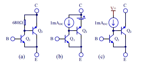

Achieving very low output impedance in an amp is composed of 2 parts. Of course, negative feedback lowers (apparent) output resistance, but that is not all. First, you have the OPEN LOOP output impedance which is a function of the CIRCUIT TOPOLOGY. Voltage followers are best, and bipolar transistors are champion. However, IF you use a bipolar output stage, you MUST drive the final stage with a VOLTAGE DRIVE, and this is not so easy. Many will use a triple Darlington and this can work well enough. I personally use a complementary power mos fet driver that drives the bipolar output stage. This achieves pretty low output impedance without feedback, so added feedback is just a 'bonus'. Now, does the combination that I use make the best amp possible? It will give you great specs, but in truth a constant resistance over frequency appears to do just as well.
The trouble with series resistors is not power, simply use MPC type of metal oxyde 5 or 7 Watt types, if necessary with two or three in parallel, but finding the just right value for your speakers takes time and a reasonable stock of relatively high power resistors at hand.
And once you do get it right, that's good just for you, elsewhere it may be all wrong.
John one solution that often works quite well here is a CPF-driver in class A.
jan
CPF-driver? Please give example.
Sorry I meant CFP - compound feedback pair.
