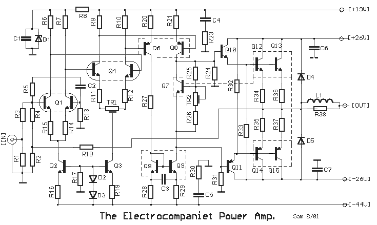

Jan, as one who has taken much interest in the subject, I cannot promise, but I think I have the schematics of the Electrocompaniet somewhere, buried deep down in some old, fogotten log. I'll try to look it up and post a copy here, with the schematic of the original, so everyone can see for themselves.
BTW, I have also heard the story of their demanding that their names be taken off the fascia, because it was not the same amp, and Electrocompaniet never bought any right to using their name and/or their electronics. If Lohstroh says so, for me, that's it, that's the truth. I don't know him, but I sort of like him and certainly respect him.
Here's a copy that I have.

Jan, as one who has taken much interest in the subject, I cannot promise, but I think I have the schematics of the Electrocompaniet somewhere, buried deep down in some old, fogotten log. I'll try to look it up and post a copy here, with the schematic of the original, so everyone can see for themselves./QUOTE]
Here's the original paper with schematic and parts list.

Yes that's it. Lohstroh's view is here: http://www.linearaudio.nl/linearaudio.nl/images/pdf/Jan_Lohstroh_interview(1).pdf

The original had much more feedback and less distortion, especially in the treble.
The Electro homed in on a meager 1.5% THD at 40kHz.
Hey, man, it had a 3 STAGE VOLTAGE AMPLIFICATION ( the Otalla - Lohstrom ).
The notion that the norvegian amps got such a good review although they where configured for only 20dB of NFB created that 30 year battle that only low feedback amps can have low TIM.
One of the clasical disasters of misunderstanding.
Put a fitting low pass filter and the TIM is gone. OK, the slew rate discussion....
