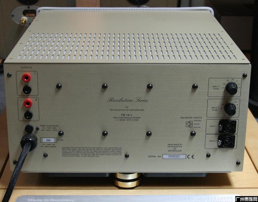

throwing out an FM1811
Barrel-wound transformers are half the weight/size and manage 50% higher peak output levels, but in all other aspects they behave as regular transformers. Nice if your name is MJ, with your own sound studio, and not dead yet.
Regular folks would just pick a 2-3 times larger toroidal transformer (or a single R-core biggy per channel, instead of a 3kVA power transformer for stereo), and save plenty dollars.
Does it matter whether something weighs in at 100lb or 140 ?
(made me wonder how something can have an rms power consumption figure of 3600 watts, on a mains supply of 25A times 120V, aka 3000W ? )
