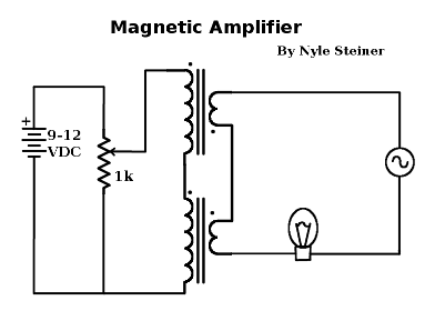

You seem a candidate for a magnetic amplifier . It is said some are under the oceans and could out live the pyramids with zero servicing .
From what I know 200 000 watts is as far as they went . Distortion was low enough to be OK . They are a transformer held at or near saturation . The input signal alters that and results in amplification . Some resemblance to a CVT transformer .
Most data is US Navy and now declassified .

I recently discussed mag amps with several transformer vendors who had some experience with them. Upshot- expensive to design, expensive to make in small quantities and noisy (magnetostriction since its running near saturation). The numbers really made it all impossible to pursue.
http://www.themeasuringsystemofthegods.com/magnetic amplifiers.pdf
If you go 3/4 thought this there is more ( P361 , the pages ran through issues , not 500 pages per issue ) . Some interesting stuff . Components about the same price as now in many cases . One page says get into computers and how .
