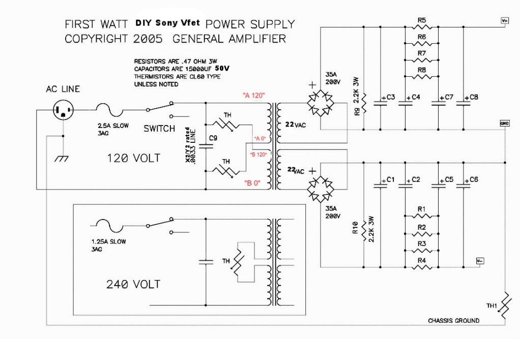

Putting aside Jlithen's spectacular build - what kind of power supply capacitance are people going with? I have 2 x 20,000 80V caps I can use (one for each amp module), but perhaps I need more....?
Mr. Pass psu schematic show 4x 15000 uF = 60000 uF for one channel.
Smaller capacitor value first after rectifier bridge,
the biger ones install after resistors in case if you have two different capacitors values for this build.

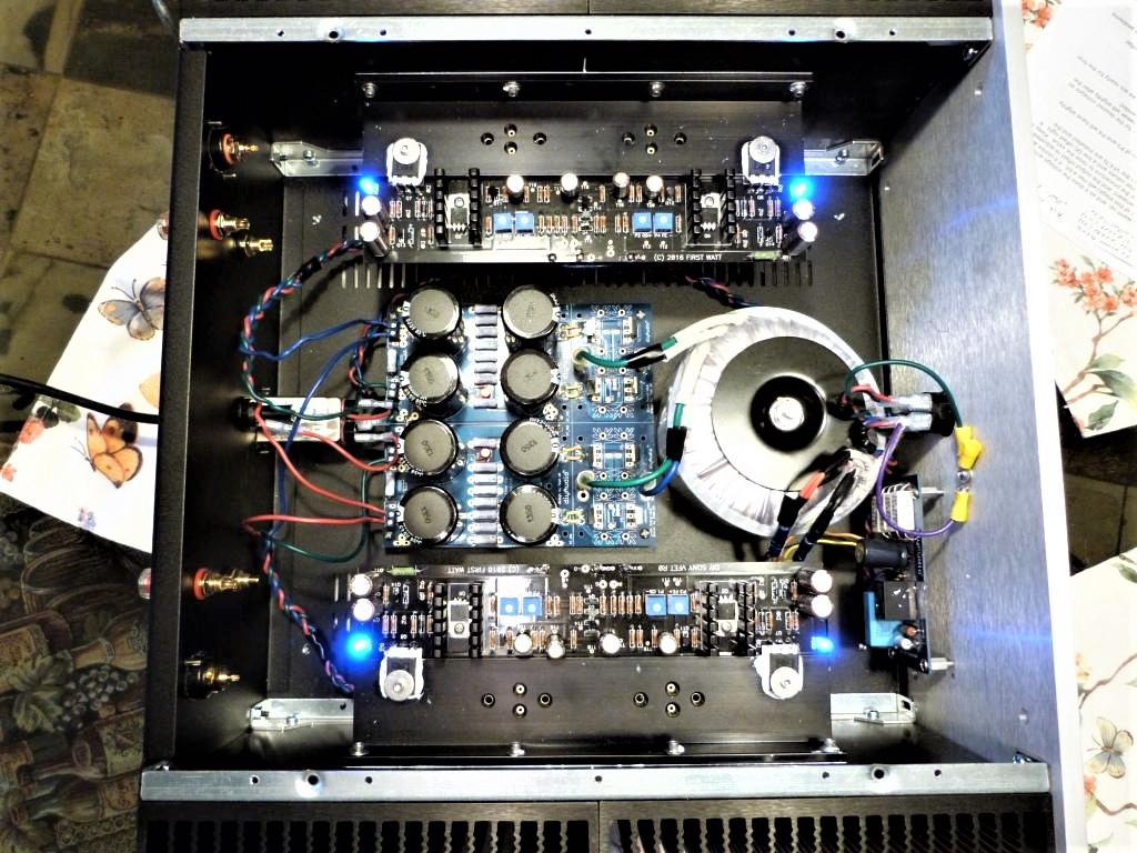

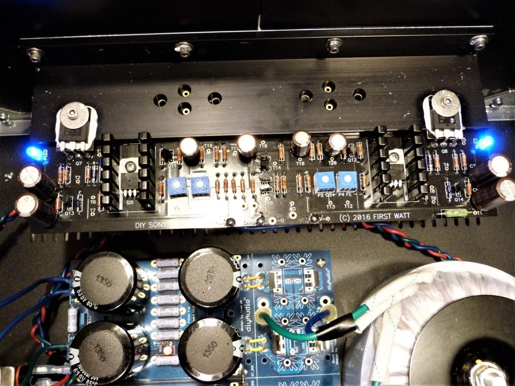

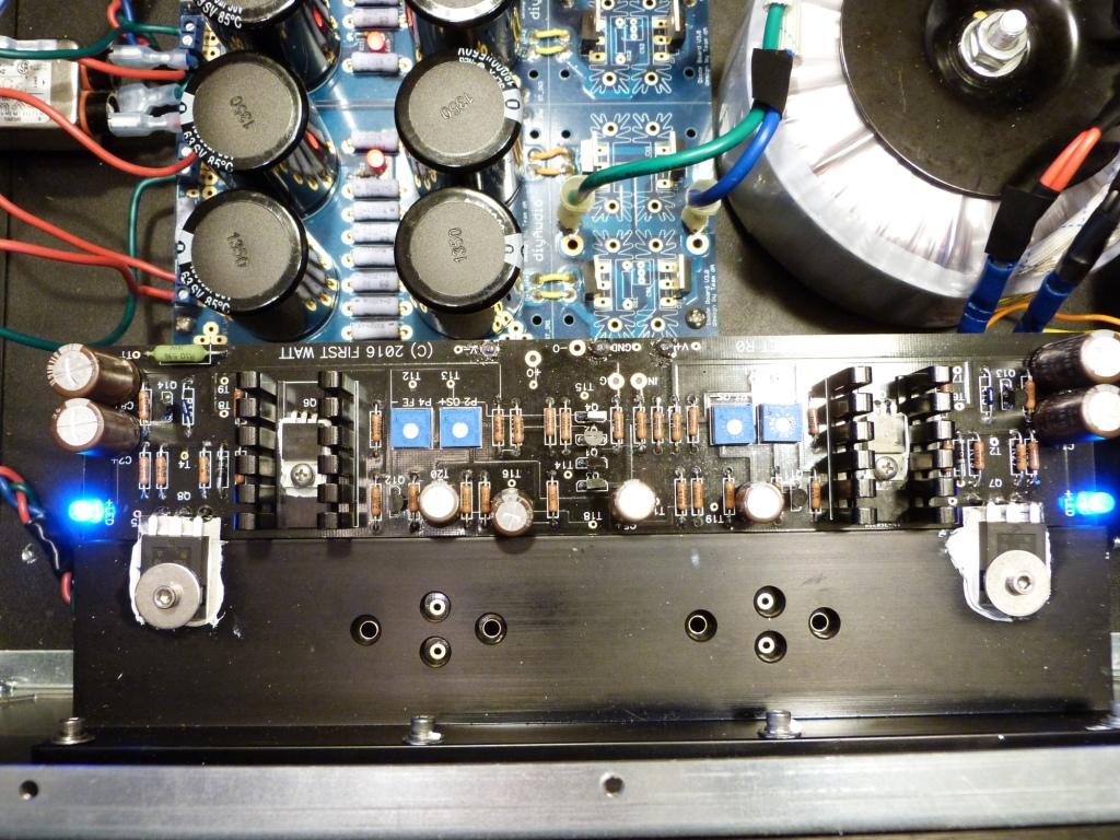

Hi Folks,
I'm finally nearing the last hurtle on my build but I think that I may have an issue with offset. I ran through the resistor checks in accordance to Nelson's instructions, no problems everything checked out fine. Then I went to the next step to check the voltages, everything also checked out fine. I moved on to bias up the front end and was able to set P1 and P2 to match the VGS of the transistors, in my case the 2SJ28 was marked 117, so adjusted to get 12.7v across T16 to gnd. 2SK82 was marked 97 so adjusted P2 to -10.7. I was able to get 1.5v across R5 and R6 and everything was stable for about 1 1/2 hrs. But the offset between P18 and gnd on the right channel was 1 v and on the left channel was -3.3 v, so I'm thinking something must be amiss. All parts are from the DIY audio kits. Here are a few pics of my build. Case is 400 mm 4U, trafo is Antek 400VA, psu is DIY audio. I'd appreciate any thoughts.
Paul
Paul

Yes, adjustment is needed. P18 is allowed some offset, but all 4 pots
need to be tweaked in rotation in half-way steps (or less) to converge on
the proper bias and minimal offsets at P18 and the output.
Just to clarify for everyone you have previously said +-200mV is no problem at T18.
No. Leave the output snubber empty.
Thanks 6L6!
Success ! After being put back on the right path I was finally able to bias up the front end and hit 70 MV offset ( t18-gnd). Very twitchy pots, it might have been a bit easier with 25 turn pots instead of the single turn ones though, but now the job is done. Hopefully I'll find time this weekend to install the VFETs and finalize things. I'll go dig out some cheap speakers for the maiden voyage.
Paul
Paul
Have a nice day
