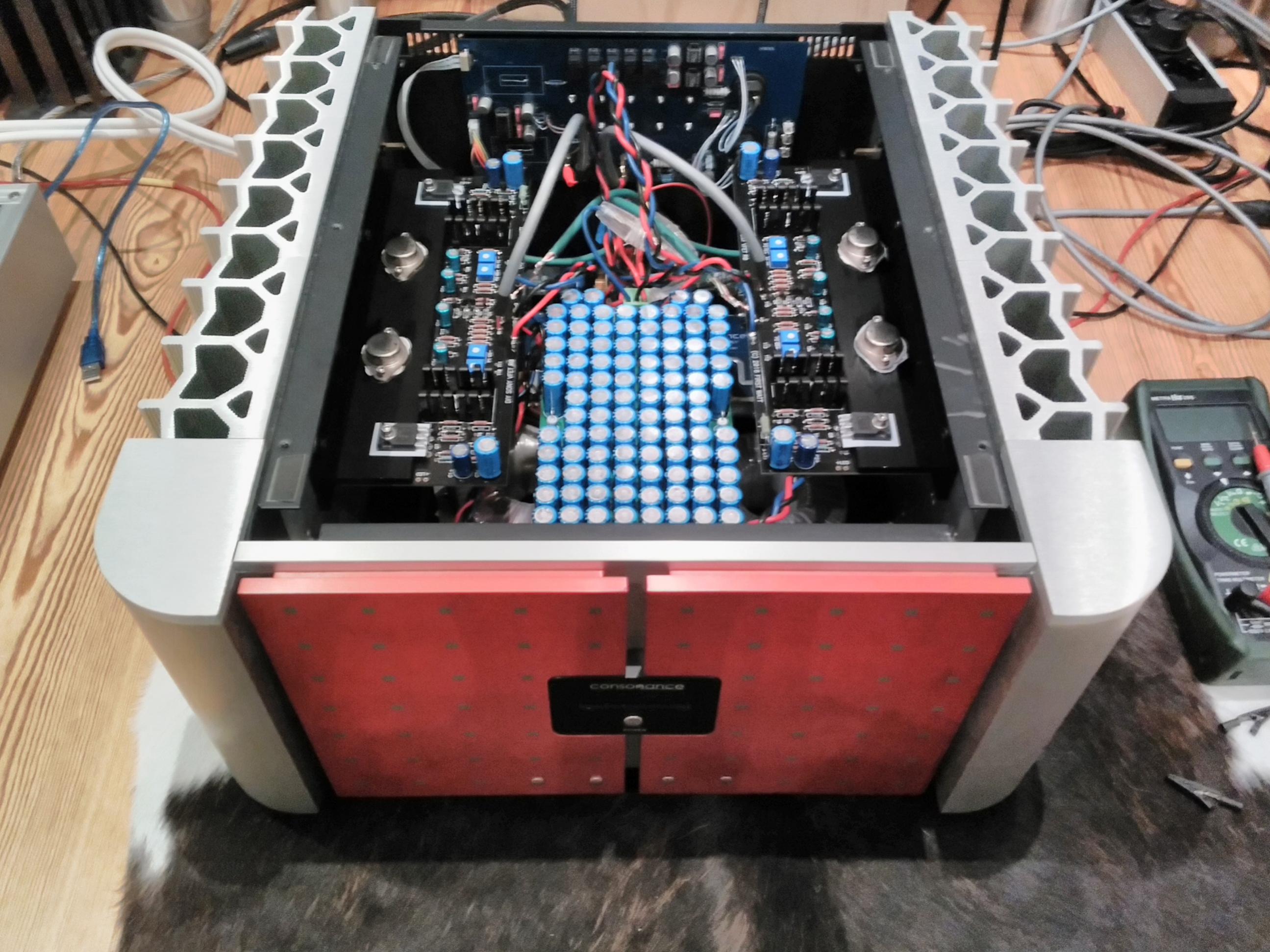

This amp runs pretty cool, almost surprisingly cool (green class a amp :-D by consuming at about 110 W). So it takes a lot of time to reach temperature equilibrium for final adjustments in the 4U chassis.
Looking forward to comparing it to my dear friend Jogi's F5....

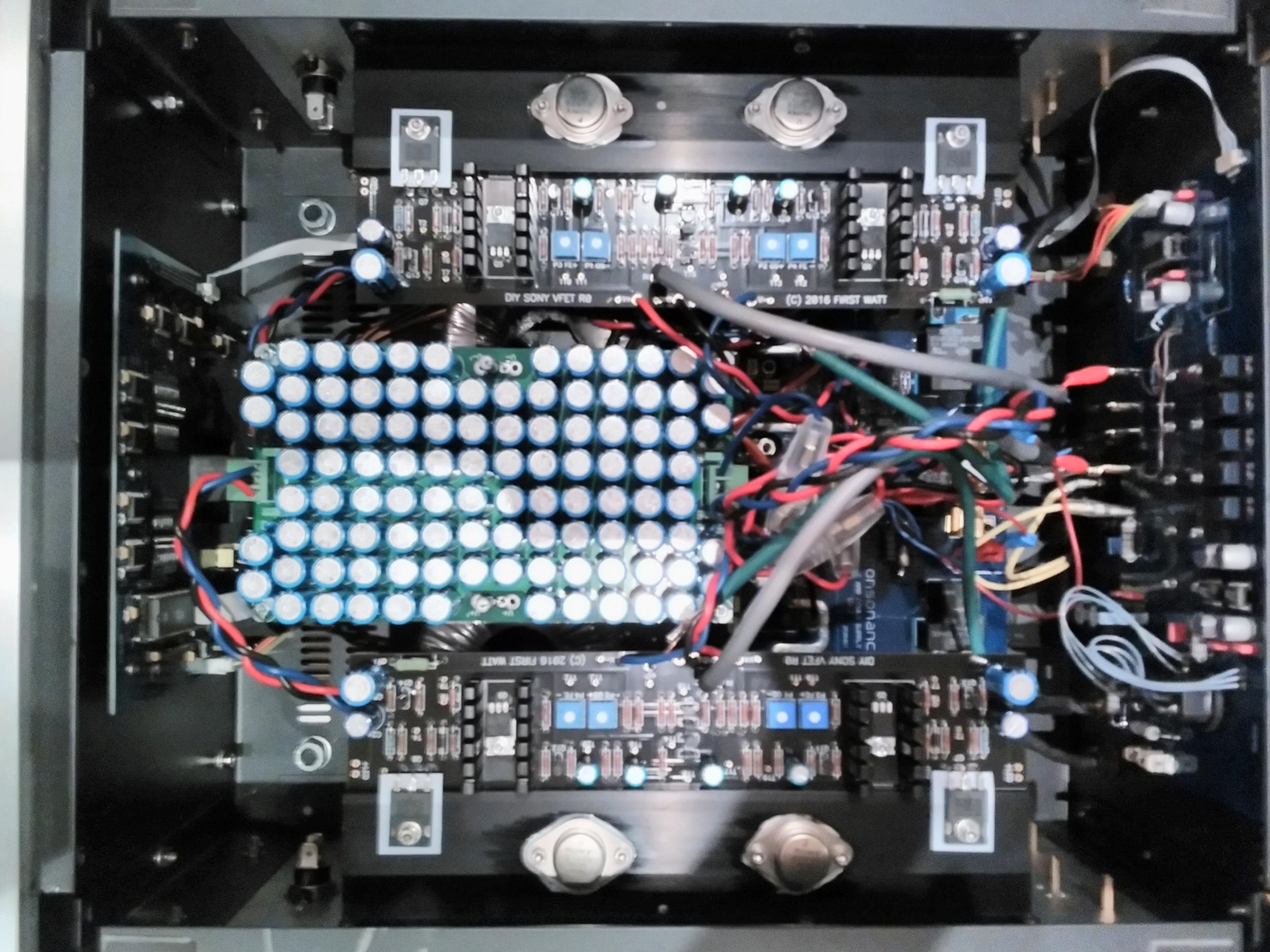

First 2 channels up and running!
Only changes I did were the resistors for the JFETs and also I was close to having to swp the 5k trimmers for 10k, but then I chose other VFETs instead.
I found bias easy to adjust.
Removed my DartZeel clone from one of my many Consonance Calaf enclosures and the Italian brackets almost fit in it.
I managed to fasten 3 screws without drilling more holes
No heat problems during 3h of listening.
I have two 160VA noratel trafos and 200pcs of BC 1000uF caps in the enclosure
Well enough.

I have like 0 noise, but some hum. I have wired the speaker - to powersupply ground and not amplifier PCB, so I will do some experimenting with this soon.

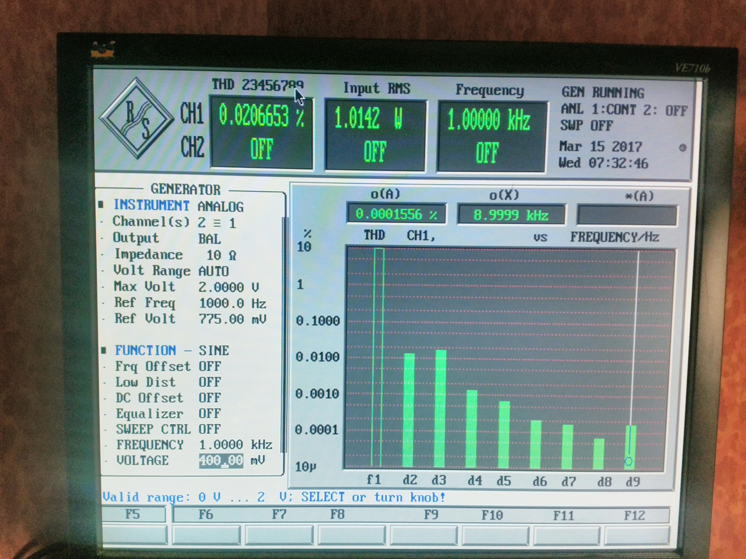

The measurement I have attached is actually at 3.5ohm 2W.
With the even harmonics included (I usually do not measure those) I get 0.02%.
This is good and I can make some proper measurements later.
