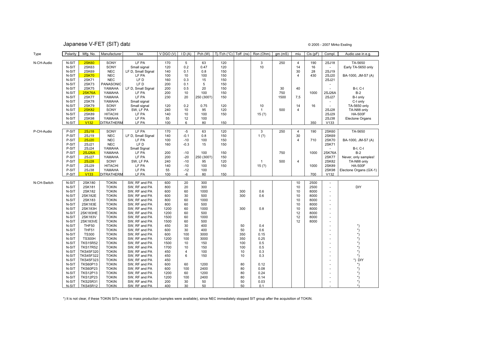

There is also a 2SJ25, Yamaha - 'complementary' of 2SK75. Quotes because it is complementary in the sense it's a P-ch VFET with the same maximum Vds, Id, Pd and same case, but mu is lower (about 25)

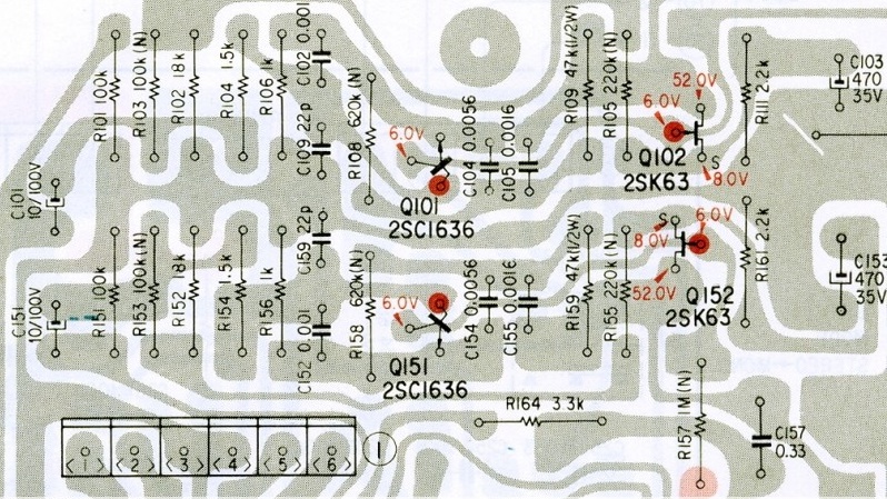

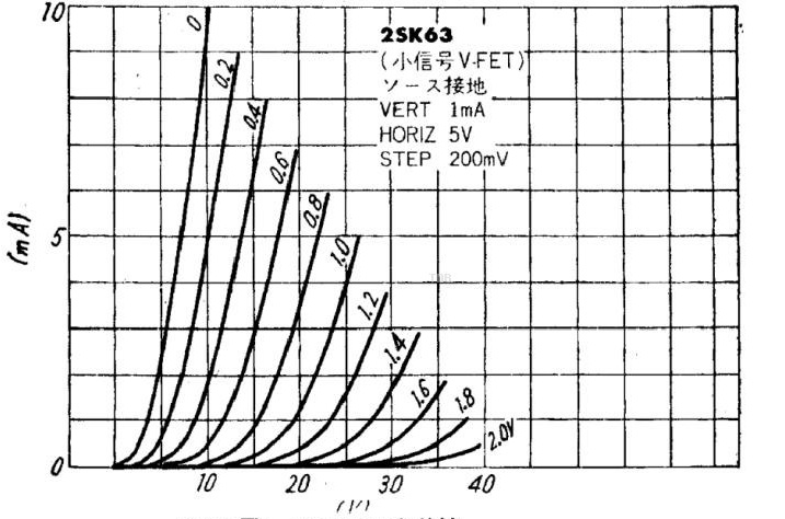

The smaller VFETs are even rarer and more difficult to get than the large ones. They can all be used witgib their spec for small signal amplification, just like small signal triodes - and yes, that certainly includes preamps. In fact, service manuals for both the Yamaha B1 power amp and Yamaha C1 preamp are available on the net, for some examples on what can be done.

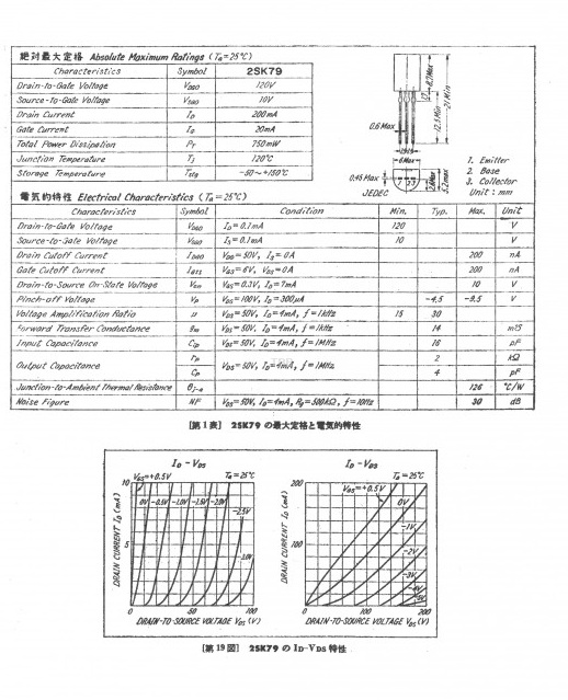

2SK79 are still sold in Japan and available on eBay. Not cheap anyway.The smaller VFETs are even rarer and more difficult to get than the large ones.

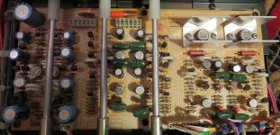

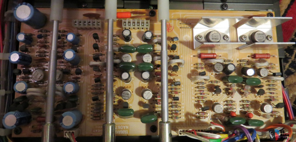

Old Vfet Yamaha and Sony amplifiers have aparently be made with small Sit's for preamplification.
This make me dream about complete Sit's signal path all like triode.
Have fun
Yamaha C-1 on thevintageknob.org
Have fun

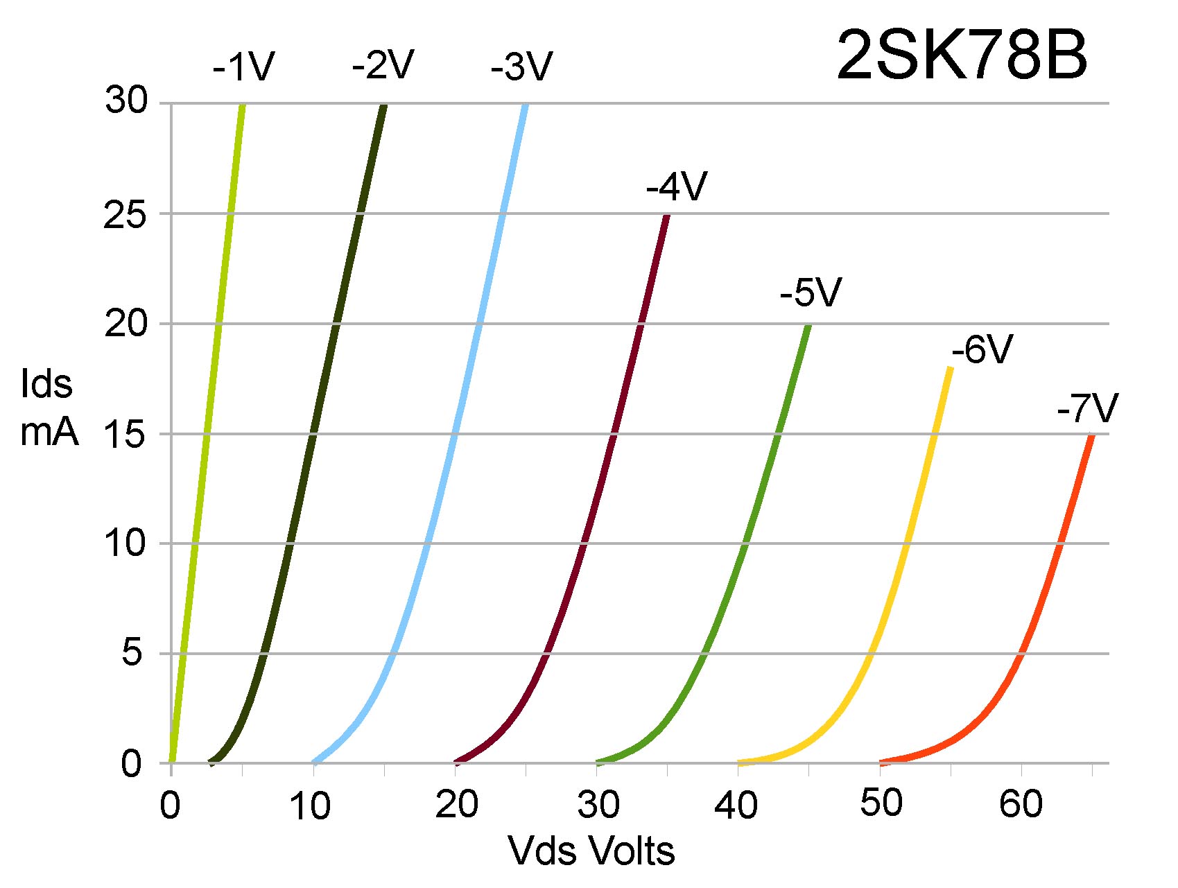

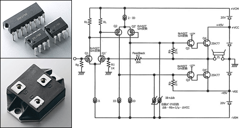

I have some samples of these parts:
2SJ78, 2SK78, 2SK278 (dual)
Oh ! Ahh !
Beauty grasshoppers !!!
ready to sings in front-end or preamp experimental topology garden ?
mystery

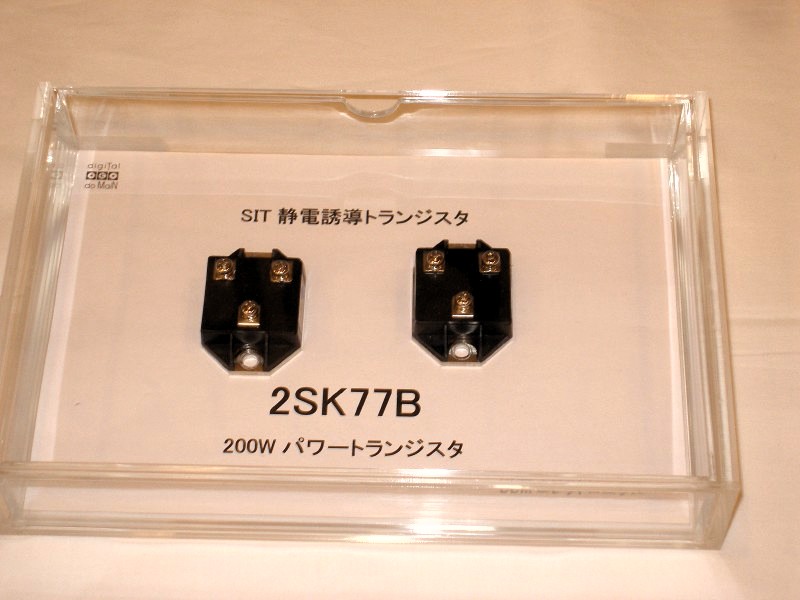

Something tells me these cost an arm and a leg
Somebody ready have try contact Digital Domain and ask availability of this SIT's ?
Have a nice journey
Mr. Pass would know, I think he mentioned it at one of the BAFs, as 'extremely expensive'
The amplifier they make is basically a Yamaha B1
