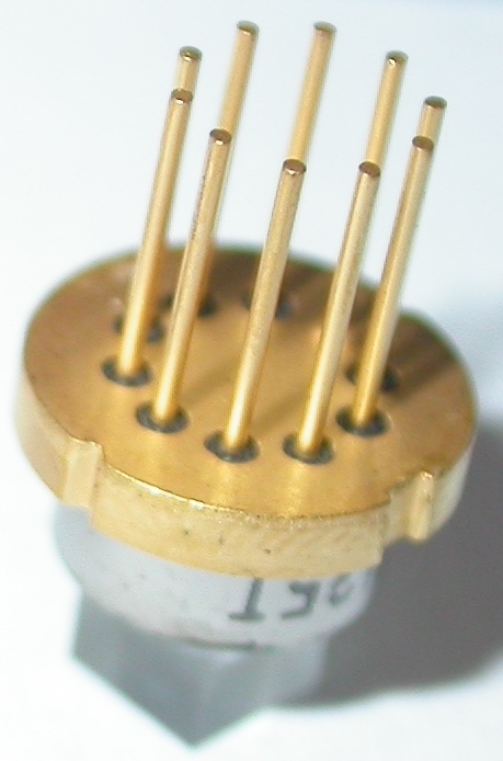

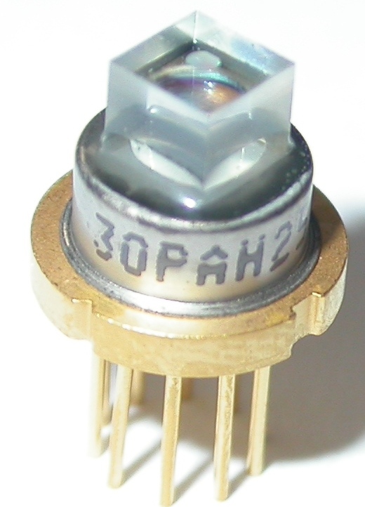

If I get packages both without any print or "Made in China", mostly the hologram laserdiode was faulty. If I get packages with "Made in Malaysia", "Made in Taiwan" or "Made in Japan", quality was still good (this was true only for the laser unit, so called "CDM12.4 Head" not for the complete mechanism/transport unit).
So I guess that the production facilities in Taiwan, Malaysia and Japan, was at the same time the former supplier to Philips or part of Philips itself.
The currently CDM12.4 exemplares comes now from China without marking and brand name. Therefore I want to have only the diodes as orig. Sharp part respective the successor brand - Sharp has discontinued all hologram laser diodes as you can read by the correspondence to Sharp - go to post' about
http://www.diyaudio.com/forums/digi...lt0h30pa-inside-philips-cdm12-vam12-mech.html
I even have contact with a supplier of a 800 pc LT0H30PA (LTOH30PA) packaging unit orig. Sharp (see attachement), but he don't send samples and the costs are 67 US $/pc at 800 pieces (arround 36.200 Euro + VAT and shipping - forcast/pay in advance - to make a replace by 800 pc. of cd player). Additional there are not to find a data sheet; datasheet of a similar type you will find there:
http://www.datasheetcatalog.org/datasheet/Sharp/mXqxuqy.pdf (LT0H12M)
http://www.daisy-laser.com/products/CD/mechanisms/VAM1202/gh6c005b3_e.pdf (successor of LTOH30PA, new outline, so called "resin" package instead of TO, used in VAM1201/1202/2202 and many more, but not in VAU1254/CDMpro2LF - there are still TO-versions inside as you can see at the photos)
LT0H30P datasheet and Application Note, Data Sheet, Circuit, PDF, Pinout | Datasheet Archive (only short form data)
http://robot.ee.hacettepe.edu.tr/forum/files/20_laser200510_e.pdf (Overview)
The main question for me is, who is the currently supplier brand for the hologram laser diodes inside in the still (by daisylaser) available CDpro2 (VAU1254) units?
Your mention problems regarded the "blue" nylon gear for the skip/search function and the opposite magnetic polarity by the grey and black platters (motor pulley/turntable) for me are completly unknown. I have heard about this from guy's, that have still replace the whole compact disc mechanic (CDM). But for me this replace procedure was too complex, so I always just moved only the optical pick up itself.
