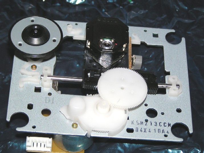

KSS-213 comes in A,B,C types. Not sure whats the difference.
The Rotel RCD-971 (mine) and the newer RCD-02 uses the 213C.
I get to buy the whole KSS-213CCM assembly for less than US$15 here.

Try to repair the old assembly before considering buying a new one since they are so hard to find. Hopefully, you will be able to get another CD player that uses the same mechanism as yours for parts. I get all my parts except motors and optical pickups (unless good) from "donated" equipment.
First of all, check the motors. Inspect top bearing for wear (bottom bearings are probably not exposed). If okay, clean and lightly lubricate (only if it is needed) using lightweight oil on both sled and spindle motor. You only need to use a little! Using a toothpick with some oil on it makes it alot easier.
Next, remove, inspect for wear, and clean all gears for sled mechanism. When cleaning the gears, use a old toothbrush. This helps alot especially when cleaning the teeth on the optical pickup. It will be good as new. While the gears are out, clean and lightly regrease (silicon based) chrome bar. Afterward, manually check for smooth movement of pickup.
Finally, lightly regrease (silicion based) all gears and again check for smooth movement of pickup.
I have also read some pickups can be cleaned internally.
I need to point one last thing out. After in-depth research, some older cdplayers (some new ones also) cannot properly read extended play discs. It has something to due with the gearing ratio in the sled mechanism. This explains why my newer portable Panasonic CDP and my older Aiwa 3 disc CDP have similiar problems with the same disc. My DVD player on the other hand, reads the disc perfectly.
This is because DVD players need a different gear ratio to read the tracks (DVD has a much smaller track width than a CD). Extended play discs can have a (not always) slightly smaller track width to fit all the needed info on the disc.
Sled motors can only move so slow. The gear ratio can make or break how accurately the pickup reads the data. My CDPs do not mess up on the end track. It can be anywhere on this disc. I just wish it wasn't on my favorite disc: Roger Waters In the Flesh (big Pink Floyd fan).

I agree, my experience are similar but one cannot completely generalized. The reason for this is also of interest. Have a look to page 37 of the datasheet about KSM213CCM (see attachement):
You will note, that three different laser diodes there are in use:
1) SLD104U or SLD104AGL, not to find about
SONY datasheet pdf catalog
I have found datasheet only about the successor type:
http://www.datasheetcatalog.org/datasheet/sony/a6802787.pdf
2) ROHM RLD78MA
http://www.datasheetcatalog.org/datasheet/rohm/rld-78ma.pdf
3) LT022MS
(see attachement)
If you have an exemplare with laserdiodes about No 2 and No 3, you have a long live version
All laser units (so called "optical pick up") that have inside the SLD104U, are short live versions, even the complete optical pick up is an other brand than Sony. This I have find out about the SF91 (SF-91) from Sanyo. All SF91-exemplares that I had to replace (I have make the authorized service for the older Cambridge Audio models CD-4, CD-6 and CD-T/Discmagic), had inside Sony's SLD-104U, while other SF-91 exemplares, who still perfect work until today (after more than 10 years), had inside a RLD-78 laser diode version from the brand name Rohm.
