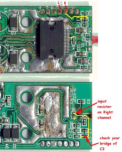

It´s the right channel that does not work.
And by the way. Measuring from the amp side of the input resistor through the cap to the amp side get this result Left: 154k Ohm, Right: no connection - infinity. Nothing even close to the 20k you menthioned. Amp side of the input resistor must be the same as input side of the input cap according to my schgeme and the first Audio1st drawing
Masuring the resistors they are both fine 21,8k.
By the way (again) the only running channel does sound a LOT better even after just less than an hour of playing than from the beginning . Strange!!!
These caps do need to settle...
If you took your measurements from the the picture below then you just need to back-track down the trace to find the break...easy!
I'll bet it's the C3 bridge or the connection at the board.

C3 it is! ! ! !
0,0 all the way to the bridge at C3. But from the bridge to R1 it´s 1 (infinity) on the mm. So it´s the amp side of the C3 bridge that is not working, the one that i had problems with.
Should I use a sharp knife to scrape on the trace to find something to solder on close to the C3 to make a new bridge, or should I just try to solder a thin wire from the bridge to the input side of R1 (if that is possible to on the SMD)????

Still no red led but there is sound YES ! ! !
Took away the C3bridge and managed to scrape on the track close to the C3 so I got the posibility to solder a tiny tiny little piece wire to it and then solder on the side that was ok soldered the prevous time. And then mr Lostcause there where 20k and nothing else as You said, from the amp side of the input cap to the amp side of the input resistor. Thanks for all the help, really appr it ! ! ! !

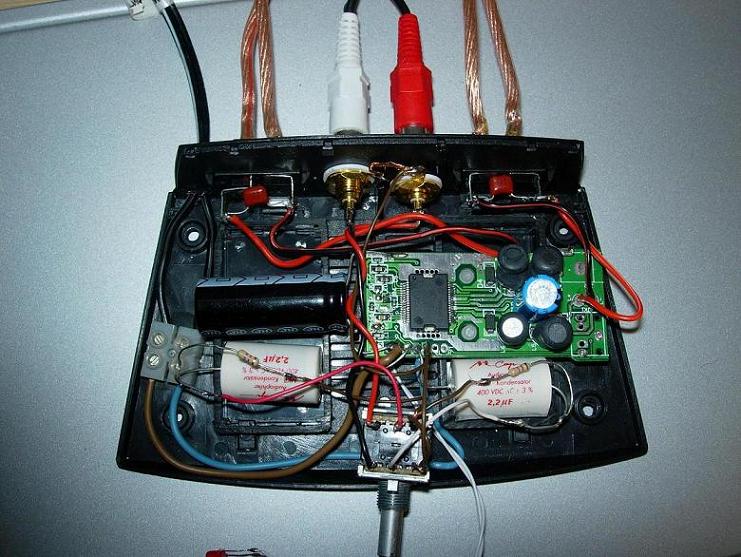

So now on to the next amp. My son Oskars T-amp. This time I will try to put parallell 470uF C10:ns (on top and on bottom) and parallell 5600uF as stiffeners to se if there will be any difference. What would I expect guys?
This is it, standing on the CD burning in and waiting for a new blue led, the shell and the new aluminum knob.

After another hour - It´s really amazing how good it is the little thing. Donald Fagens Morph the Cat is absolutely fantastic on that little piece with Axels simple homemade Voight horns connected to it.
It has a much more open, bright and clear picture, with an absolutely vonderful base now after a few hours of playing. It seems to fit the speakers so well, fast and stable all the way down to lowest base. You can really hear where the speakers quit, which I guess is down to 40Hz something when I think of it.
I might give the little thing a try with my Thiel speakers tomorrow to se what that will give. My guess it will alright up to nrmal levels of sound and then problems as they are not very easy driven and the room is about 40 sq mtrs. But we´ll see.....
