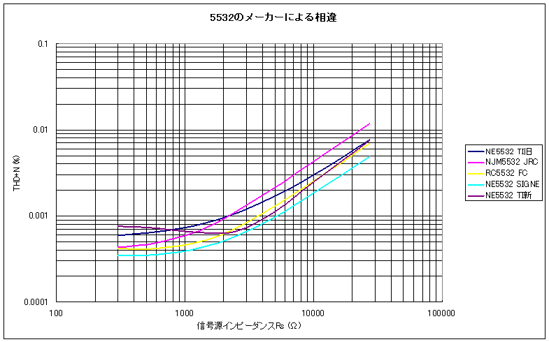

One of the 1st things I did when I got my UPV was compare THD+N of the Ti NE5532 against the Signetics. I had read on various groups such as this that the Signetics part was supposed to have an edge, but like any claim I read without proven stats to back it up, I was not expecting to see any difference and suspected it to be an urban myth. I was wrong. It was many years back, and I'm not sure where I put the data file, but the Signetics part had a very slight THD+N advantage in the circuit I compared them with (low gain and low input Z - difference was tiny, like 0.5dB). We're talking about artefact at well under -100dBv, so there is no peer-reviewed A/B/X-tested science to suggest that human hearing will be able to hear the difference. If I could get the Signetics part I would. Not because I think anyone will hear the difference, but I think better specs on an audio item suggest that the builder / OEM has integrity.
It seems that the measurement was made at low gain, so I think the influence of common mode distortion is large. I am also comparing 5532 from each manufacturer. This data was measured in 2008.
Measured at 20kHz, 5Vrms at G=+1, RL≒6kΩ.
It is written in Japanese,
This is a translation of the Japanese part and some notes.
”5532のメーカーによる相違”   → Differences between 5532 manufacturers
NE5532 TI旧 → NE5532 TI old (manufacturers Around 1981)
RC5532 FC → (It says FC (Fairchild), but it may be Raytheon.)
NE5532 TI新 → NE5532 TI new (Although it is ”new”, it was measured in 2008.:))
信号源インピーダンスRs (Ω) → Signal source impedance Rs (Ω)
It is true that the SIGNE has low distortion.
However, with SIGNE, I have the impression that the distortion increases the most when the load is heavy (like 600Ω).
"However, with SIGNE, I have the impression that the distortion increases the most when the load is heavy (like 600Ω)."
I would think that is true for ALL of the devices, not just the Signetics. Rather moot for my applications, however, as I don't have any instances where the load is 600Ω. I'm stickin' with the Signetics, IF I can find 'em!!

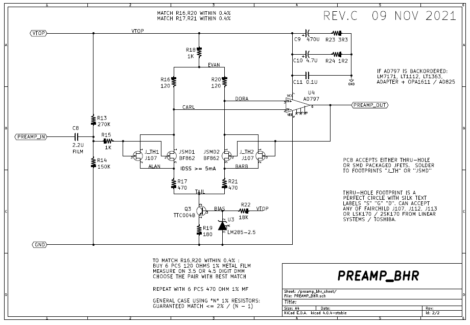

I paired the discrete JFET front end with half a LM4562 as an amplifier stage and the other half for a regulator.
Ah, that's what you were doing! I must go back and have another look when I have got time to concentrate, especially on the common base part where I couldn't really work out what the collector load was. I also didn't really see any actual "regulation" going on. No Vref being amplified, just some filtering. Incidentally, I'd also spotted what great parts those ZTXes are and was going to buy a stock of them, but here in the UK I can't find the 851/951s, only the 853s, which are slightly worse.
