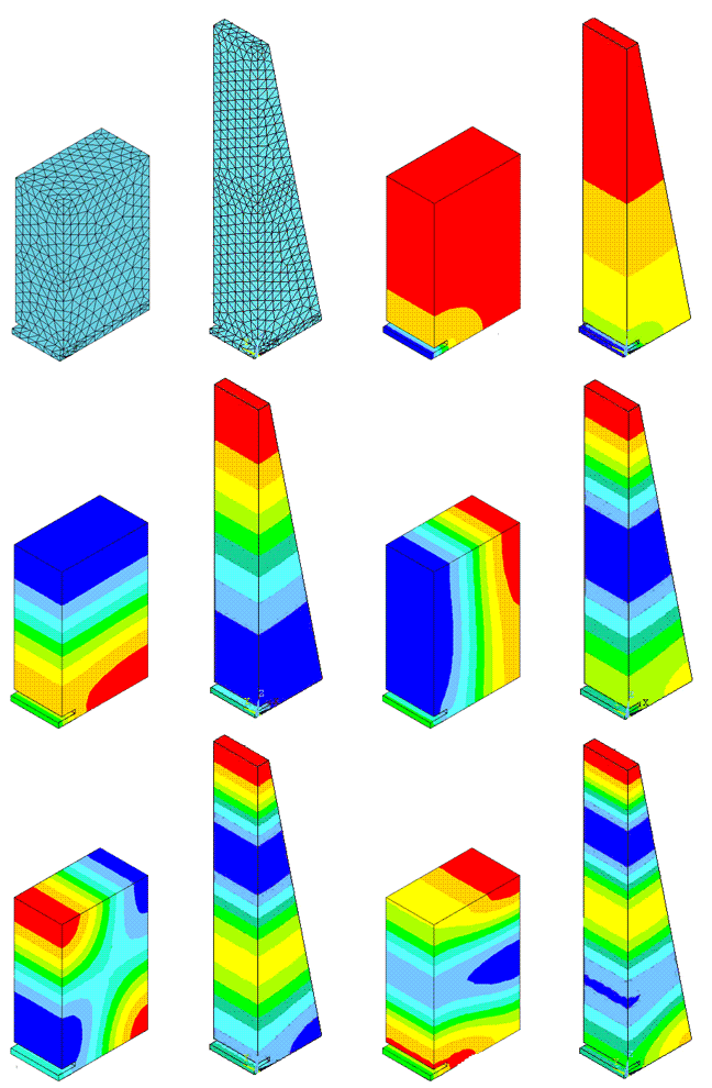

There are an aweful lot of tall-skinny floorstanders that were originally concieved as bass-reflex with the port at the far end. When these were built, amazingly the designers found that they had to retune the box -- and ended up with more bass extension -- to make the measured response what they wanted. Inadvertently they were building an ML-TL, but still called it a BR.
Martin in his ML-TQWT article has some ANYS sims that clearly show the dramatically deferent behavior of an ML-TL vrs a box of the same volume with dimensions closer to cubic.
dave

Dave, pardon my ignorance, but what exactly do the colored pix represent and from where is it sourced?
They're acoustic finite element models seen in Martin King's Project 2 ML TQWT write up: the 2.11mb pdf file is here: http://www.quarter-wave.com/Project02/ML_TQWT.pdf
Of particular interest to you will be pages 14 - 15, and Attachments 1 & 2 at the end of the file. The different colours in the picture Dave extracted from these show the different natural frequencies mode shapes, & normallised pressure distributions at work in (in this exemplar case) an ML TQWT and a BR cabinet of the same Vb and vent CSA / length. The linked pdf has the colour key & tabulated data with the drawingas, as well as a discussion on the aforementioned pp.14 - 15.
Jack,
You can find those plots attached at the back of my ML TQWT article. They were generated by modeling the air volume with acoustic elements using the ANSYS finite element program. Basically, they show the pressure profile of the different standing waves that exist in the two types of boxes at the applicable resonant frequencies. They are normalized mode shapes so the absolute value of the pressure is not presented, the relative values of the pressure at different positions in the box is what is being shown.
Also from the plots you can assess where the velocity maximums and nulls are located in the boxes. At a pressure maximum the velocity will be zero. Where the pressure is zero the velocity will be a maximum. Look at the output of the port (borrom front edge modeled as a slot) to see where the velocity is a maximum in each of the fundamental frequency plots. In the higher frequency plots there will be velocity maximum and minimums inside the box.
