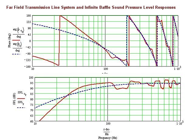

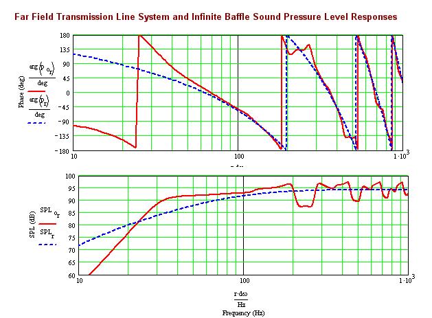

As some of you might know, I’ve been testing a new version of Martin King’s MathCad worksheets, and I’ve learned a heck of a lot in the process about an enclosure’s behaviour in both anechoic and in-room conditions. Whilst this was related to reflex and MLTL enclosures, much is also applicable to other enclosure types too. As such, I thought it was finally about time I went back to looking at Thor, as I wasn’t happy about some of the original models of the enclosure response graphs I originally came up with –too rough and ready, and I’m now in a better position to interpret the data. So several of the originals will be tweaked, or look very different.

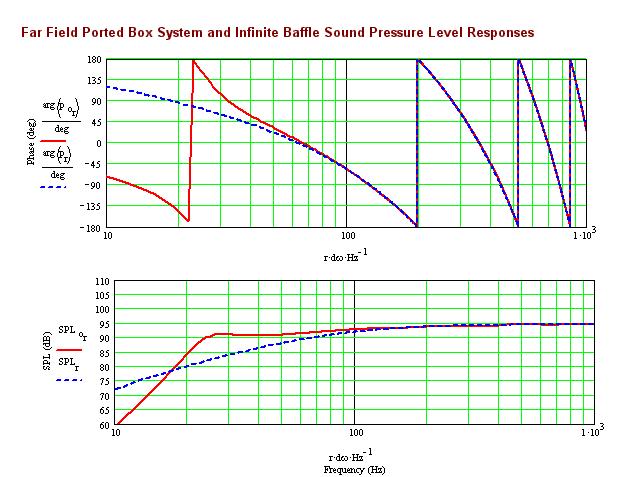

This is my definitive graph of the original Thor’s anechoic frequency response. I thought I’d generate that before I went back to the text of the original article and do a little compare and contrast session, so to speak. To be thorough, this is what was entered.
The worksheet was TL Offset Driver. Driver T/S parameters were those found in the article, with Sd and Vas doubled, and Re and Lvc halved in accordance with the procedure detailed on Martin’s website to account for the twin paralleled drivers. The theoretical driver centre-point was taken as being located at the centre of the tweeter, this being an MTM system, 10.25” down from So. Line-length was 81”, So=1.584Sd, Sm=0.528Sd, the driver centre is 10.25” from So. 0.78lbs ft^3 of stuffing assumed.

Well, at least there isn’t much ripple. But that’s about all I can say for it. Considering the drivers used I would consider this to be a very mediocre response indeed. Well, let me rephrase that statement: take a look at the picture below. That’s the anechoic response of a sealed box with these drivers, So & Sm =2Sd, 40” tall internally, theoretical driver centre 10.25” from So.
Oh dear oh dear oh dear. Doesn’t look so good for the Thor enclosure as it stands does it? Lets go back to the original article shall we, and have a bit of a reconsidering session. I’m going slowly here, as I’m trying to keep things systematic in my own mind. I have no intention of raising every point that I would take issue with –I haven’t the time or energy to waste doing that, but these are what I consider to be the 5 most significant in this context.
1) It doesn’t exactly get off to a great start by stating that TLs are non-resonant enclosures. I thought they were quarter-wave resonators myself, but there you go. Nor do I remember Bailey, who coined the term TL using a tapered line for that matter.
2) ‘Using two mid-bass drivers exciting the line at slightly different points reduced mid-bass-ripple’. I asked Martin about this, as nothing in his work thus far gives credence to this notion, and I didn’t buy it. I shall quote from his emailed reply verbatim (hope you don’t mind Martin!) ‘I am not sure that this is correct. The standing waves in a TL are independent of driver position. The driver position just determines how much excitation is applied to each standing wave, for example a driver at 1/3 L in a straight TL will not excite the 3/4 mode and will still excite the 1/4 and the 5/4 modes but at a slightly reduced level. The most efficient excitation is at the closed end. My guess is that when I get the two driver TL worksheet running that there will be pluses and minuses for both one or two drivers. I don't see two drivers solving the ripple problem’.
3) ‘The resulting line produces a uniform 3-4db bass-lift from 110Hz all the way down to 20Hz with less than 1db ripple. The -3db point is 44Hz.’ According to MathCad, no it doesn’t, and no it isn’t.
4) Why use alignment tables and then wantonly throw away 1/3 the volume they state is required?
5) Shorting out one driver when measuring the enclosure effectively doubles the internal volume the driver sees. This will produce a different set of results to if both drivers were operating.

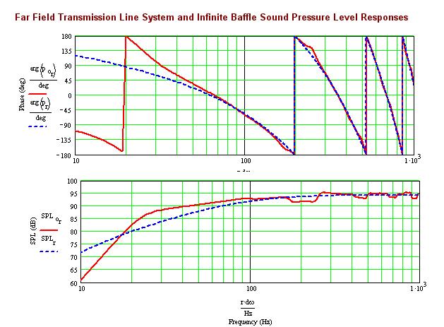

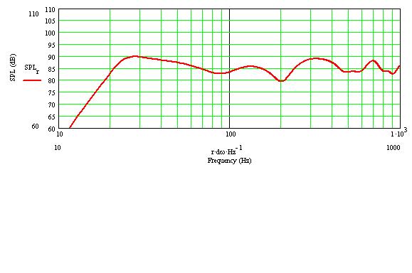

Ok, so we’re at the same point. What’s going on with this enclosure as it stands? Right, well, before we even begin to think of physical modifications to the enclosure itself, let’s look again at its response, and apply a bit of logic. What do we notice? Well, there’s very little ripple indeed. But hang-fire for a minute: this thing is using 0.78lbs ft^3 of stuffing, uniform, throughout the enclosure. Now, I don’t know about you guys, but I consider that to be excessive in the extreme. Stuffing is only there to damp out those higher harmonics that cannot be engineered out of an enclosure in the design-stages, right? It’s not there to correct other response aberrations. I have a absolute personal limit of 0.5lbs ft^3 of stuffing in an enclosure, and that only from the top to just below the level of the driver, not throughout the entire enclosure. I try to use 0.25-0.3lbs ft^3 if possible. More and the design wants a rethink in my view. What happens when we use too much? Simple: we damage the fundamental resonance that we were aiming to generate in the first place to augment the low end, inevitably causing the bass to slump, and the cabinet to behave like an aperiodic enclosure. There’s easier ways of building one of those, if that’s what you want!

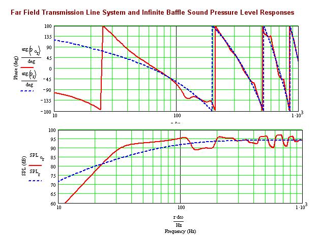

So, let’s try reducing the stuffing and see what happens to the response. Everything else remains consistent with the original design. This is the anechoic response of the Thor enclosure with a uniform stuffing density of 0.1lbs ft^3.
Instant conclusion: Augsperger’s stuffing advice is way off, at least in this case. Whilst very effective at suppressing the higher harmonic resonances, it has clearly grotesquely underestimated the effect such large quantities of stuffing has on the fundamental resonance. As you can see, the bass performance has shot up, though the response is rough (Voigt Pipe owners might think it flat!). I tried adjusting the levels, but there’s no happy medium here sadly. However, existing Thor cabinet owners who want some more bass but do not wish to build another enclosure: experiment with reducing the level of stuffing. Personally, I’d try removing the lot from the second half of the line as a first step, and play around with the levels from there. It could reap dividends, assuming you can cope with the increased ripple. As we key off peaks as a rule, our hearing being amplitude-based, you might not notice in your own room. Try it; you never know, it might work for you. The rest of us need a different approach however.

OK, so assuming we wish for some odd reason to stick with the ‘classic TL’, wide So, narrow Sm terminating in free-space geometry, we clearly need to increase the size of the enclosure. So lets revert to the original 0.78lbs ft^3 stuffing, and double the enclosure size and see what happens. So=3.2Sd, Sm=1Sd, everything else remains constant.
Well, it’s better than the original. Just. Not so hot for such a gargantuan enclosure in my view though.

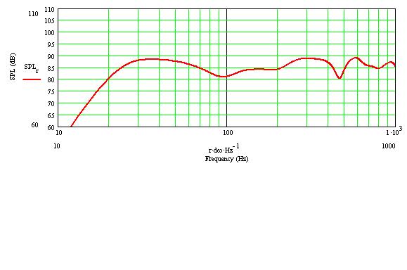

Now, here’s the same enclosure with stuffing reduced to 0.1lbs ft^3. That confirms it. The excessive stuffing specified cripples the fundamental. Of course, it also means that there is more ripple, resulting in quite a jagged response. Bass is sloping away, but that’s fine: one of the things I have learned whilst testing the latest version of Martin’s worksheet is that it is better to have a bass-response that smoothly falls away below 100hz than one that is completely flat. If you’re using a small driver, then a drooping response with a small peak at cut-off is desirable, as this will add weight to the sound, otherwise, a smooth roll-off, otherwise room-gain will come into play, and make for a bass-heavy response, 9 times out of 10. I tend now when working with the anechoic sheets to try for this slowly rolling-off response, or a flat response which I then adjust through altering the port / vent dimensions to achieve this.
I might as well state now that I can’t honestly see any good reason to use the ‘classic’ TL taper, especially when terminating in free-space. The more I work with the MathCad sheets, the more I find I stick with this view. A very high Q and / or Vas driver might be best in this sort of enclosure perhaps, I don’t know, I avoid them, but if that’s the case, they would likely be best on an open-baffle anyway, not a box enclosure.
However, we shall have a stab at an optimised classic enclosure for these drivers, before we try something a bit better, using Martin’s alignment tables and Offset Driver worksheet, which we know to be the most accurate out there. Dave has already drawn one, with the cross-section of the original enclosure doubled, the drivers moved to the position Martin’s tables determines to be optimal, and a floor vent, rather than a high-mounted one, which in my experience is always desirable, coupling better to the room.

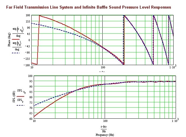

This is the ‘Fat Thor’ discussed, using 0.1lbs ft^3 of stuffing. Ragged over 100Hz, but the best bass performance of the lot, and with its floor-vent, this beast will THUNDER. Subwoofers will be quaking in terror. Jurassic Park soundtrack? Dark Side of the Moon? No worries here. By the way, you can get similar performance, with 4Hz less at the bottom end, by reducing the size of So to 2.5Sd and Sm to 0.5Sd. Yup, that law of diminishing returns has kicked in. Is that bit more on the bottom end worth such a gargantuan cabinet? Me, I would say not, but that’s up to you.

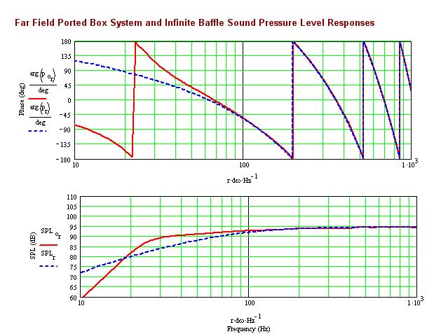

Here’s Small Thor, anechoically. So & Sm=2Sd. 45” long, theoretical driver centre 33.75” from the base. 0.5lbs ft^3 from the top of the enclosure to just below the lower mid-bass driver. Port 2” diameter, 4” long 4” from the base. Front port please guys: my experience in the in-room plots suggests that rear-ports are just looking for trouble. The port is narrower than I’d normally use, but Martin has added a useful little extra facility to the new versions of the sheets that provides a graph of the port velocity, and warns you it it’s going to exceed mach 1. Below that, you should be fine. You could use a 3” port that’s 4” long for a completely flat anechoic response if you wish, but you might well find that the bass-weight becomes excessive.

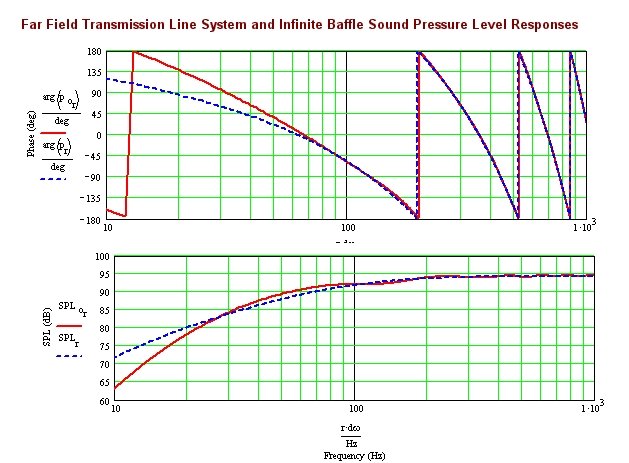

And here is the Small Thor’s predicted in-room nearfield response, sitting on-axis with the drivers, in a carpeted room, the front baffle a not-unreasonable 36” from the rear wall. I must admit I rather like it.
