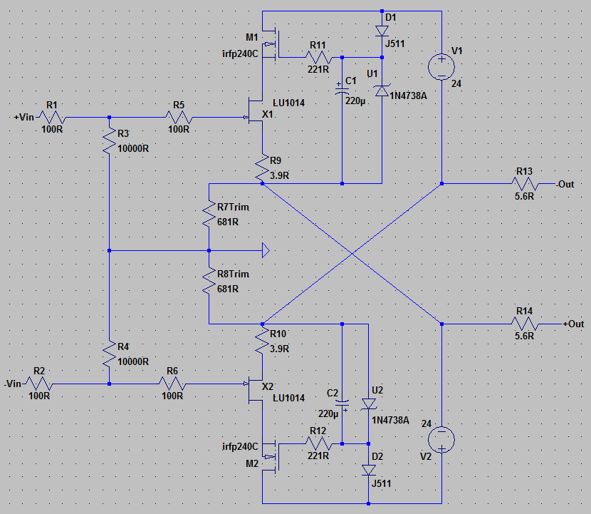

Someone sent me a PM asking for a circlotron DAO circuit.
Firstly one has to realise that one can only run a balanced headamp when one is prepared to rewire the headphone completely.
Most standard headphones come with a 3-wire cable (right signal, left signal & common ground).
This will not work with a balanced head phone amp of any type.
Only a few headphones, e.g. the AK701, comes with a 4-wire cable.
Yes, I have a circlotron DAO circuit, but you will no doubt also want PCBs, power supply schematics, layouts, case, ......
Since I don't have time even to get the single ended DAO realised, and most people would not want to rewire their expensive phones, the balanced version will have to wait.
You can of course study the standard circuit of any circlotron follower on the inet, and replace the active device with the top half of the standard DAO.
i.e. take the top half of the DAO 2x and place them side by side, and you are there.
As to power supply, you can refer to Mike's article, or the circuit published in the forum by Joachim Gerhard as background information.
Just use the search function.
Sorry to disappoint. I am aware there are also many people waiting for the standard DAO.
I can only do so much in my free time.
Thank you for your interest nevertheless,
Patrick

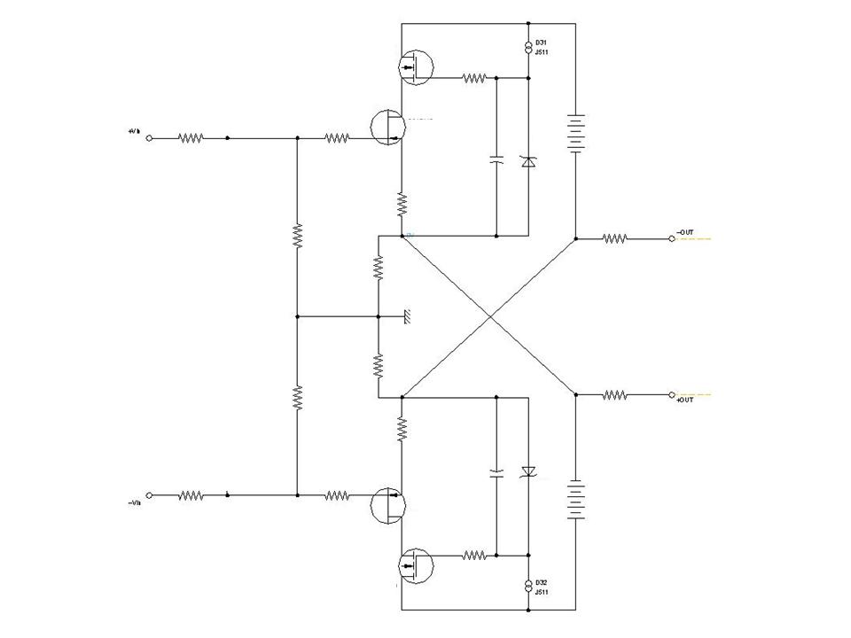

Hello all. Here is a try to make Circlotron scheme. Sure thhing I did many mistakes. Here are the questions. What direction should point J511 diode? And are the resistors values good and where the power ones are needed (3W for those 3.9 and 5.6 ?). Are trimmers in right place (assume they should be 1k pots)? Are connections for LU1014 and IRFP240 correct?
Schematic attached.
Best regards!
Alex
Schematic attached.
Best regards!
Alex
a) I cannot delete anything you posted. Only you and moderators can.
b) It is an old schematics a few years back about a balanced DAO with TCS.
It has not been built by me or anyone else, and today I shall not post such schematics again.
c) Since it is from an earlier post and hence can still be downloaded by anyone, I don't quite see the purpose of posting again here.
d) As I said already, I don't have time to support any balanced DAO project that any of you might want to undertake. Please understand.
Patrick

Patrick
Please delete if you consider this
I found it in my files as Patricks balanced Dao
Bob
Patrick
My apologies for posting a duplicate
I await your completion of the SE Total Solution
Best
Bob
No reason to apologise.
Just that I did not understand your motivation to post.
We'll let you know as soon as we make progress.
I know people are waiting.
Our sincere apologies.
Patrick
