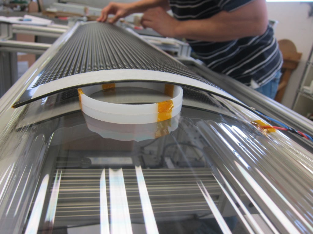

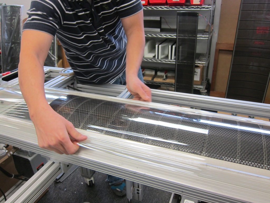

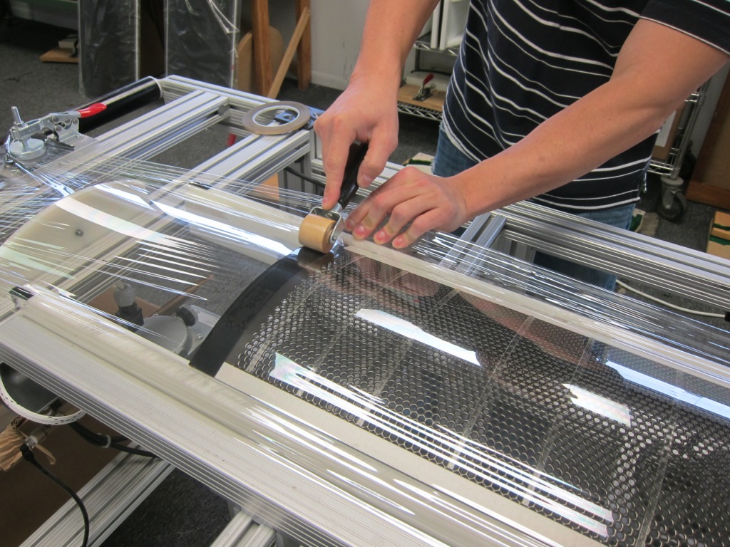

I'm still waiting for the .5 mil mylar to arrive for the woofer panels, but I decided to make up the two mid/tweeter panels this morning. I stretched the mylar on my inner tube jig to 1.5% and mounted both of the stator panels onto the mylar. Rubbed the edges with the foam tape along the perimeter and cut the mylar with a razor blade. Flipped the panels over to admire my work, and what do I see, wrinkles. The mylar didn't totally bond to the tape and the tension was released in some spots. So either I got some old 3M tape or I didn't rub down on the panels hard enough before cutting them from the mylar. Thoughts anyone?

You might be able to touch them up with a little heat.
Did you wipe down the mylar with solvent to remove any oils before you attached it to the stators?
I use denatured alcohol for this especially before you apply your coating to the Diagphram as well.
jer
No I didn't wipe them down but I will next time. Also, My workshop was only 60*F. Next time I'll run the heat gun around the tape before I lay it on the mylar. Do you think that might help?
Yes, That might work, I had always thought about doing that as well if I ever get the chance to use it.
Right now I like the idea of being able take my panels apart and re-assembling them again.
