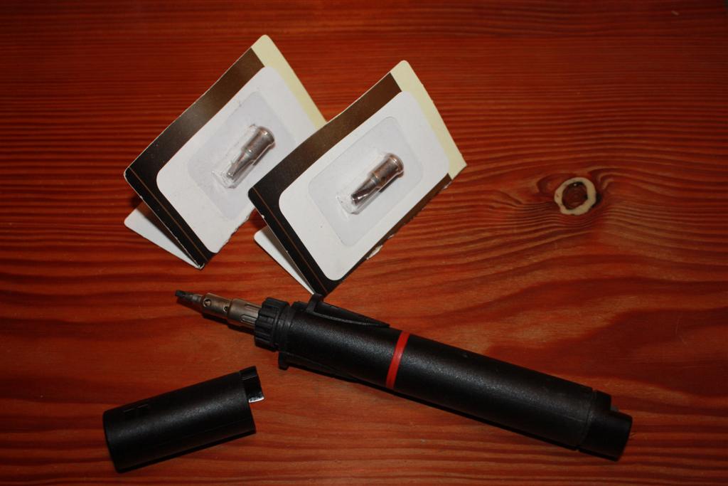

copper is used for soldering iron tip cores because its the highest economical heat conductor
it is also "soluble" in solder which gives the observed tip erosion - worse at high temps and with some solder formulations
better tips are iron plated to cut erosion - if you wear thru or abrade the iron plating then the tip quickly erodes again when the solder can get at the copper core
temp controlled irons are better because they use iron plated tips and because they can keep the temperature to just at the solder melting temp - unregulated irons get way hotter when just sitting in the cradle

I thought a modern long life tip was a bit more advanced
I doubt theres much copper in there
think about it
once you break the suface plating, it over
absolute impossible to solder, nada
if it was copper, that wouldnt happens so abrupt

Cheap irons have cheap tips. I remember using a tip made of copper or some other soft metal. Solder (or actually, I think it's the acid from the flux) would eat the tips. I'd file the tip to a point periodically.
However, NEVER file a long-life tip. As others have said, they're plated with a coating that is supposed to resist the acid, hence, last longer. Long life tips don't like to run "dry" though. Keep them tinned and turn the iron off when you aren't using it.
I'm still using the same Weller tip that came with the TCP iron I bought back in 1988. It works fine... But one tip probably costs more than that iron you've got...

The best advice I can give is after the iron has heated up, take a lightly dampened sponge and brush the tip on it until the oxide coating is removed leaving a shiny tip. Then melt solder onto the tip before using it. Leave it on only as long as you need and only as hot as you need.
After use, wipe it down on the sponge and tin the tip AGAIN. Leave the solder on the tip because this will protect the tip from oxidizing. It's quite alright it there is a large glob on the tip.

Have always used solder with rosin flux core all this while. Couple of months back, decided to get the electronic "flux" paste to apply on my PCB for tinning purposes. The "flux" paste I used ate thru one of my tips in a few sessions. Totally destroyed the long life tip.
The tin of flux paste now lies unused in some box. What a waste, wasn't cheap too.
Now I avoid these flux pastes and just use the solder to tin and clean my tip in combination with a wet sponge/paper towel.
