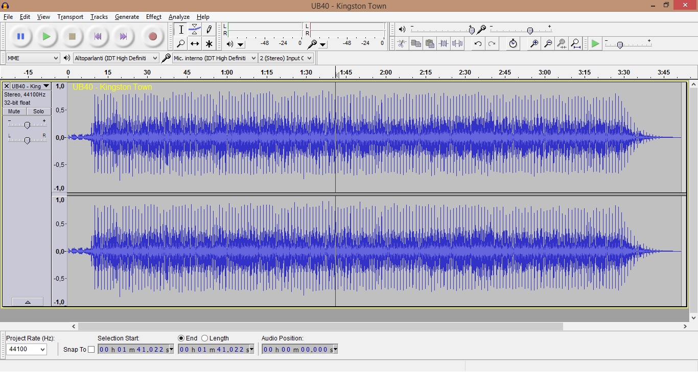

Just did it again to show here in the thread.
Here's a very dynamic track (DR16)
attachment.php

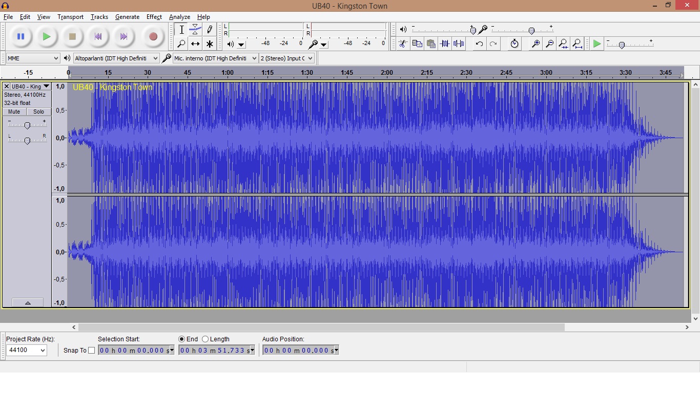

amplified by 10dB
attachment.php

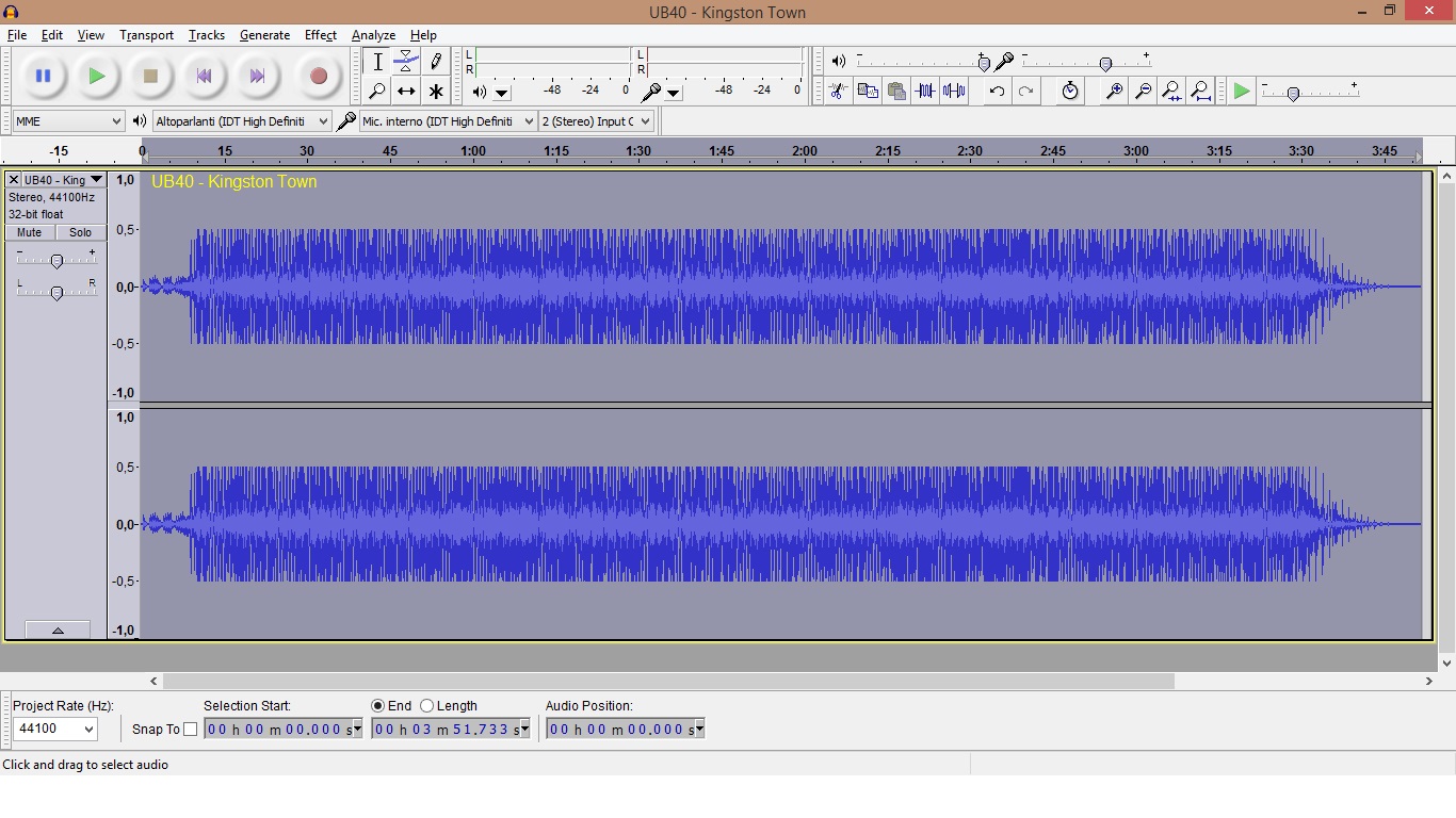

Amplified to -6dB, overs are still there, the software preserved it.
attachment.php

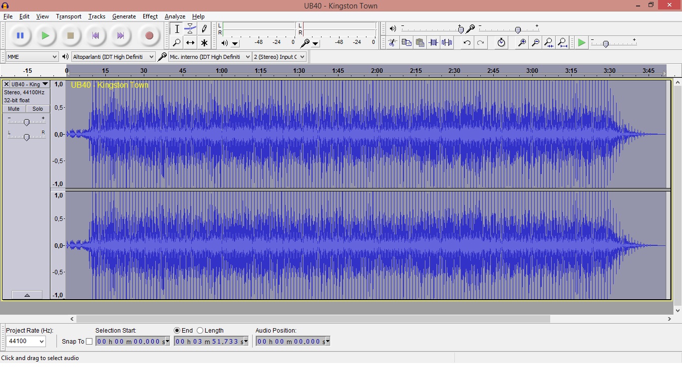

Then I've exported the track to 24bit Flac and opened it.
Amplified by -6dB, overs disappeared:
attachment.php

I don't think digital meters are made for floating point bit depth.
I think you're missing the point... digital meters means nothing here.
In digital there is nothing that can be represented over 0dB.
Let's say we're using 16 bit signed integer data, each sample is a number between -32768 and 32767.
-32768 and 32767 are 0dB, you can't simply represent 32768 or -32769, they simply will not 'fit'.
What you're doing is exporting to a format which represents 0 dB to a lower number than the maximum so that overs are preserved.
But the music you buy, even in HD formats, use the full scale of the sample so no overs are there, you can't simply amplify by a negative factor and expect to retrieve overs.
Even the editing software sends data to the DAC using the full sample resolution (so with no data over 0dB), otherwise you couldn't hear what you're actually doing on the final rendered data which will be sent to customers.

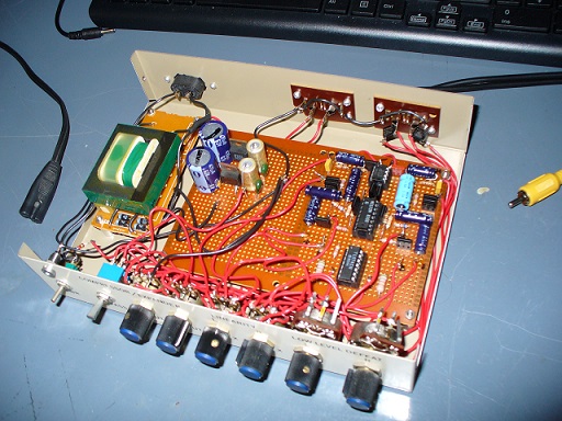

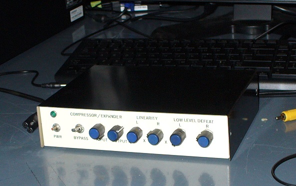

Reference was made earlier to the original DBX boxes (not the encode/decode noise reduction units). By the 80s Signetics had chips and (barely) enough diagrams and info to build something with them, which I did. I used the linear book regarding the NE570 chip (though I had the somewhat different NE572) and built one that worked so well I also built a knock-off while the memory was fresh in my mind. They work just like most any compressor/expander. The desired effect is applied by averaging the level of the signal over a given short time, comparing that to a zero-reference, and (depending on what's 'dialed in' on the front panel) mixing wet/dry signals to achieve the desired ratio of expansion (or compression). A low-level amplitude threshold is also dialable (to limit processing to levels above the noise floor).
Hi Deafuser, nice find! Looks like a 4-ch compander for noise reduction, probably for the simul-sync TEAC tape deck that was (sort of) popular for home recording etc. at the time. Looks like it's based on the NE570 (my thing's the 572). The article includes somewhat cryptic directions for using it as a compressor or expander rather than an encode/decode NR unit, but I think I'm glad now I used the Signetics book and wires! Probably cheaper too.

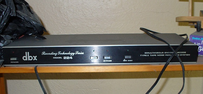

BTW I did home recording in that era, and the dbx noise redution compander units mentioned are familiar to me. The photos show one such 'home' unit using dbxII (whatever that meant), and the nearby remnants of some of the recording equipment which includes two 4-channel dbxI ('professional') NR units just over the Tascam 38 8-track deck they accompany. The results were crystal-clear and noiseless recordings (except for what I put on them).
The thing to the left of the dbxI boxes is the 'prototype' expander/compressor unit I made (obviously), essentially identical to the one shown in my prior comment. And yes, that thing on top of the stack is a real live Aphex Aural Exciter, Type C :) I got it at Sam Ash in NYC on one of my rare junkets there in 1986.
