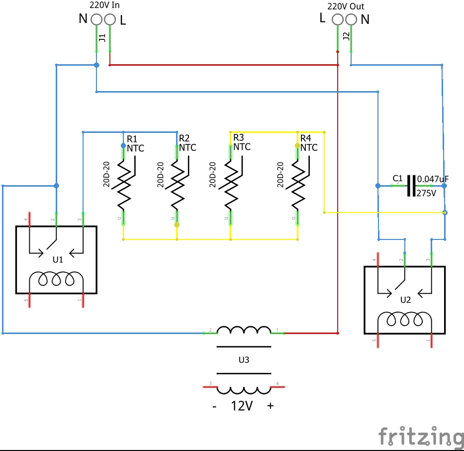

Hi
AndrewT
your diagram can't be right.
Uh oh..... I drew the circuit because what I am seeing on the board is not the same as the schematic posted by AJT. I have gone over it again and as far as I can see it is correct, what are you seeing that isn’t correct?
I am going to try a replacement cap to see if there is a problem with the original item but I am thinking about increasing the voltage because the house voltage is around 230 to 241V so I am concerned the original parts rating of 275V doesn’t leave room for much movement.

Hi
AndrewT
I am going to try a replacement cap to see if there is a problem with the original item but I am thinking about increasing the voltage because the house voltage is around 230 to 241V so I am concerned the original parts rating of 275V doesn’t leave room for much movement.....................
the harmonised voltage is from 216Vac to 253Vac for the whole of the EU.
275Vac is the standard X2 rated capacitor for use on the harmonised supply.
They do make an X1 rated capacitor for use on the three phase 400Vac supply, but that is not what YOU need for an ordinary single phase domestic supply.
Use the 275Vac X2 rated capacitor. It is designed to fail safe for upto 253Vac. And for the very short periods that the harmonised supply is allowed to exceed 253Vac.
Your new diagram in post74 looks better. Can't you see that post55 is different?
Look at the Live lead. It supplies only the little transformer, nothing else. It can't be right.
X rated capacitors are just capacitors.
Interference suppressors are a combination of resistor and capacitor built into one two leg package.

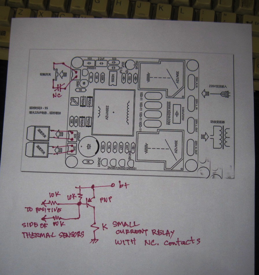

we are left with no other option but to use it as it is....unless
a relay contact in series with the start switch, normally closed,
that opens when the thermal switches are activated so that
pushing the start switch will not turn on the psu until the heat
issue dies down, this will add complexity but is doable....
i have attached a simple mod to make this controller not
restarting right after shutdown due to heat.....
another way can be designed to inhibit the start switch
for some time, another added complexity but still doable...
if we can imagine it, we can do it...
