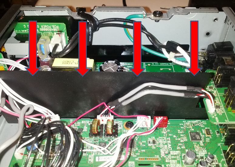

an SMPS emits emi.
That is why the regulators require them to pass emi tests before they can be retailed.
Most are inside faraday cages to help with emi. The PC smps is always inside a faraday cage even though they are also inside the PC case.
The wires into and out of the smps also emit emi. This is why we pair them off to attenuate that emi. It is usual to fit filters to both the input wiring and the output wiring of smps.
I opened up an very old Alcatel mobile phone. It had 5 or 6 little soldered closed boxes and when I opened one of these it had a second even smaller soldered box inside.
This is Acatel attenuating emi.

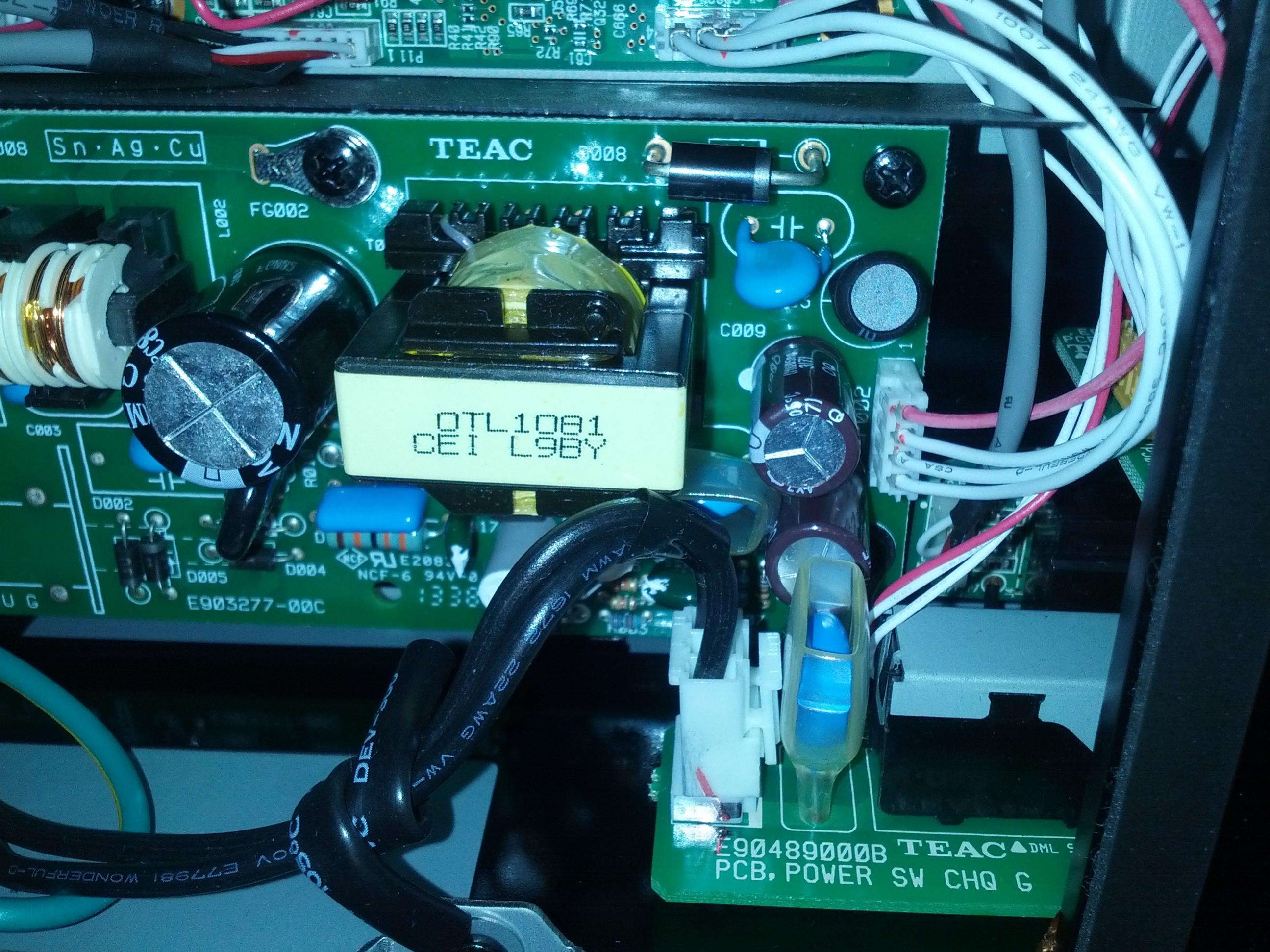

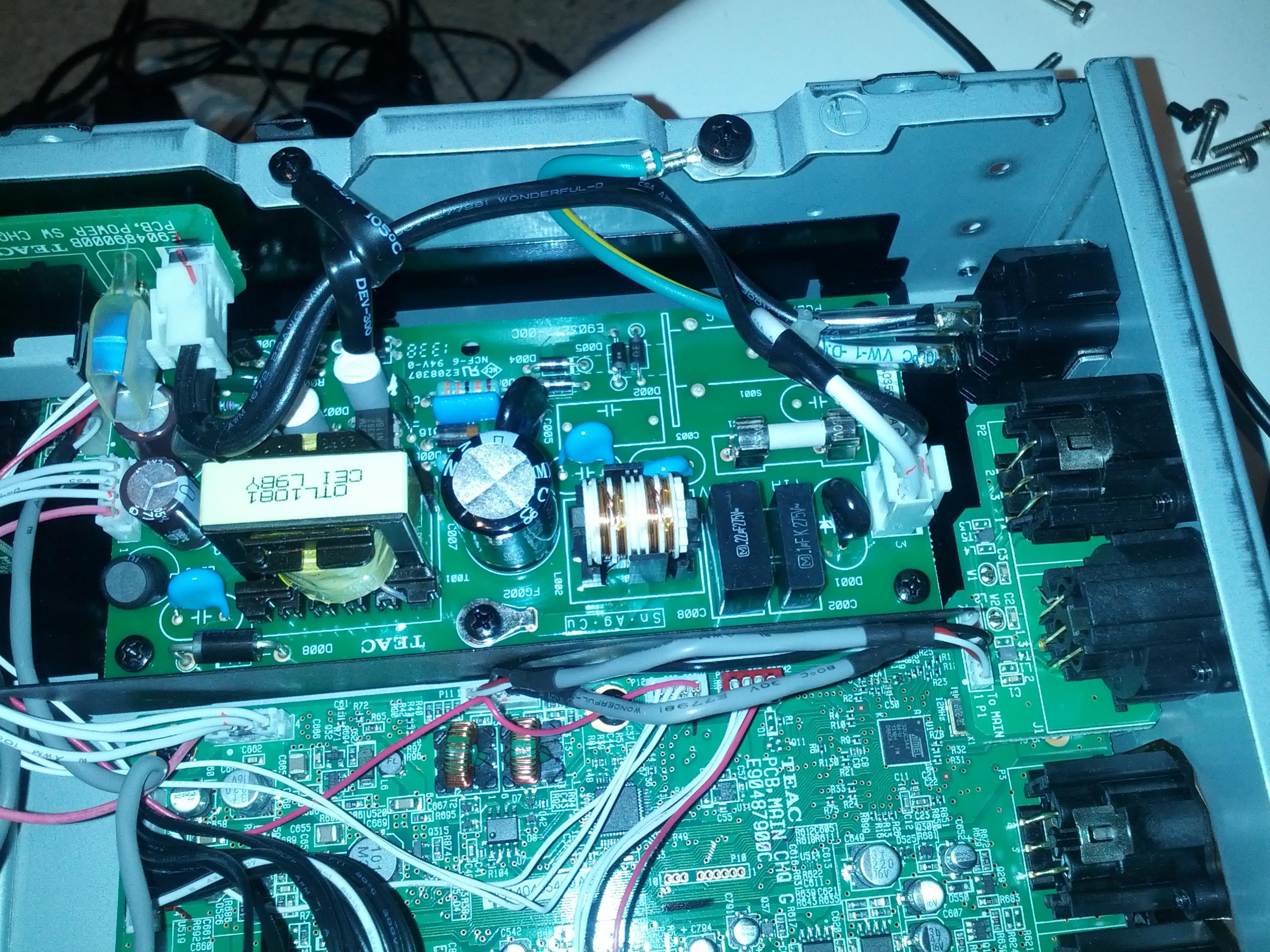

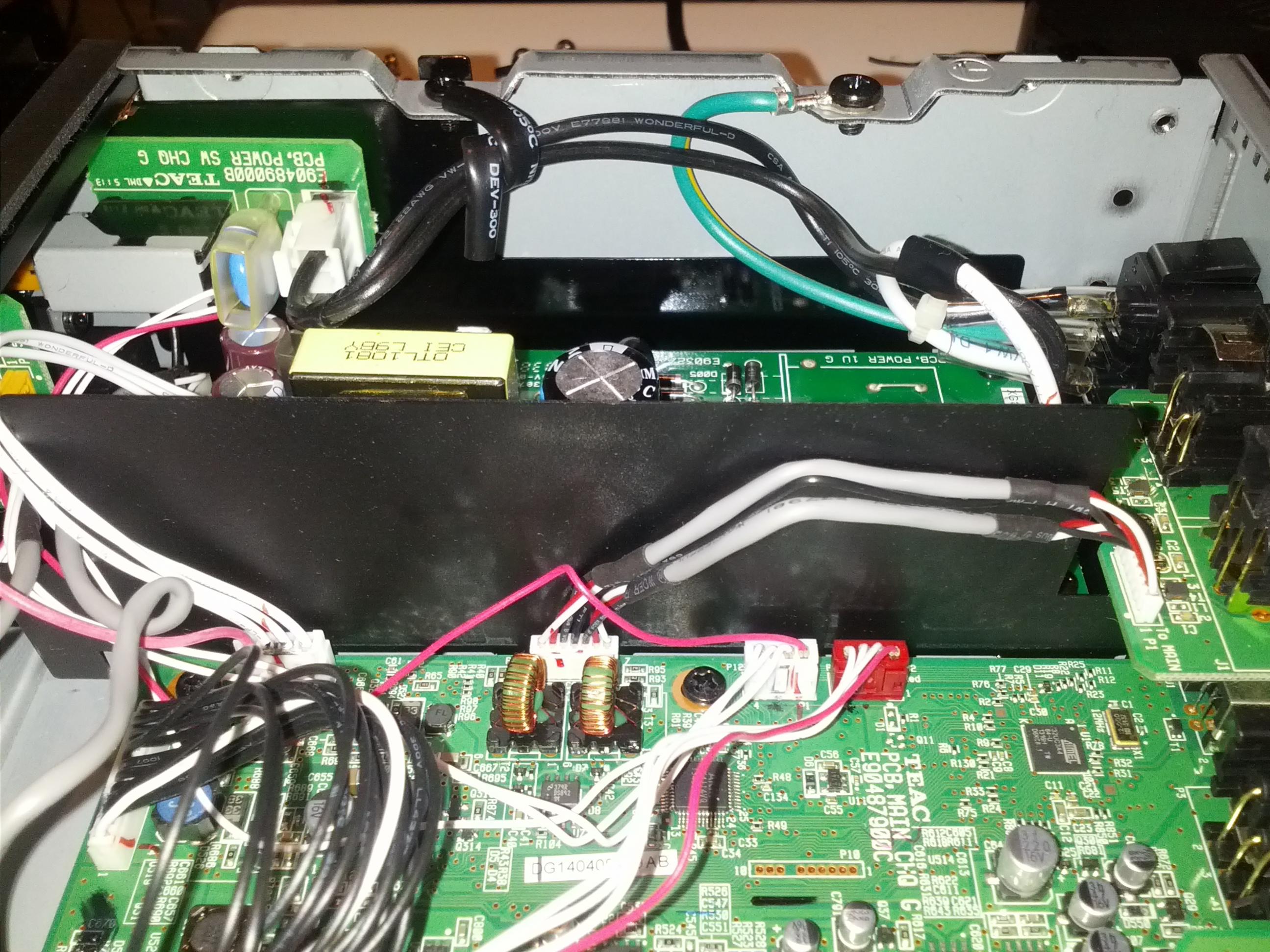

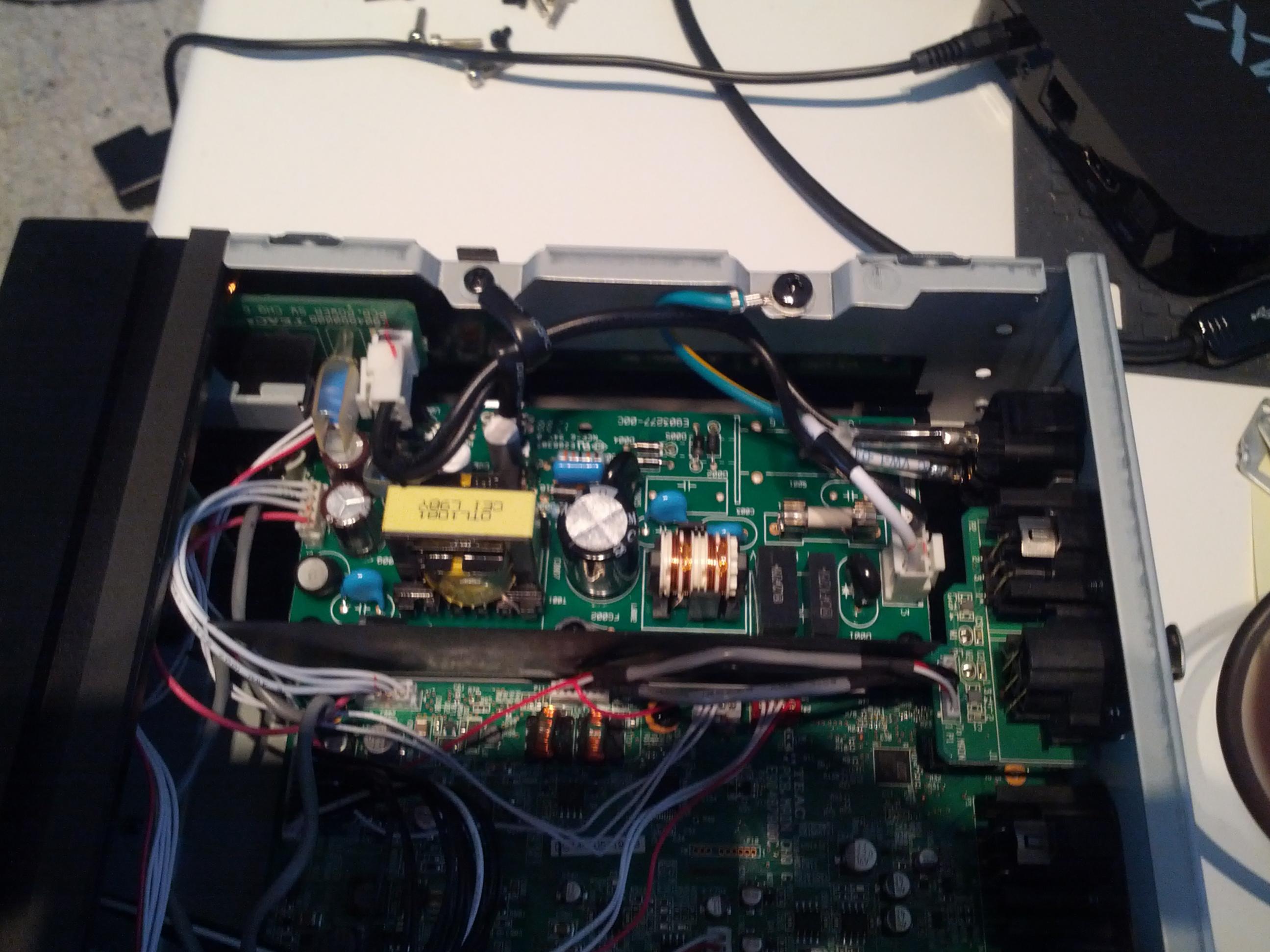

Hi ! thanks a lot for the very valuable advice and precious information.
The fact that a very very common solution is an external power adapter i guess it to avoid this challenge.
Nevertheless i know for sure that there are equipment with internal smps and fantastic figures of noise.
The troubleshooting on these units is really a task for expert people.
I see 220VAC input and a 400V cap
A very unelegant solution could be to place the Dell adapter inside in the place of the stock one ...
I cannot check precisely now (i am far from home) but it looks extremely similar to this one here (look at the price also ... )
Dell PSCV360104A 12VDC 3A AC Adapter 6mm Barrel with Centre Pin (1503FP) | eBay
I could just use some bi-adhesive industrial tape to stick it to the case, connect in and out and be done with that.
As i said the noise floor now is very much flatter than with the stock internal open smps (not shielded at all).
But first i will try the effect of some nice linear psu.
If the noise graph will not change i will go with the smps.
I see many choice here
http://www.ebay.co.uk/sch/i.html?_f...stpos=&gbr=1&_nkw=12VDC+3A+AC+Adapter&_sop=15
In this way i will use the unit as intended, with mains voltage
Thanks a lot again, gino
P.S. or something like this one here
http://www.ebay.com/itm/12Vdc-3A-ac...604854?hash=item3a8f9e13f6:g:6FgAAMXQeW5TXn1F
Why eek?I see 220VAC input and a 400V cap .
253Vac is equivalent to 357.8Vpk.
