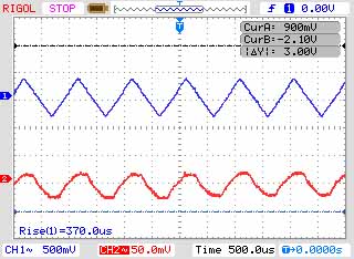

However, in a truly technical sense, a measure of a speaker's accuracy is its ability to reproduce a signal fed to it. Below is described a way to do just that.
If you take good quality signal generator and a dual trace oscilloscope and a good quality microphone you can hook up the sscilloscope in such a way as to track the input signal to the loudspeaker (from AMP) and the output signal from the microphone pointed at the speaker. With the generator's capability to input a variety of signals ranging from basic sine wave to triangle and square waves, you can challenge a speaker's ability to accuratly reproduce those signals whilst watching the results on your oscilloscope. Some of the best speaker designs can do a pretty good job. Most can't.

But the signal is electrical and what the speaker does in a room is acoustical
How can one tell that the acoustical event accurately reproduces the electrical signal? Aren't they incomparable?

Dunlavy speakers were very good at such tests IIRC. What goes in comes out - on an oscilloscope, yes. But only on a specific measurement axis and at a certain minimum distance.

Not so accurate vs. more accurate
One can tell by measuring with a known input signal.

In that case they are comparable, because you are simply looking for consistency in how closely the original signal and recorded signal appear on the oscilloscope.
But Your proposition relies on an assumption that the accuracy so understood is relevant at all ie. that how human hearing works somewhat resembles what an oscilloscope with a mic does.
We know human ears have a different sensitivity curve to that of a mic, but we are not measuring how the speaker sounds, rather how accurately it reproduces a signal based on a known input. In other words, we know the signal should look like the tone that was fed to the speaker, and any deviation from that value indicates less accuracy.

I don't think any product, let alone speakers, can be quantified with a single test and declared to be "good" or "bad". I would apply this test as a measure of consistency, but the final "tuning" of sound would be done by ear using actual music and not test tones.
