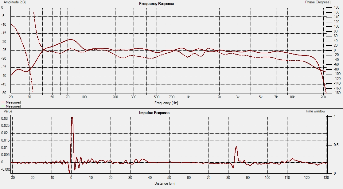

Using the same measurements in which I posted the frequency and step responses in Post #50, here are the corresponding phase responses. Red is digital XO with time alignment and Blue is passive XO:
Thanks Mitch! That does help me. So, it looks like there is considerable phase lag even in the time aligned version, which means not all frequencies are arriving at the same time. I'm not sure what to make of the step response you have posted. It looks good, but I need to go back and study what it really means. If all the frequencies were really arriving at the same time, your phase would be flat. Phase is just that: the relative time of arrival of one frequency compared to others. It would measure something like the attached.
I assume the phase plot shown is from a ~500 msec window. I think that it would look quite different gated to leave out the room.
Acourate only affects the early wave front at higher frequencies (length variable adjustable) as mentioned by Mitch. I think a phase plot of those first milliseconds would show the difference.
