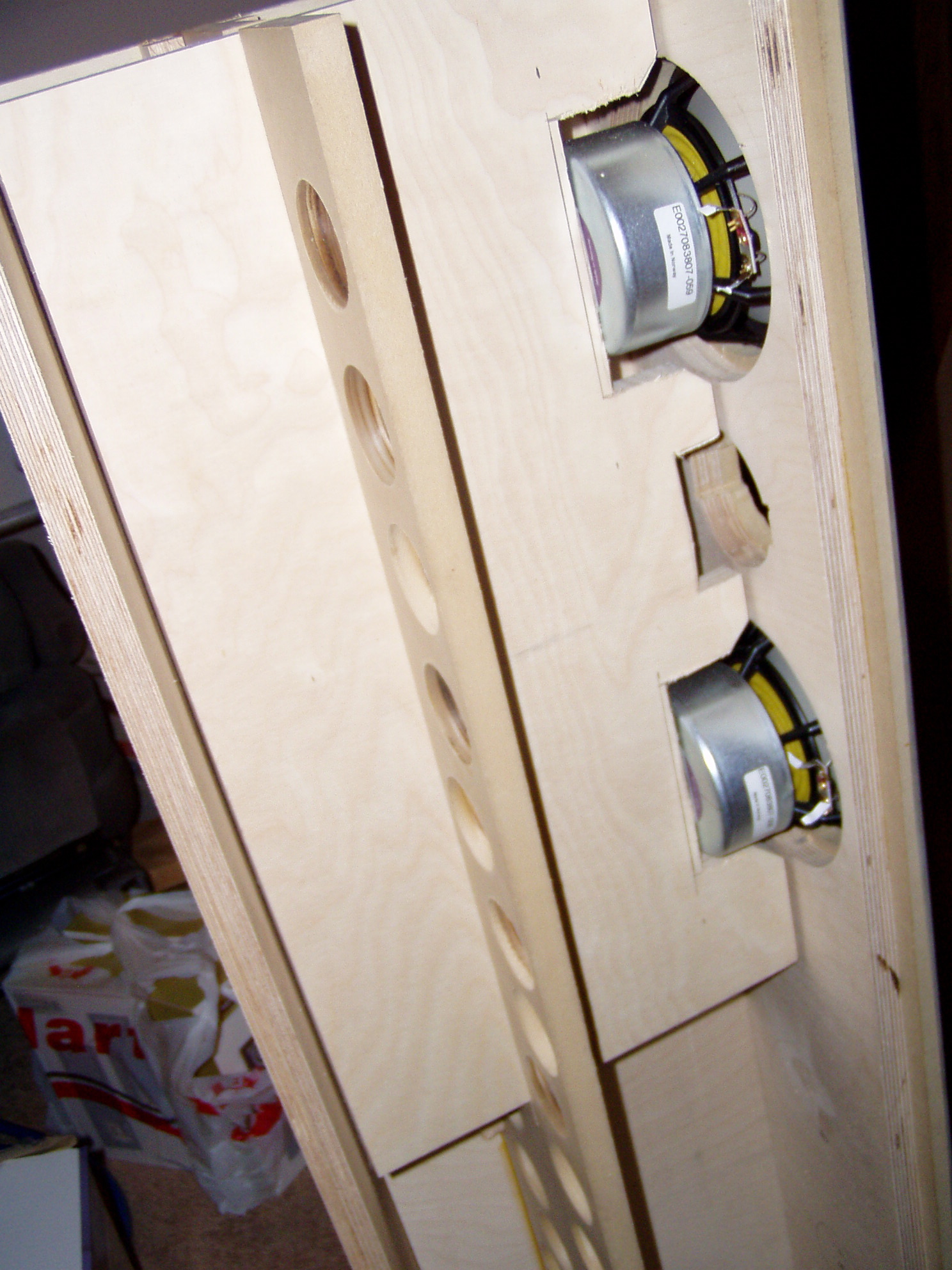

does the holey brace touch the tweeter
No
or just the woofers and does it touch just the back of the woofer or the basket and the back of the woofer.
Holey brace tight up against the backs of the woofer magnet... just enuff to tranfer energy to the brace, not enuff to stress the basket.

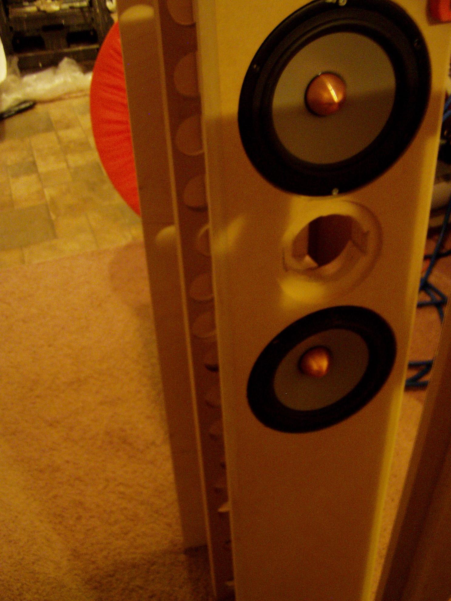

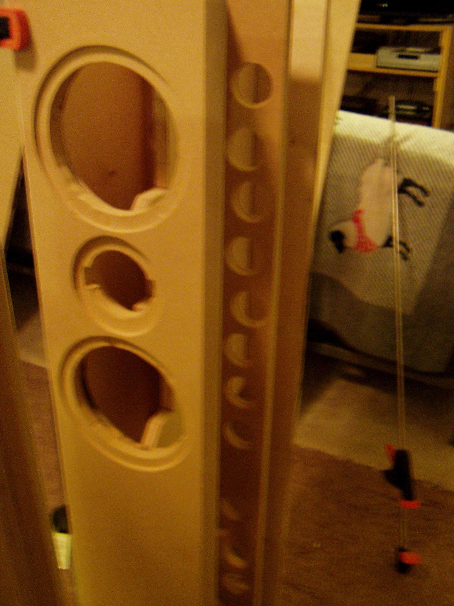

Here are a few pics.
The baffle needs some sanding but otherwise is done. I am still working on the fitment of the holey brace. then I will make it holey. the back is cut with the terminal cups cut out. I screwed up the measurements now I know how I got 30" I did not include the base so when I changed it to 30 3/4" I misplaced the drivers by 3/4" so my plan is to add a second 3/4" layer to the top and put in windows so the drivers will be the correct amount from the top of the speaker inside and out. the speaker overall will be 3/4" taller than spec. It will also let me put a larger chamfer on the top of the speaker. The wire is no its way. Other work is getting in the way right now so progress may stall for the next week or so. When you cut the pipe for the port I assume you measure from the front of the baffle?
Is there a recommended assembly order? Or just try to fit the assembly together and glue/clamp without the top and bottom.
I will have to paint the speakers in the spring. We have our first couple of inches of snow and I doubt very much that the weather will be warm enough to paint until at least April.
thanks
Ben

The larger bevel on the top won't make much difference, do it if you like the look.
The port length is measured from the front of the baffle to the rear of the port tube.
Additional height won't matter, I too doubled the tops of the speakers with holes drilled into the lower layer, helps keep them solid sounding. Tweeters should be near listening (ear) height.
Looking good, thanks for the pictures.
I built my boxes in this order, sides/ back/ baffle/ top/ bottom. What ever way works for you and is the easiest is the best. No set rules. Think what is the easiest way to line up the parts and go from there.
