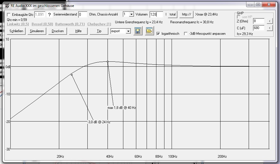

Okay, so I tested. WinISD Pro, this driver: Data-Bass
Compared to the simulations here: Simulating high inductance more accurately
Second driver.
WinISD Pro gives a curve that's similar to the uncorrected Hornresp curve*, and therefore not particularly close to what's measured. The corrected (Lossy Le enabled) Hornresp curve is bang on.
I urge you to try this for yourself.
* The difference is that Hornresp shows the response will drop over a couple of hundred Hz, while WinISD thinks it'll be flat to 50kHz.

Great, now go look at the MEASURED response in my second link.
On the Hornresp screenshot, the grey curve is the uncorrected reponse (same as WinISD, and your simulation), and the red curve is the Lossy Le corrected response.
Note the following:
- The uncorrected Hornresp simulation and the WinISD simulation are the same below 100Hz
- NEITHER OF THEM ARE EVEN A TINY BIT CLOSE TO WHAT'S ACTUALLY MEASURED.
- The measured response is actually very close to the Hornresp sim with Lossy Le enabled.

Ok, take a look at that sim you just posted and look at the one Chris linked to which includes the measurement. The measured and Hornresp simulated graphs have a 7 db hump at 35 hz (compared to 100 hz level). The sim you did shows a 2 db hump at 40 hz. How is that even remotely similar?
Let's understand that all these different programs are doing different calculations. The basic theory is the same but some include things like port end corrections while some don't.
Hornresp is capable of simulating lossy Le more accurately that WinISD and whatever program you used for your sim.
WinISD is capable of simulating losses, it can do at least 2 of these 3 - Ql, Qa and Qp. IIRC the box losses are set particularly high by default so if that isn't changed it can have an effect vaguely similar to lossy le. WinISD can also simulate le in the later versions if you check the checkbox but probably not particularly well. Why would Le even be an option that needs a checkbox anyway? It's a vital part of the sim.
Who knows what BassCAD is doing? If it doesn't even accept an Le parameter it can't be doing much right. Maybe it's simulating Ql, Qa and Qp, maybe not. Maybe it's doing other things. But clearly it is not producing an accurate sim.
