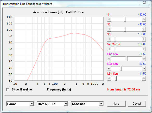

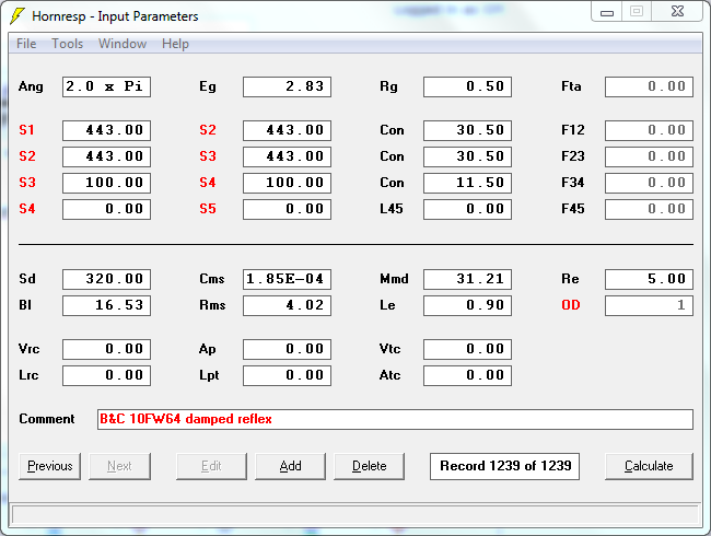

what would you build with a 10FW64 ? Could a folded T-line work well for it?
It has good specs for a MLTQWT, but for a baseline, here's a well damped ~28.2 L net where Vb = Vas, Fs = Fb reflex in 24" i.d. that may suffice, especially if near/at a corner:
