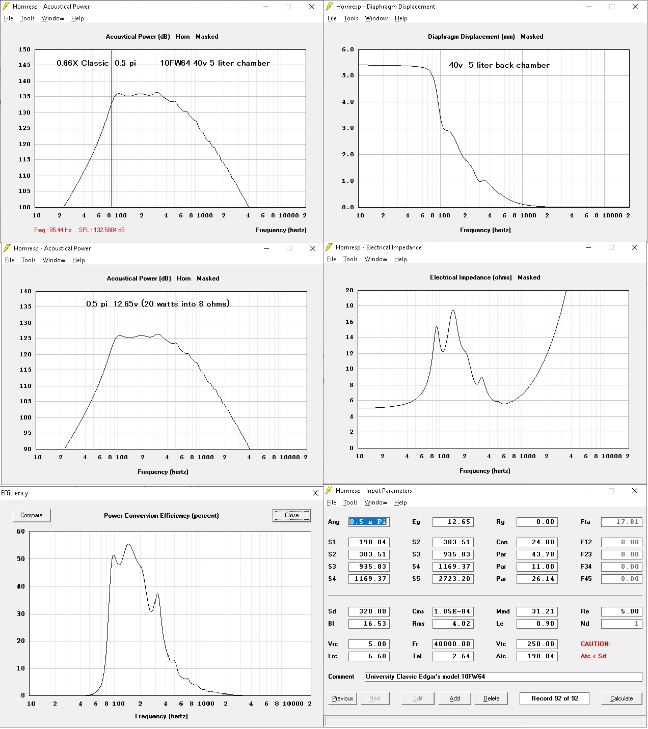

May I ask what’s causing the dip at 400hz ? Is it the design of the bin regardless of woofer used ? As suggested by GM, would adding the corner 45deg wedge at the corner when the horn turns 90 deg towards the exit help flatten the respond somewhat ?
Thank you
I don't think little reflectors would help. Those graphs are power response and the on-axis response will be rising vs the drop in power. I think the flat part of La Scala's path where there's no expansion is the cause of some shelving.

I used the "Edgar" sim from the Klipsch forums and not sure if the flat portion would be that long -?
Here's the model - I'll have to squint and look at it again

GM is better at this stuff than myself - but FWIW - here's 10FW64 in a 0.66 scale University Classic, sitting in a corner - it won't be real little nor go deep but probably would be pretty darn loud and clear
I reduced the back chamber in these sims down to a ridiculously low 5 liters so it would handle 40v in its passband without exceeding xmax - that's 135dB without taking in effects of compression.
in a corner, its 50% efficient
